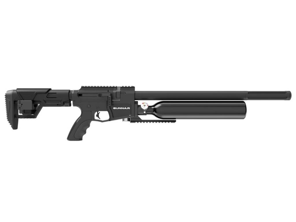

The Benjamin Gunnar is simply a rebranded Reximex NYX.
Smaller stuff might be different, but on a general whole.. Reximex NYX

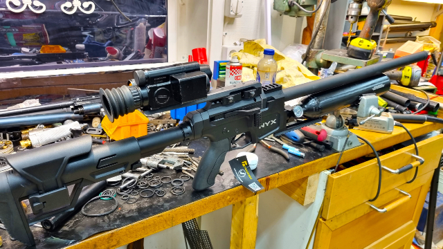

First up you need to get a feel for the unit and how it´s put together.
That does not by default mean that you have to rip the entire thing apart, it means that you need to get familiar with the basics.
Basics in this case for instance, how to get the rear stock off (which you do by unturning that massive castell nut at the base of it vs the main block).
There you´ll notice the plug for the hammer spring.
Other end of the block is where the regulator pressure is adjusted.

First tip is simple as pie and very very easy to handle.
The stock plug for the hammerspring, that thing needs a hole and a thread to make the thing adjustable. I opted for M8 (if memory serves) and i used an allen stop screw on said dimension where i made like a "shelf" on it out front to fit/center a washer. This rather large washer is in turn what acts vs the spring, not the screw in itself. I of course did this on a lathe but it can just as well be done rather crude using a file or a die or bench grinder.
Presto, adjustable hammer spring pressure.
So. Use an as long such M8 stoppie as you can get a hold of (if in the US feel free to go 5/16 thread, might be an idea to make that UNF even). Then.. turn it in and keep doing until the gun won´t cock. Back off 1 to 1,5 turns and put the unit over the chrono. You should see a marked difference in pellet speed.
Stock spring is rather meek and can sure (should) be replaced by any generic spring that hands more power/force. Pick your poison.
It being a side lever brings it´ll take quite a bit of spring need be without turning "Godzilla" to cock the unit.
Next up to be honest is porting the unit. When doing so keep the old "truth" at the back of you head, that you should never even give thought to going larger than caliber for regulated guns. Fact is, for starters keep it at like 5mm for a 22 and 5,5mm for a 25. Mind you, this then my OPINION and in essence mainly said to keep you on the safe side.
Porting is done using regular drill bits.
One absolutely imperative part to that though is that ALL holes affected by the drill bit HAS to be deburred when done. Any burrs left will eat o-rings alive in a heartbeat.
One caveat here is the power adjuster. The entire flow path of course needs to be ported, and Kral n Rex typical power adjuster can come to present an issue as those need to be drilled through together with the rest of the flow path.
When you do make sure the o-rings on the power adjuster are removed. The power adjuster, its clicks, is cotrolled by a small spring n ball bearing. These come to the letter rushing as you let go of the small allen stop screw that comes in from the front of the block to be able to remove the adjuster. Be aware of this so you won´t have to spend 3hrs on your knees finding that small ball and spring.
On my particular one there i went up in size on the adjuster and made the hole for it 10mm flat by use of a reamer. This as i ported it as large as i did and wanted to regain resolution on the dial. Thus i of course turned new inserts for the adjuster on the lathe to boot. But for lesser degrees of porting the stock thing will suffice just fine.
That should get you going at least. For reg pressure this both can and should be raised together with more intense hammerspring (as any other PCP really) and i´d wager that sans an external plenum that thing of yours when the above is done and done right will come to a rest around 170bar and approx 70J using either generic 25,4´s in 22 or 33,95´s in 25. The latter with the upper hand power wise.
