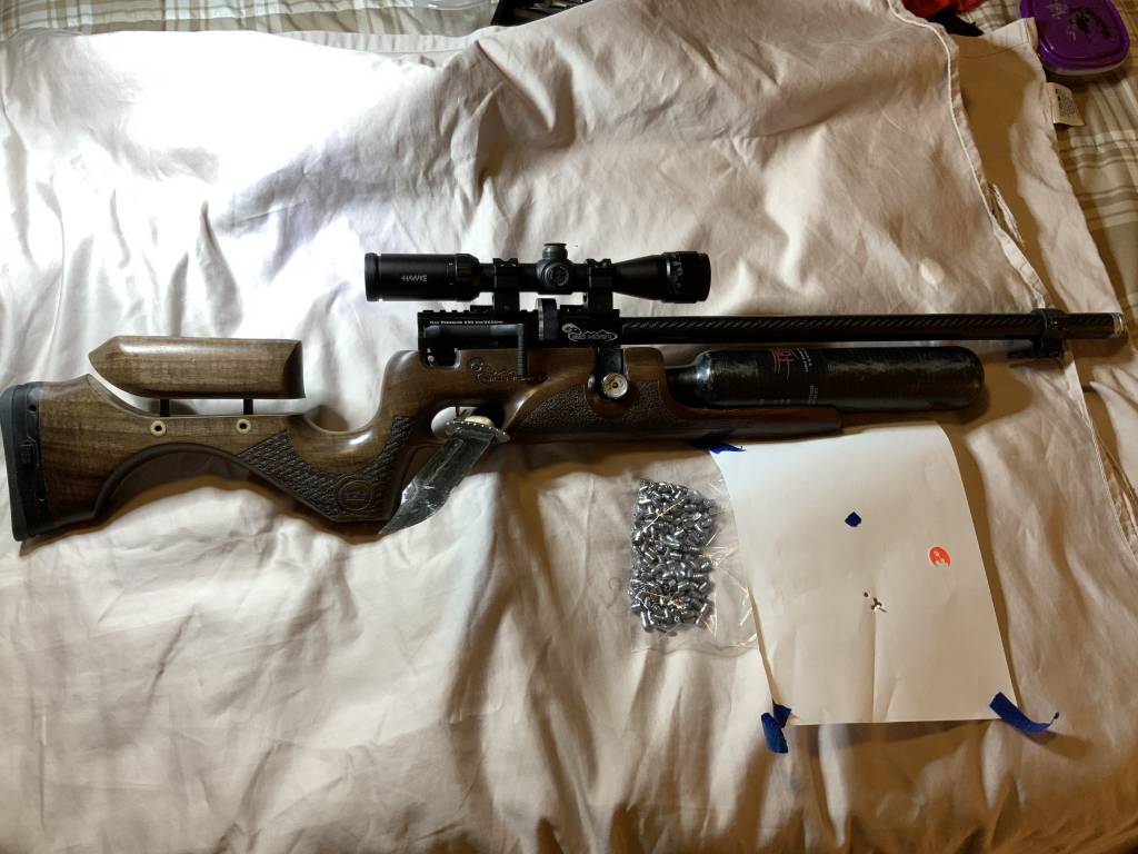

I have put cf tanks on my Kratos and Bighorn. The Kratos and Bighorn required removing some wood from the forearm, other than that it was a simple degas and exchange and the bottles removed easily.
The Gunnar should be easier because it does not have a forearm to restrict space. So it should be a degas and R and R. I have used the Kratos with a regulator at times, you need to pay attention unscrewing the bottle so that you do not turn the other joints, ie the regulator.
Once you remove the metal tank, hold each bottle in your hands to compare the weight, you will find the difference enlightening, in more ways than one.

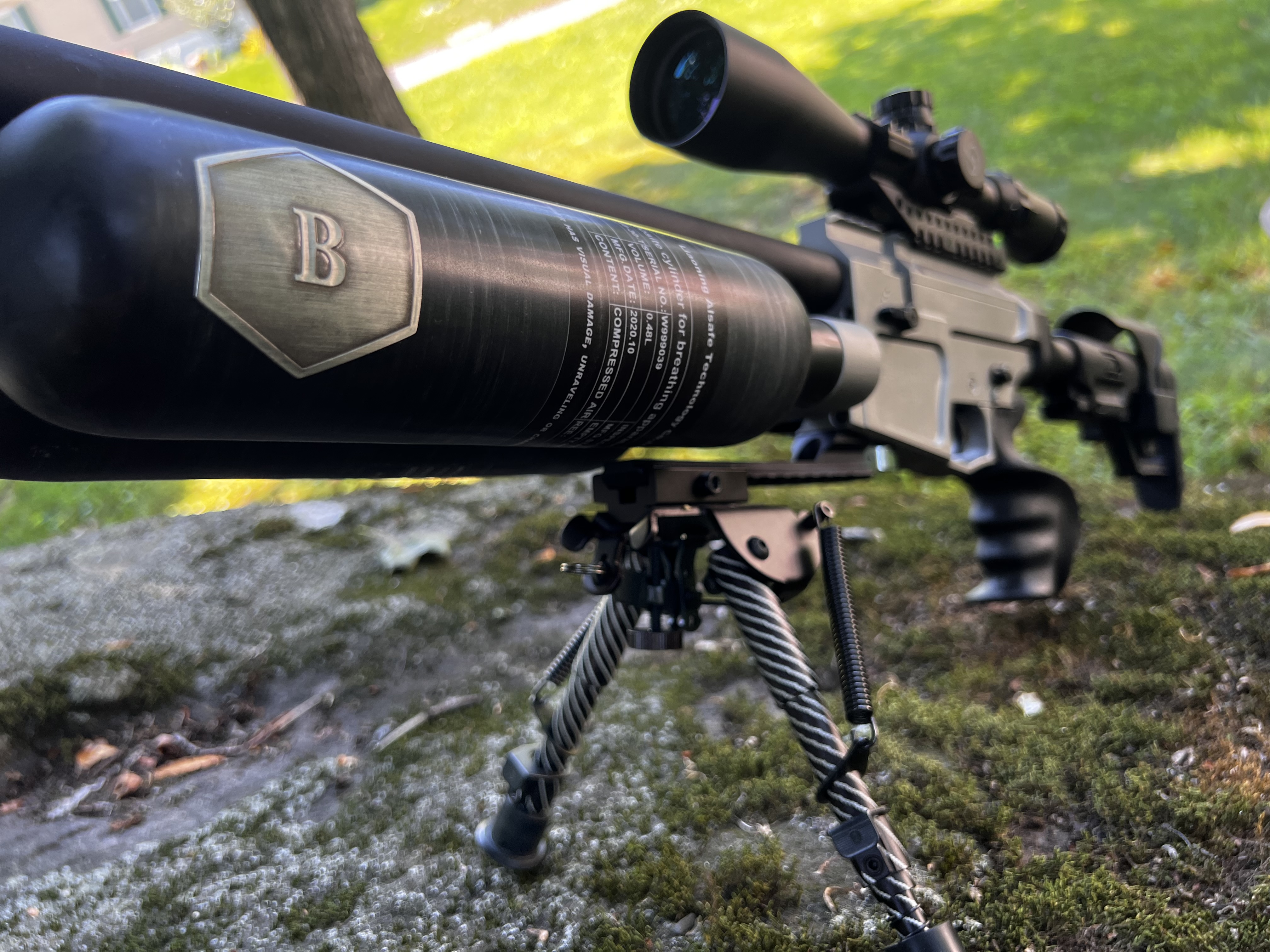

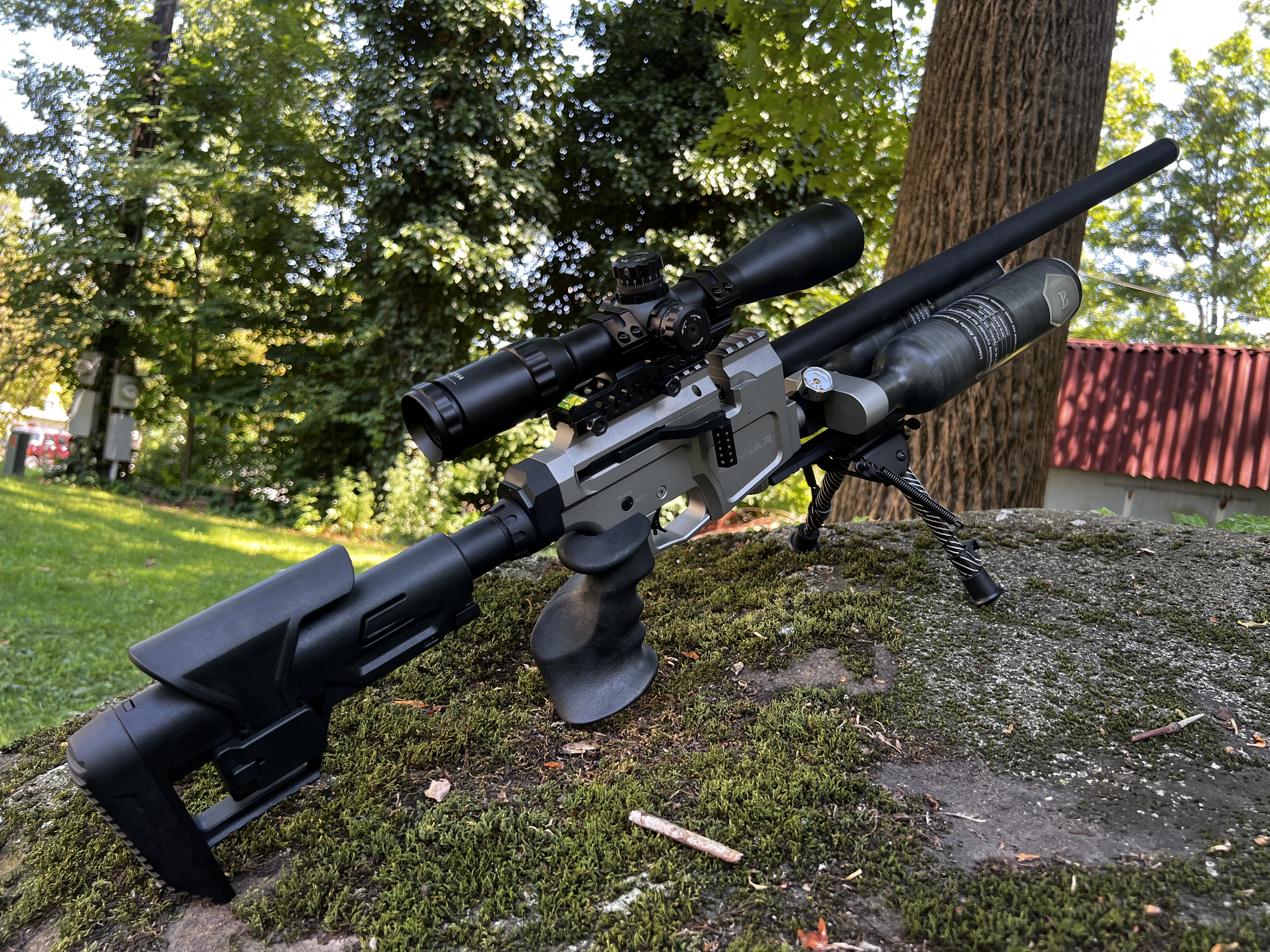

That's a cool looking setup you have! I put a CF tank on a BigHorn I had and it worked well.. It wasn't regulated though. Do you go above 3000 psi or just get more shots? Or both?
