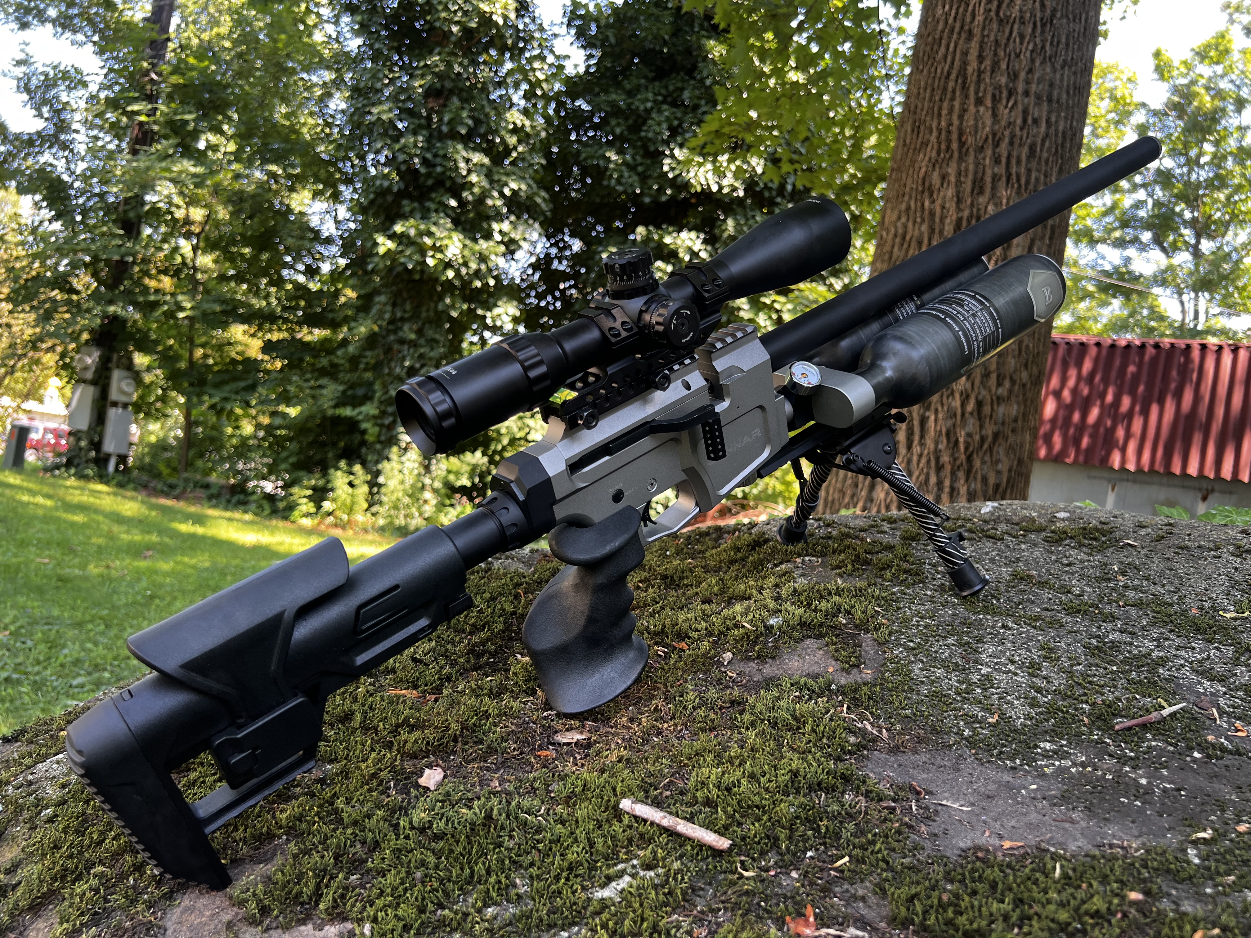

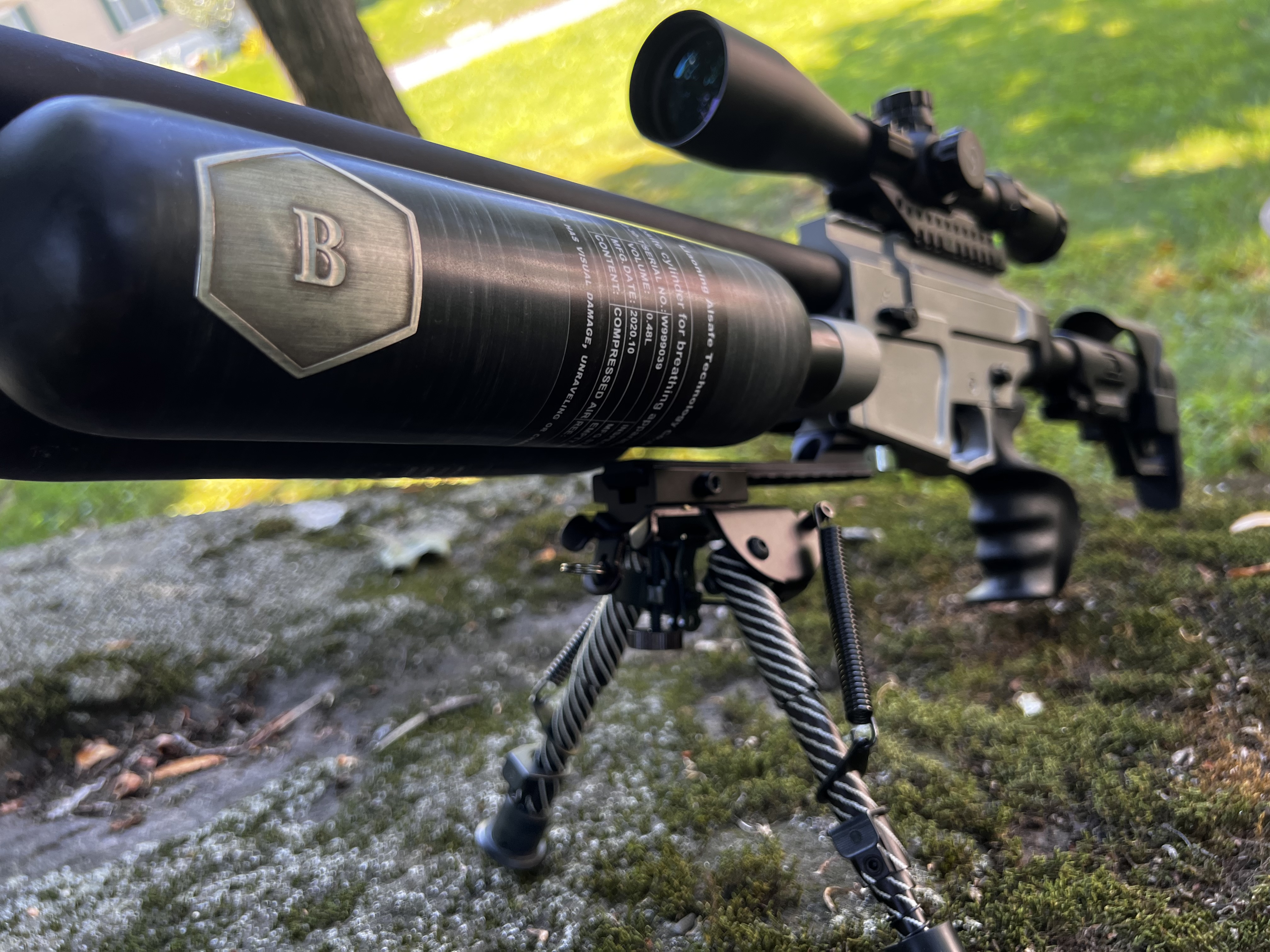

I'am trying to mount one CF bottle to my Gunnar with a Reg of 45000 psi down to 2200psi but can seem to find an adaptor to make it work, my Reg is G 1/2-14 male . I can thread the bottle to the gun with out the Reg but then can only fill to 3000 psi any info where i could find the tread adaptor would be great.. love your duel setup did you fabricate that or buy adaptor?
I just reused the stock regulator and valve that came out of the aluminum bottle. Works great.I'am trying to mount one CF bottle to my Gunnar with a Reg of 45000 psi down to 2200psi but can seem to find an adaptor to make it work, my Reg is G 1/2-14 male . I can thread the bottle to the gun with out the Reg but then can only fill to 3000 psi any info where i could find the tread adaptor would be great.. love your duel setup did you fabricate that or buy adaptor?
Yes I was under the false assumption that I had to use another regulator for the 4500 psi. Thanks I now have just switched the stock 500 cc tank out for 700cc cf Tank and fill to 4500 psi and reg set at 2100 . I’m getting 220 shoots before dropping to 2100 . Also I had to upgrade my pump freezer m shoe box pump to Gx cs4i Fills faster.I just reused the stock regulator and valve that came out of the aluminum bottle. Works great.
