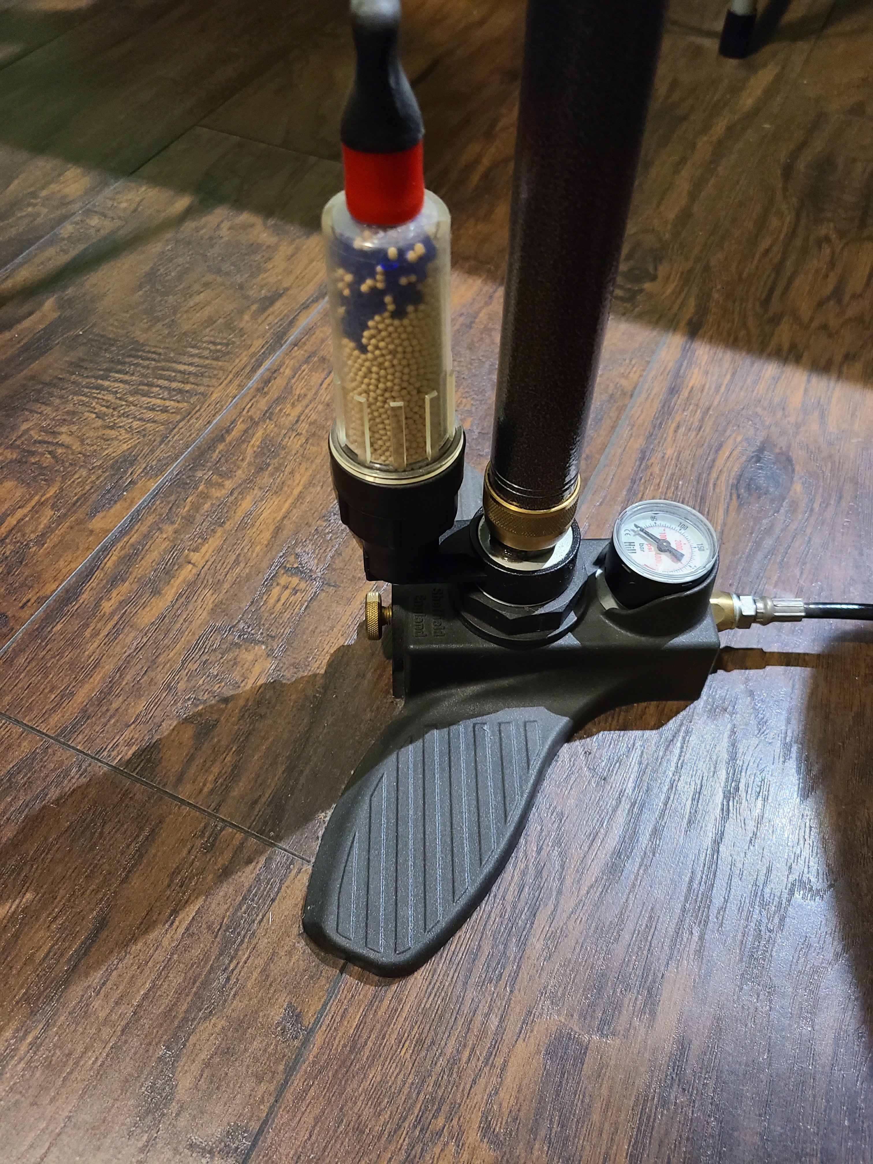

To get started I took the Hill Pump out of my closet. Other than dusting it off, I didn’t do any prep work. I am not 100% sure that this is my Hill Pump (since I bought it in 2009), but it looks similar enough.
One thing I noticed right away was the canister (holds dry-pac) was loose. I wasn’t sure if this was a problem or normal. I just made sure that the air hole on it lined up with the air hole on the pump. I bring this up in case someone has some pointers on Hill Pump maintenance. Please. I have never replaced the dry-pac and really have no idea if I should. After all, this pump was purchased in 2009.

BTW, any idea on the Hill Pump canister connector? re: “One thing I noticed right away was the canister (holds dry-pac) was loose. I wasn’t sure if this was a problem or normal. I just made sure that the air hole on it lined up with the air hole on the pump.” I am wondering if I am making pumping much harder than it should be …?
The clear canister that holds the dry-pac screws onto the black base and may just be lose. Is that what your referring to? The black base has 2 o-rings and may be dried out. And for media, I would toss that out. I can't imagine it's still good. Get yourself a container of molecular sieve and repack it and save the rest in Manson jars vacuum sealed.

The clear canister that holds the dry-pac screws onto the black base and may just be lose. Is that what you’re referring to? The black base has 2 o-rings and may be dried out. And for media, I would toss that out. I can't imagine it's still good. Get yourself a container of molecular sieve and repack it and save the rest in Manson jars vacuum sealed.

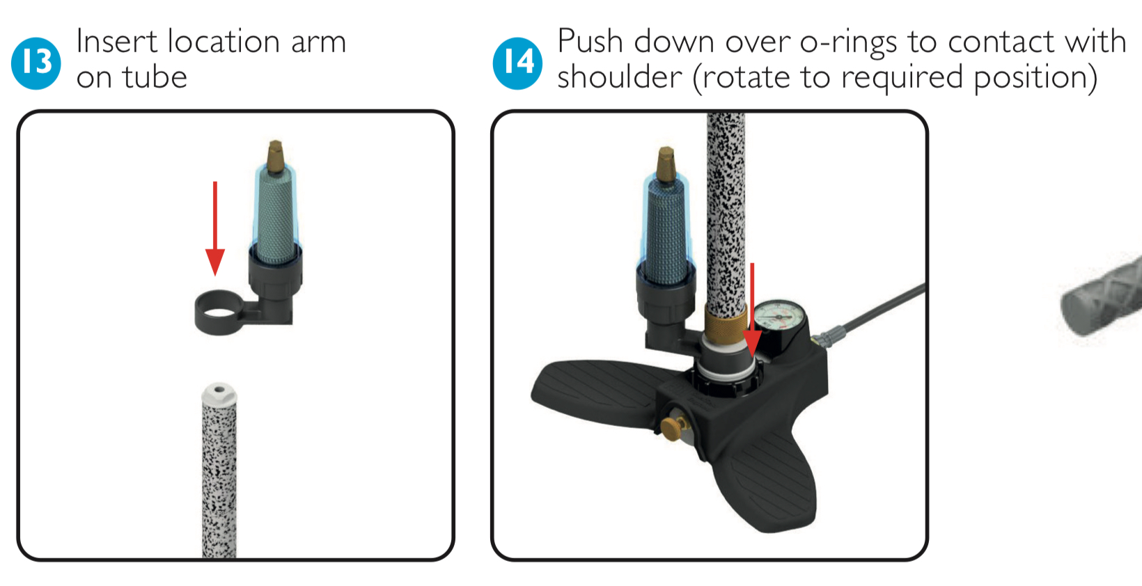

Thanks for the help/info - it is the part shown in #13 in the image. The interesting part is to “rotate to required position” - I thought maybe the canister holder assembly should always be static, but I guess not. And now I have no idea if the o-rings should be replaced, since the pump seemed to work fine.

That part doesn't matter where it's indexed, I have mine in the 6 o'clock position to keep it away from my toes. It should rotate with resistance. Parts can be had from Hill, PA etc. If needed. The dry-pac media should be replaced every 3 months, so just get yourself jug of molecular sieve and have a lifetime supply.
OK, thanks for the info. I find this interesting because I thought the canister had a hole that needed to line up to the pump. But I haven’t experimented.
You are also the 2nd or 3rd person that mentioned replacing the dry-pac. I think I will do that in the near future, maybe as part of a pellet order.
It's doesn't need to lined up, the body on the pump is machined with a relief like a banjo bolt on a motorcycle brake line. Just position it so it's not in your way.
Thanks. Learn something new daily. LOL
I don’t see it on the Hill reference PDF. Replacing the dry-pac seems straight forward. If I need to o-rings (reference on my screen shot above, as #14), where do I get them? I looked on the hillpump site, but didn’t find anything that looked like my hand pump.
I haven't crossed that bridge yet. The filter is a add on so you may need to drop Hill an email. Also, if it fits snug and has resistance when rotating, you don't need to bother.
