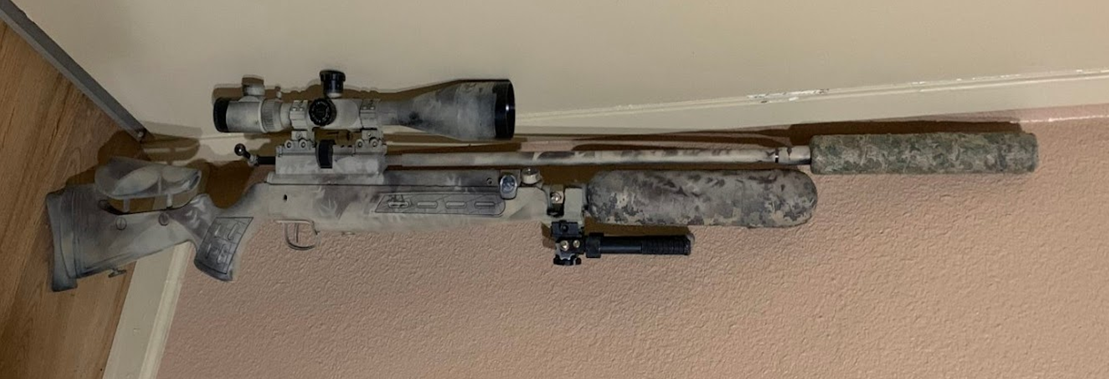

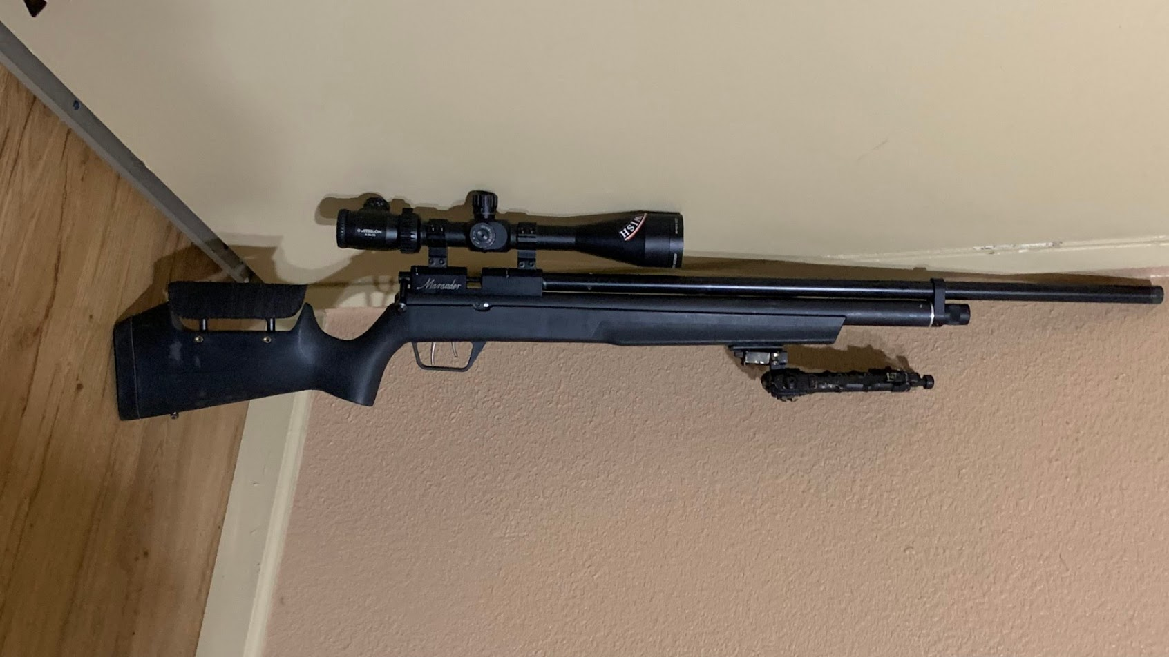

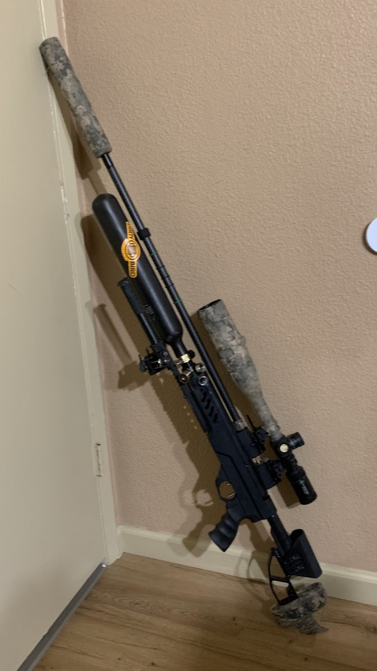

What you will see from a good M-Rod, mostly stock, is about 44 fpe at 890 fps with the 25.4 pellets. The Gen 1 in the photo, .161 porting, AGR free flight no bounce hammer will do 24 shots on a Bell curve averaging about 44 fpe. The side lever M-Rod on the bottom, GM barrel, Houma regulated, JSAR internals makes 60 fpe for 16+ shots with JSB 34s, 890 to 900 fps.
