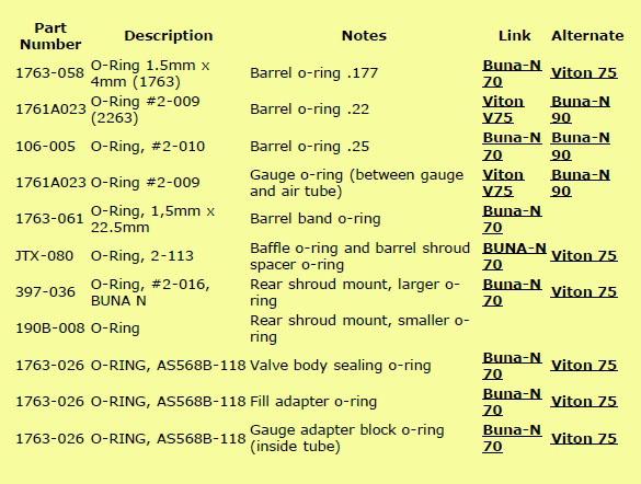

Does anyone know the size of the oring between the air tube and gauge I looked on the crosman site but just gives a number not the size. Thanks Terry
That yellow background gives away its origin. I have the same screenshot, from a long time ago.Here you go:
