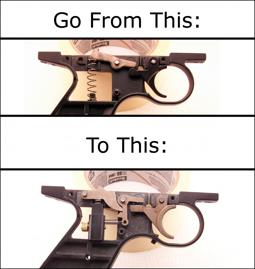

My buddy's p-rod had a trigger assembly that looked like it was out of a 2240. New lighter spring and a super sear from AOA and it was a lot better. The trigger assy on my gun is the lower half of the pic
The P-ROD trigger assembly (2220-035) should look like the lower picture, not the top picture. Your buddy's P-rod had the wrong trigger. The 2220-103 drop sear works a lot better than the other.
