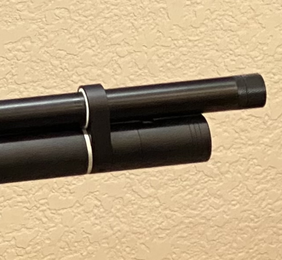

I am new to pcp rifles.Old to shooting.I have two 22 cal Marauders[only needed one].One is 2019 syn with crosman barrel the other a 2022 wood with LW barrel both unregulated.The marauder has many reasons for poi shift.I will discuss one that I have made better and one that I am working on.If my info is old news remember I am old to
K taking off shroud and shooting both rifles at at spot [one at a time] at around 30 yds-no wind-on bench.Pretty much one hole group.Put shroud on snug and shoot again at same target.Yea diff poi.Now adjust shroud by shimming.Both of mine shot lower[2 inch to 3 inch] with shroud on.For test purposes I simply put layers of tape on the bottom of the barrel band until it shot into same hole as when the shroud was off and the group was first made.If conditions stay about the same[TEMP] POI is way more consistent day to day then before.Now I am working on temp change effects on POI. Rifles are inside[72] shooting from inside garage[40] Both rifles seem to change poi since it has got colder outside.When I figure something out I will post again.Mabe some of you more seasoned pcp men can enlighten me before I go through several thousand rds more.Oh yea that is the fun of it!
