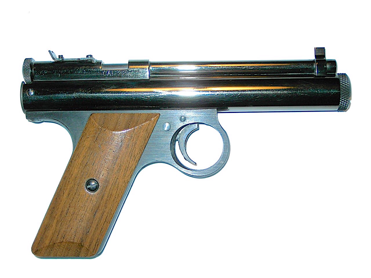

The Benjamin Model 250 .177 caliber pistol was introduced in 1952, the “first” CO2 pistol in the Benjamin Air Rifle Company’s line up. It was named the “Benjamin Super CO2 Pistol”. (Picked this unit up at a Gun Show in 1983.)
It was a smooth bore and shot .177 caliber pellets, Darts or B-B, weighed about 2 lbs and utilized the 8 gram. CO2 cartridges (No. 2500) as Benjamin advertised them; came with wood grips, accuracy was stated as 1-2 inches @ 5 to 10 yards . No velocity figures were given in the ads.
The rear sight is an adjustable leaf type, a simple set screw can be used for elevation and the hold down attachment screw loosened for lateral adjustments. The safety is a push type trigger block mounted on the frame.

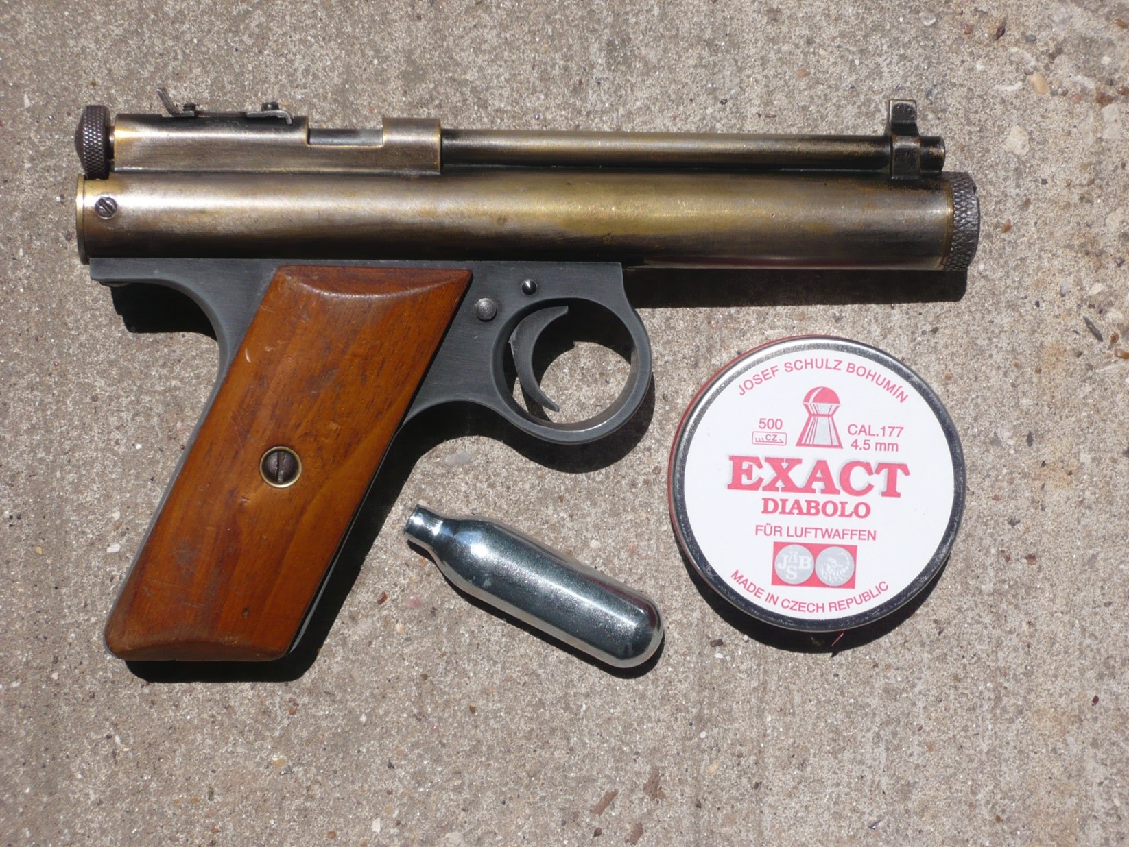

Charging the pistol with CO2 required removal of the slotted (o-ringed) knurled muzzle plug then drop in a 8 gram cartridge small neck first, reinstall the muzzle plug and tighten snugly by hand only, rotate the cocking bolt to clear the breech cap, pull back the bolt to cock the pistol and return the bolt to lock position , pull the trigger (pistol pointed down range) and the striker will then pierce the cartridge and charge the pistol with CO2. (*make sure the pistol has no ammo in the barrel before this step is taken.)

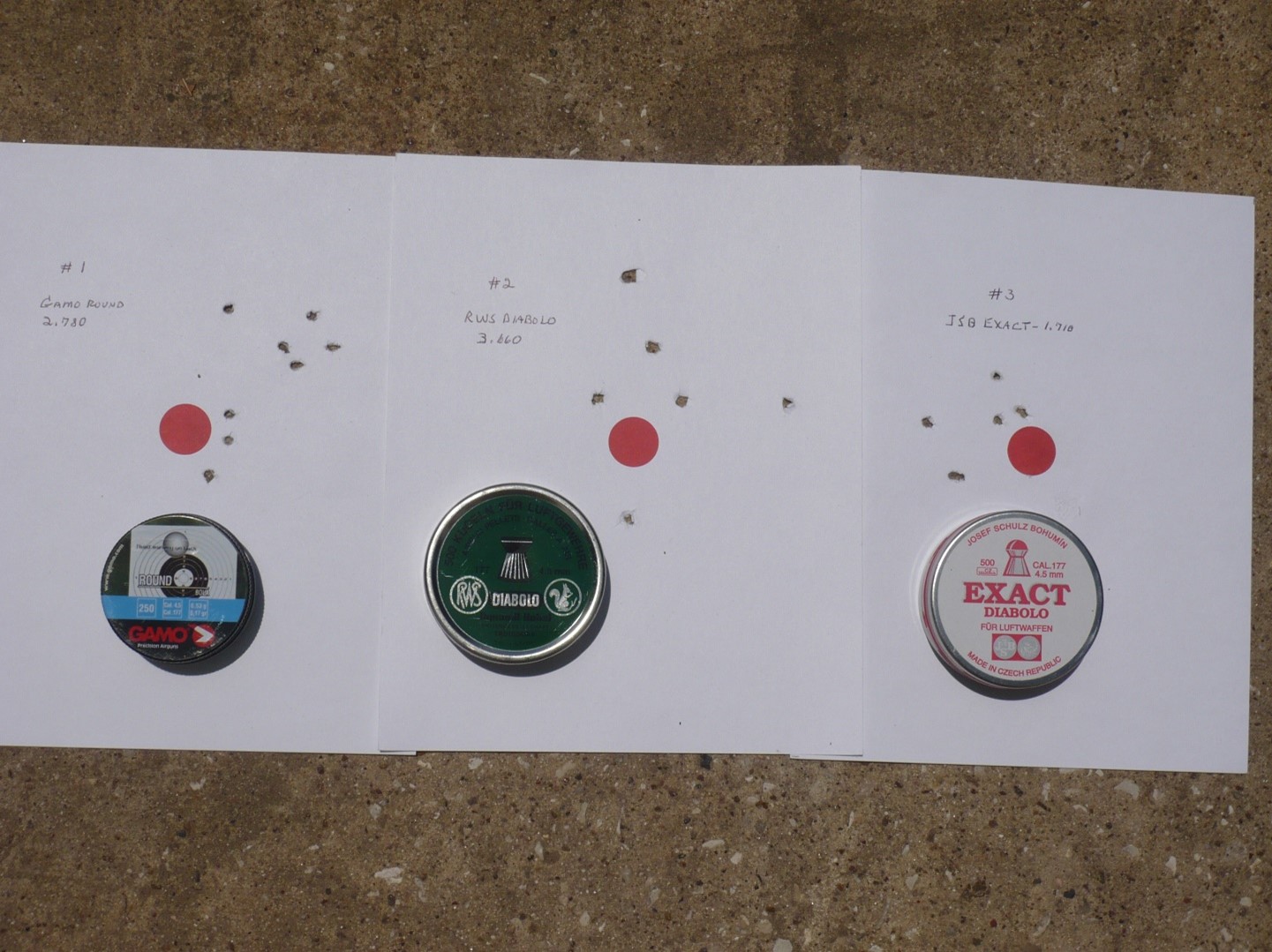

Accuracy test was conducted @10 yards from a bench rest. It was clear that the B-250 was going to be relegated to mostly plinking status from the performance exhibited on the targets. I normally use one 8.5x11 cardstock paper with three ½ inch adhesive dots evenly spaced across the center for accuracy testing, not going to work with the B-250 pistol, too much shot dispersion!! I set up three separate targets for the B-250.
Accuracy test #1 utilized the Gamo round lead shot (8.17grains.) eight shots measured 2.87”, test # 2 utilized RWS Diablo pellets (7.9 grains.) 6 shots measured 3.660”, test # 3 utilized JSB Exacts (8.4 grains.) 5 shots measured 1.710”. The B-250 is a designated plinking pistol for sure! The JSB pellets did offer some degree of accuracy and would be the obvious choice for this pistol!
