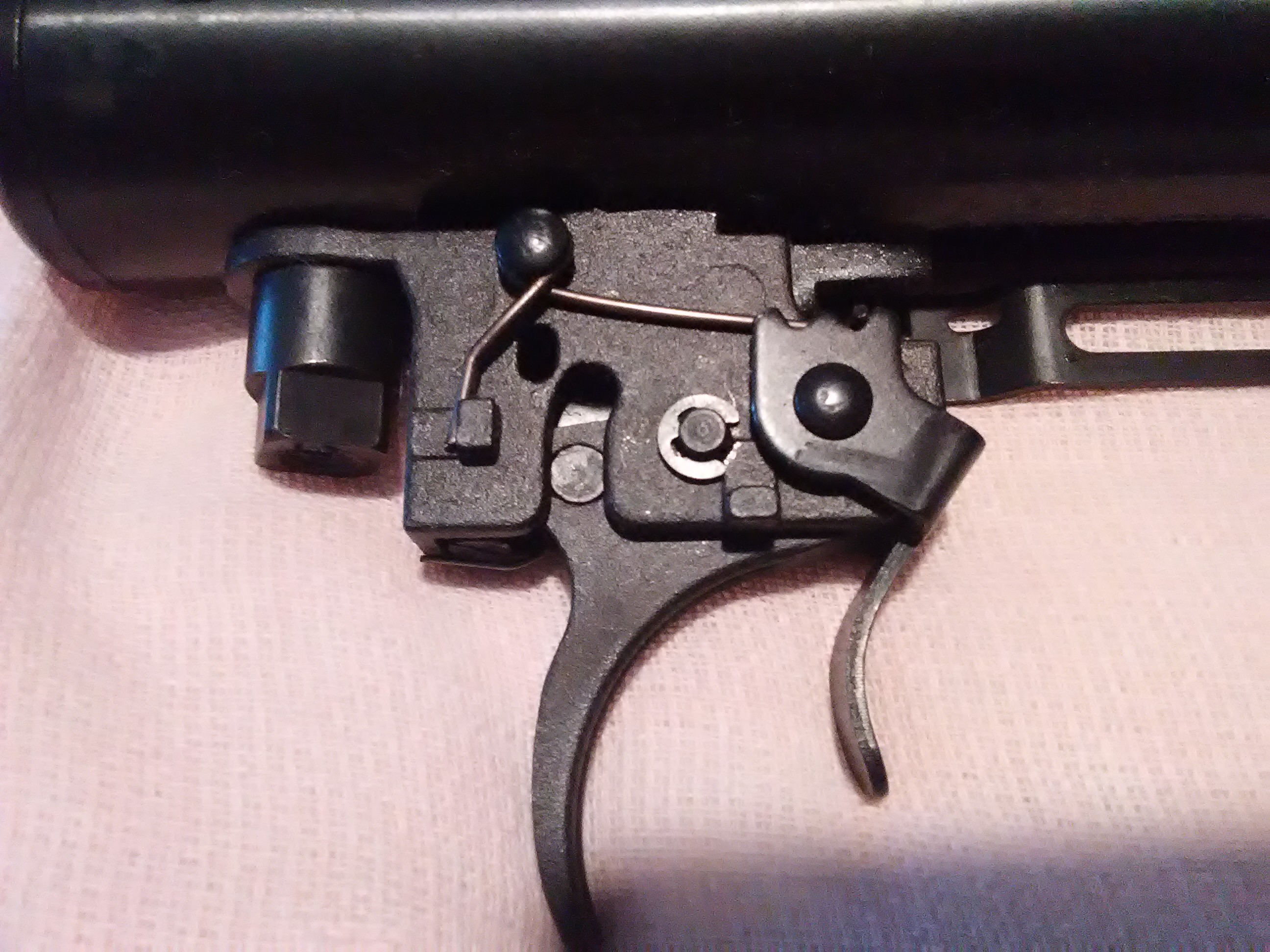

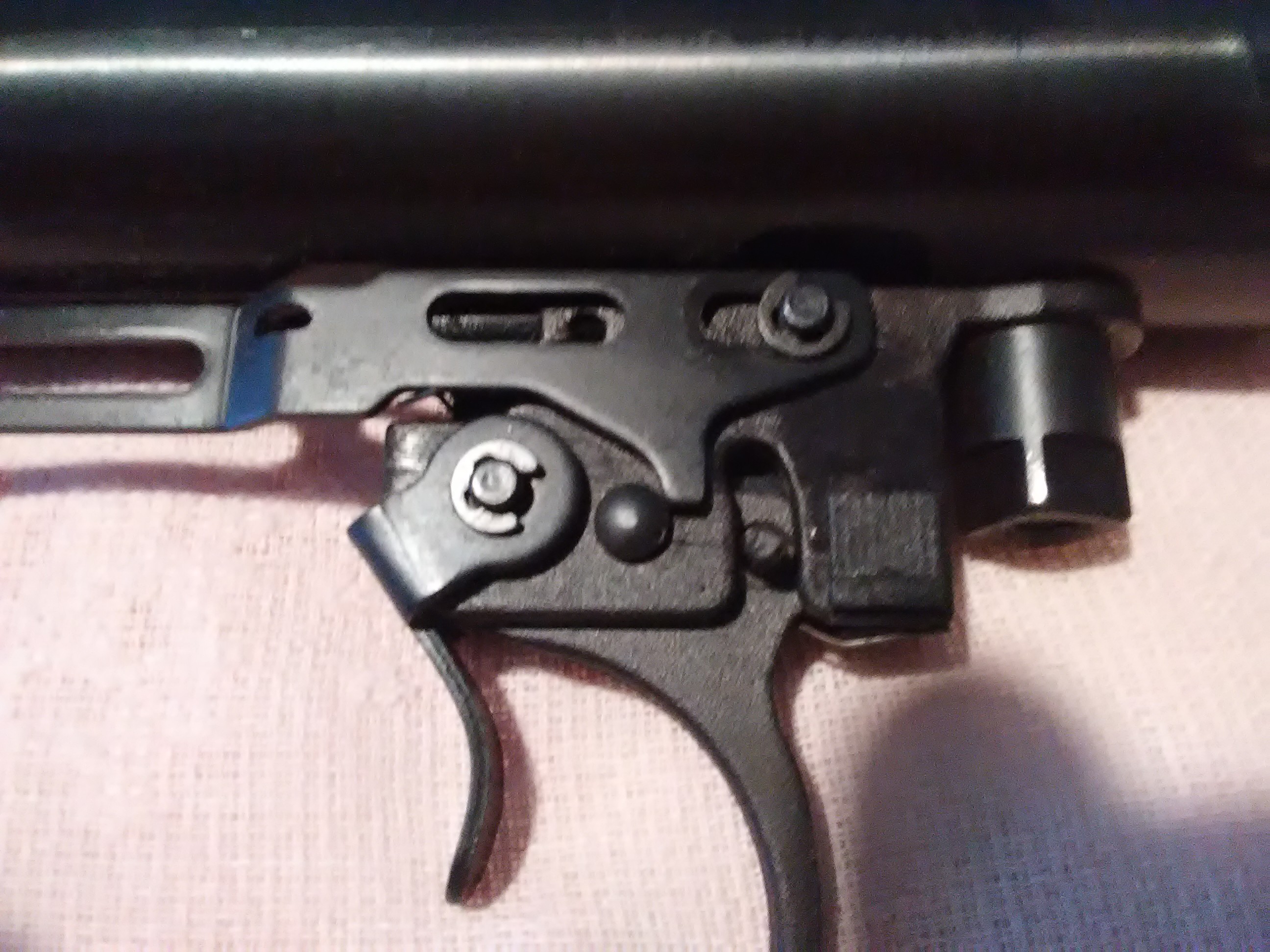

Yeah, I almost passed out holding my breath, squeezing the trigger, waiting for gun to go off. The YouTube fix I used was the radio-controlled racing car wheel bearing Traxxas 5114 5x8 MR85-2RS sold on Amazon, brand TRB RC, (www.trbrc.com). Lost that "lawyer" spring, too. Made a world of difference, Charley de Tuna makes a replacement trigger that accomplishes the same. WM

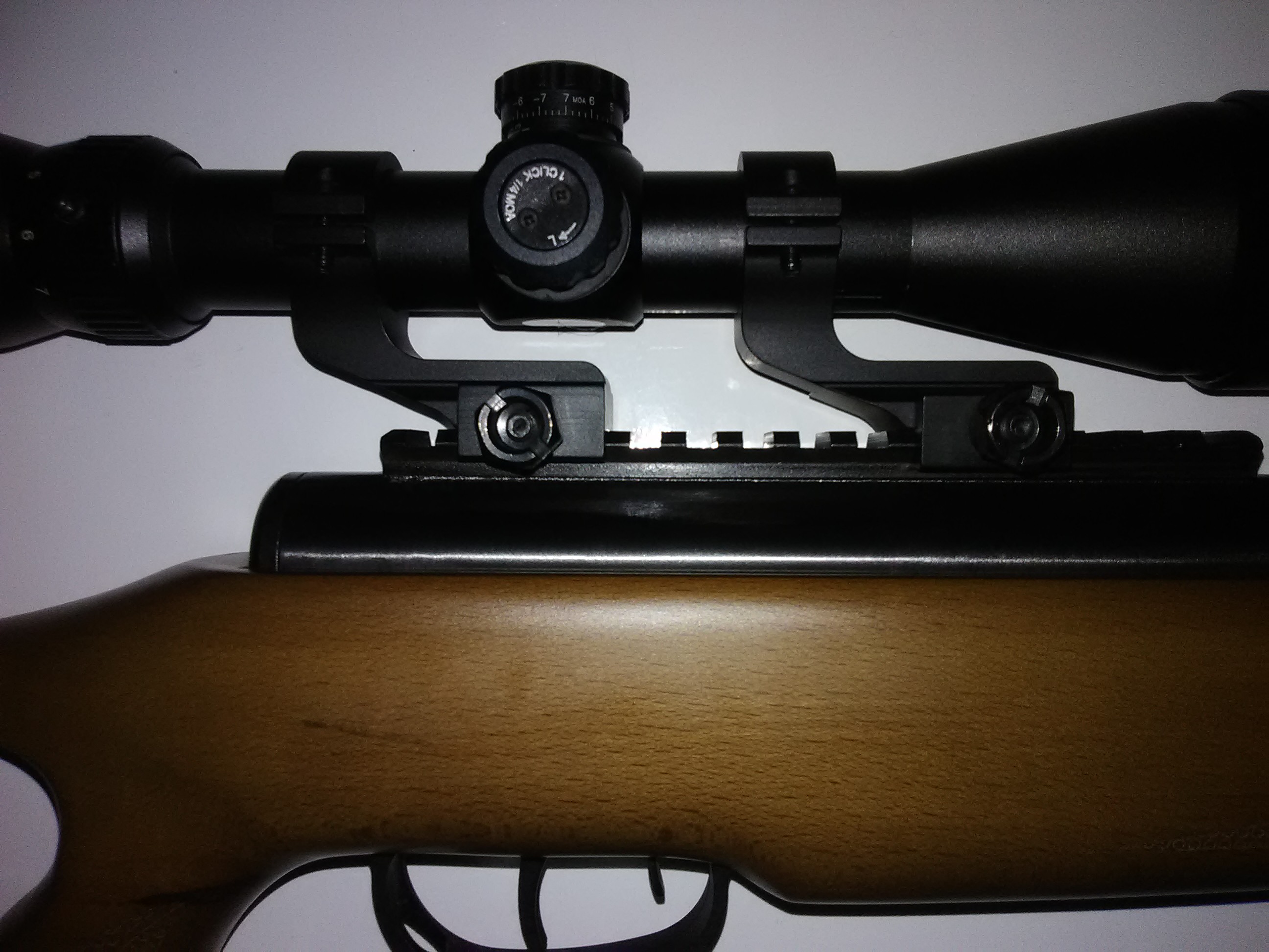

Here's a scope ring (Monstrum) set I used for more eye relief, didn't want to trim wooden stock, so went this route. WM
Some pics of trigger mechanisms before work, always good idea, IMHO. Didn't find modifications very hard, just make sure not to lose "C" clip. The racing car bearing fits perfectly on shaft to take up extra space, Charlie Tuna's new trigger takes up extra space by design. Best of Luck, WMView attachment 329716View attachment 329717

Brown garbage is rust preventative and yep, they over do it. Takes some elbow grease but it does come out. CDT trigger is definitely a major improvement and a simple drop in. You might also consider changing what are probably still the plastic pivot bolt washers they're so fond of but waer quickly and can cause problems.

Sounds good, looks like you're on the way. "Waiting for bearing for trigger," sounds like route I took versus Charlie DeTuna trigger. The CDT trigger would be nice, but bearing is less expensive and gets the job done. My Traxxas bearings arrived in a two pack, so used the other to "fix" the trigger on my Crosman F4 Nitro Piston. Don't think 2-pack cost more than a few bucks. Best of luck on the trigger work. WM
