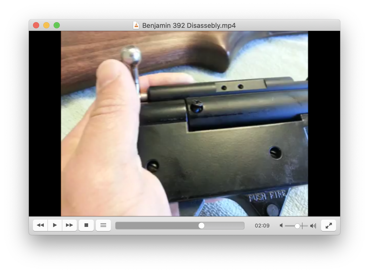

As I see it, the one real quirk in reassembling these rifles is that when you reattach the trigger assembly to the receiver, the bolt must be forward, but in the *unlocked* position. Otherwise, you won't be able to cock it. And you have to hold it in that unlocked position as you are reassembling it, or it will want to fall into the locked position. See the below photo.
