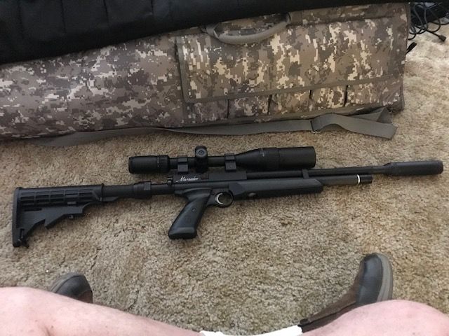

here's mine not a walker but very awesome little gun

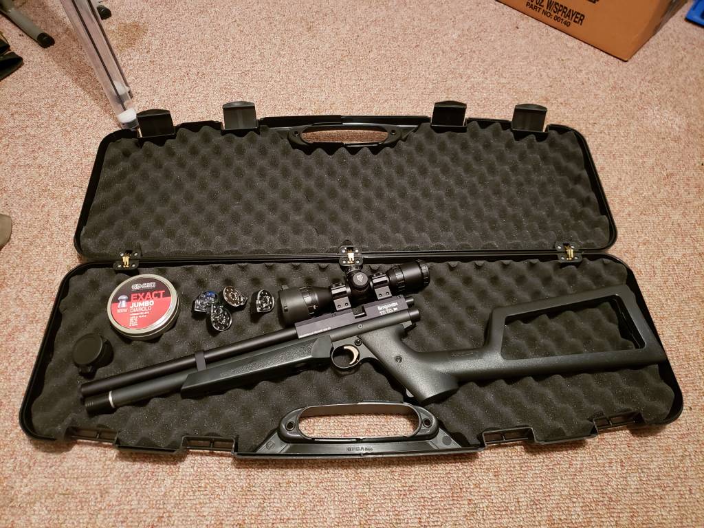

Check it out - my p-rod finally showed up. I got 'er tuned, barrel cleaned and sighted in. Looking around the house for some sort of storage to put it in when I toss it into the car ( when headed off to the farms ) it occurs to me - "Hey . . . I wonder if this little thing will fit in the equally little RTI hard shell case?"
I finally have a use for that ( dinky and more or less useless - lol ) case that one gets with those guns. :)
