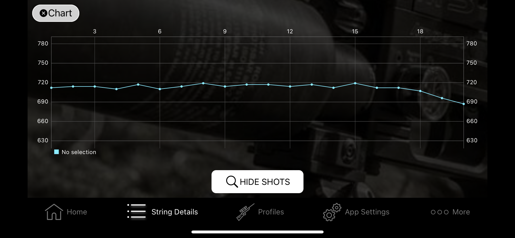

Thanks. I might have some questions later if you don’t mind. I just shot a couple strings I’m happy with. It’s like 75 degrees out so I’ll try again in the morning when it’s cold. Here’s my last string. Seems decent to me but I don’t know to much either haha. If tune atays there I’ll be happy. Well happy for now, you know how that goes haha.
Have a great rest of weekend,
Rob
