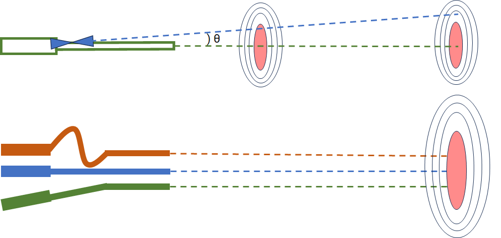

What matters is the trajectory of the pellet after it left the barrel not what path it took to get to exit the barrel. Once it exits it is always a straight path (ignore the gravity, the air resistance, the wind, …). When we correct the alignment of the barrel and the scope (we call it “zeroing the scope”) we are actually compensating for the angle between the barrel and the scope. That angle does not change no matter how far the target is.
Hope this helps.
