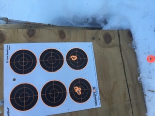

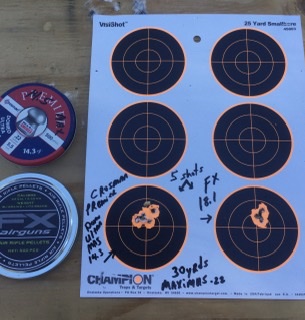

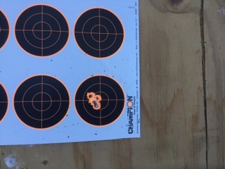

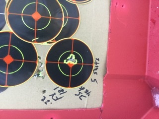

Benjamin Maximus .22 . Straight out of the box! Mounted a scope yesterday, sighted it in at 25 yrds. Shot some groups today...wow!
30 and 35 yrds pictures...CP 3x9X40 FPS Shooting CP ultra dome magnum 14.5 and FX 18.1. Thanks Odoyle!
