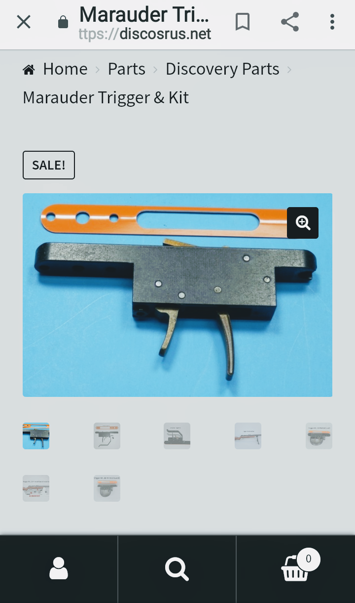

https://discosrus.net/product/marauder-trigger/
Actually add a WTB Gen1 Marauder and Challenger trigger group too. May get for $30-$40 maybe less since a new one $60-$65.
Have the $35-$40 Baker trigger in a Fortitude and it's not even close to the factory modded 3 screw OEM. LOOKS NICE though but not worth the $$$ spent when a little more gets the true match grade Hem1 Marauder/Challenger trigger.
Need to cut a gasket from a credit card for it otherwise ruin the sear.
Some places sell the trigger with gasket for a little more outside of Crosman. Whomever took over Lloyds disco double business for one and probably member NRN2015 But in Nelapudi NICK too.

DiscosRUs is temporary closed however. Which is too bad. The metal shim they sell with trigger makes things rather simple.
