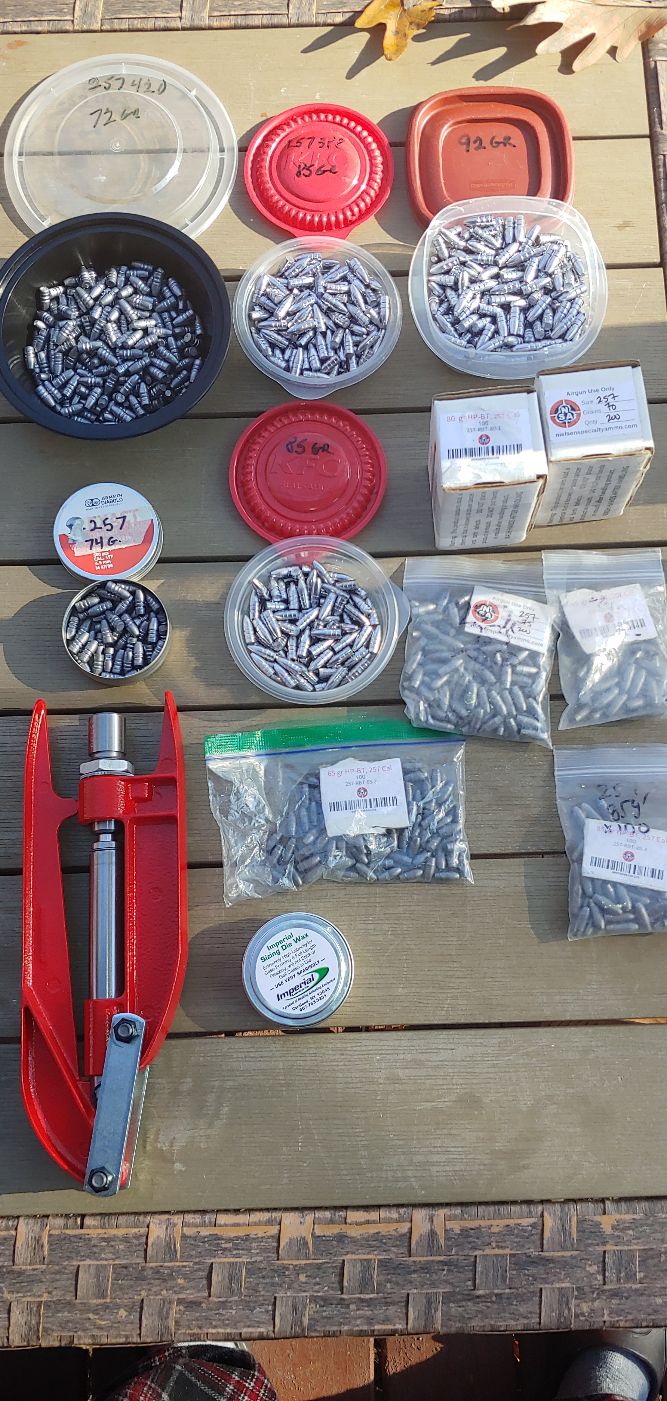

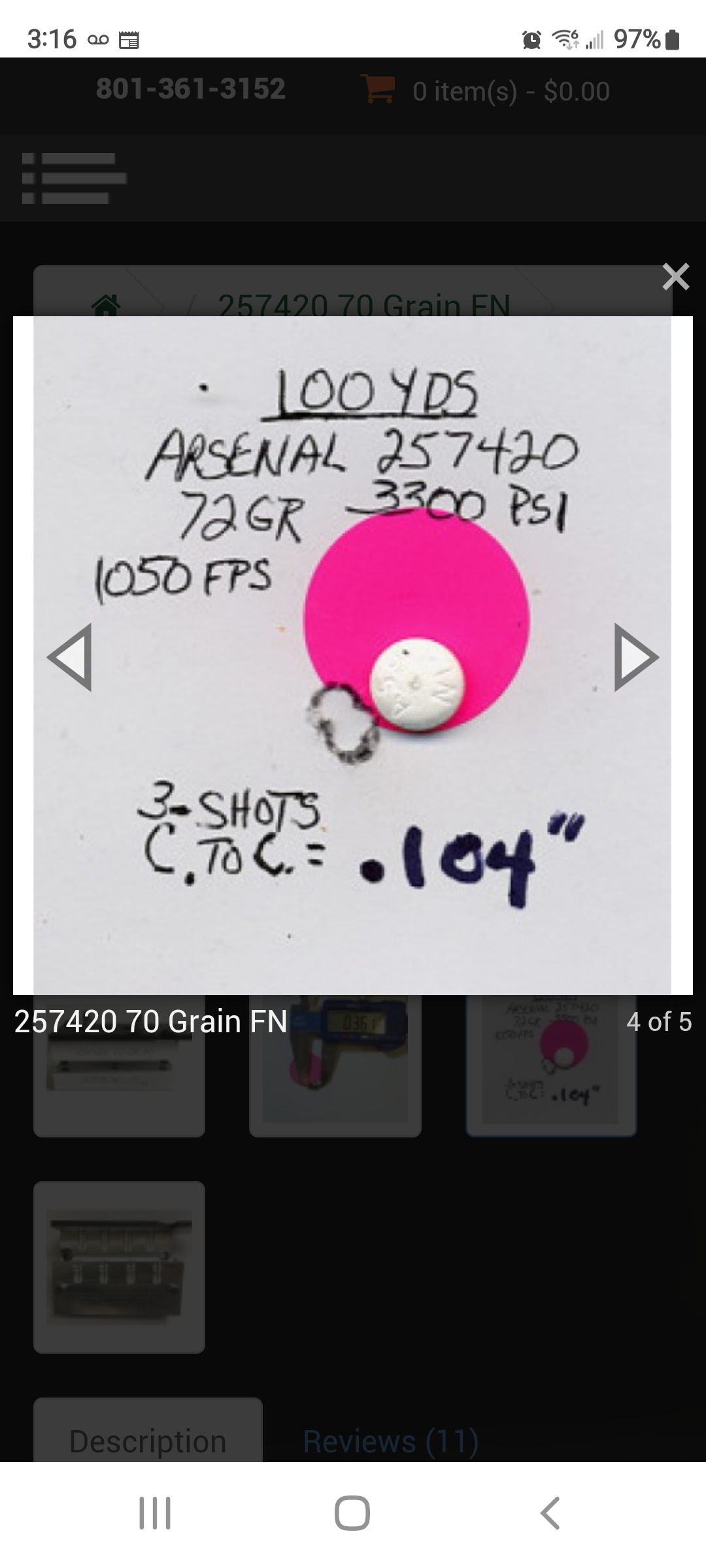

For what you described and your style of hunting a Texan .257 would fit the bill.
Thanks guys for the input. My problem is I can’t stand the looks of the airforce guns. But perhaps I need to adjust my tastes? That kind of accuracy is impressive. With the aftermarket stock maybe doable. Where do I find those stocks?

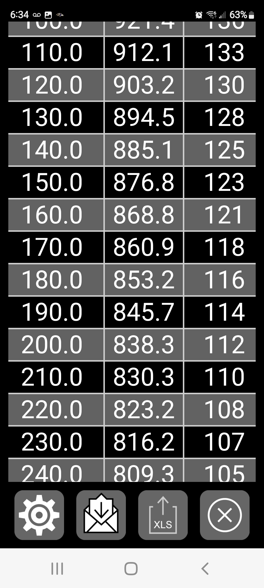

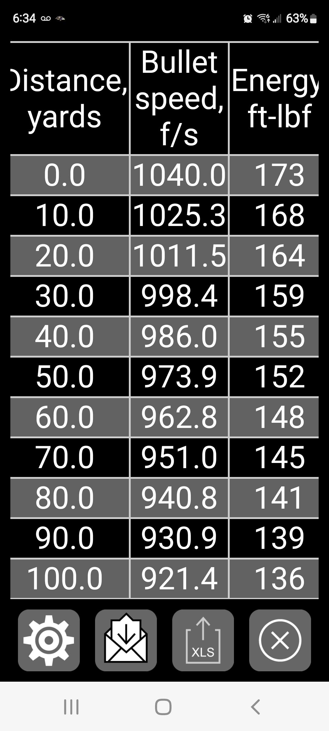

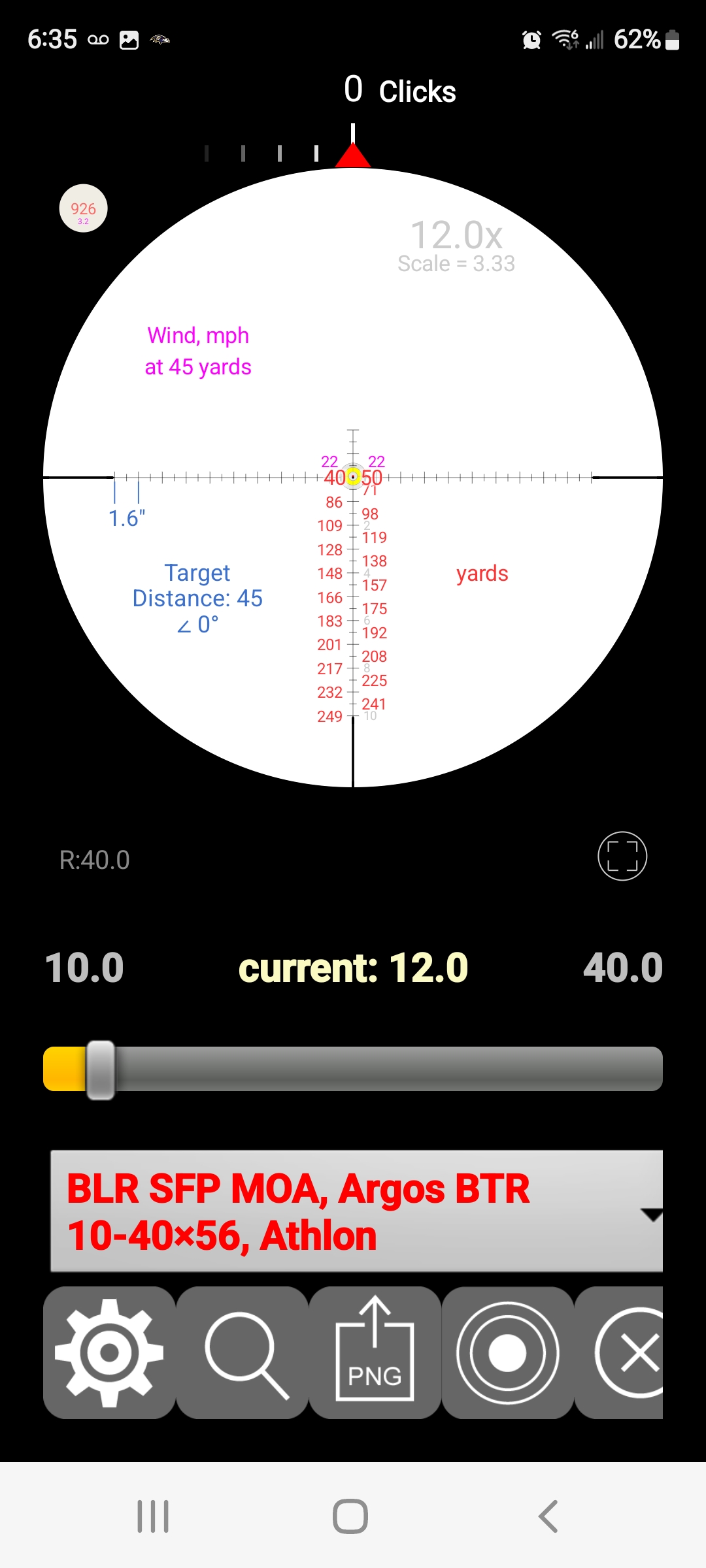

Take peak at the down range energy @ 200 yds. Your groundhog would be toast. Over 100 fpe.

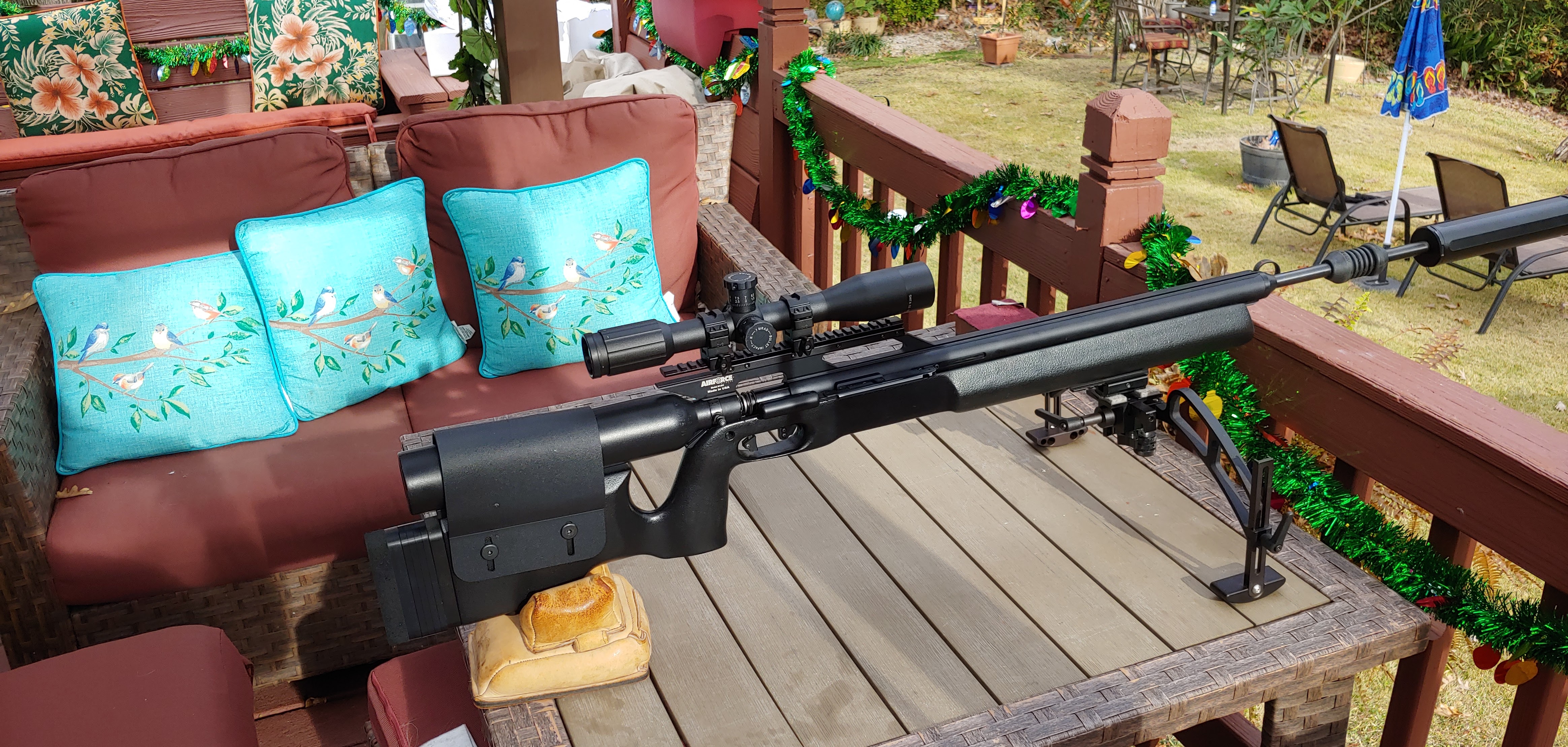

For what you described and your style of hunting a Texan .257 would fit the bill. View attachment 308685View attachment 308688
Love your AF Texan set up. Love the SWFA! Question, what picattiny mount is that? I looked at the AF dovetail to Pic mount and was shocked they want close to $50 for one. My Talon needs two of them which is close to $100!

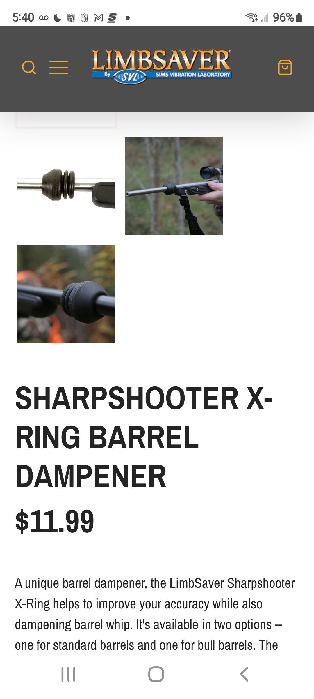

BTW what is that rubber piece on the barrel before the moderator? I don't have anything like that on my 24" Talon barrel?
The rubber piece is a limbsaver. It help with barrel harmonics. Pain in the ass to adjust but when adjusted it work. The rail is just a picatinny adapter. Hope this help
