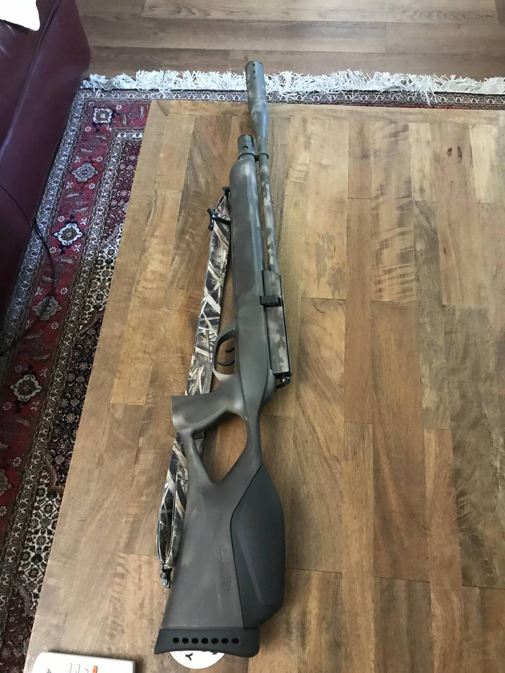

Urban. I bought one used for my buddies son. I wanted to make sure his first PCP experience wasn’t a bad one so I spent some time with it before he paid me for it. I ignored the the hatred I have for plastic stocks when I first started shooting it. It was very comfortable. It’s accuracy with 14.3gr pellets from various manufacturers was stellar. I’m super picky so and since it came with 3 mags I wanted it to be a 3 mag and refill gun. I had the gun tuned to shoot 3 mags starting at 810fps up to 830fps then back down to 810fps. The gun wasn’t loud but I knew it would be more silent if I took care of the hammer bounce so I built a SSG for it. It made a difference but isn’t necessary. I wrote down his fill and refill pressures for him and I think it’s like 40-50 pumps with the China pump it came with. All I can say is after getting it dialed in and scrubbing the barrel, I was a little dumbfounded by the groups it produced at 50yrds with Walmart Crosmans. Good cheap PCP.

I have to agree with Vetmx, I vote for the urban. I think the gen 2 gauntlet and the avenger are good, but since I don’t own them, I can’t really say. I do own some higher end rifles, edgun, ataman, weihrauch, all fine, but I still kept the urban. I’ve tried several lower end pcps, but the urban for me is a great back up, loaner rifle for me and beats many other rifles that I have used.
I have to take into consideration how much I paid for the urban, it was 199.99. I think I would pay 299.99, but not a penny more though.
