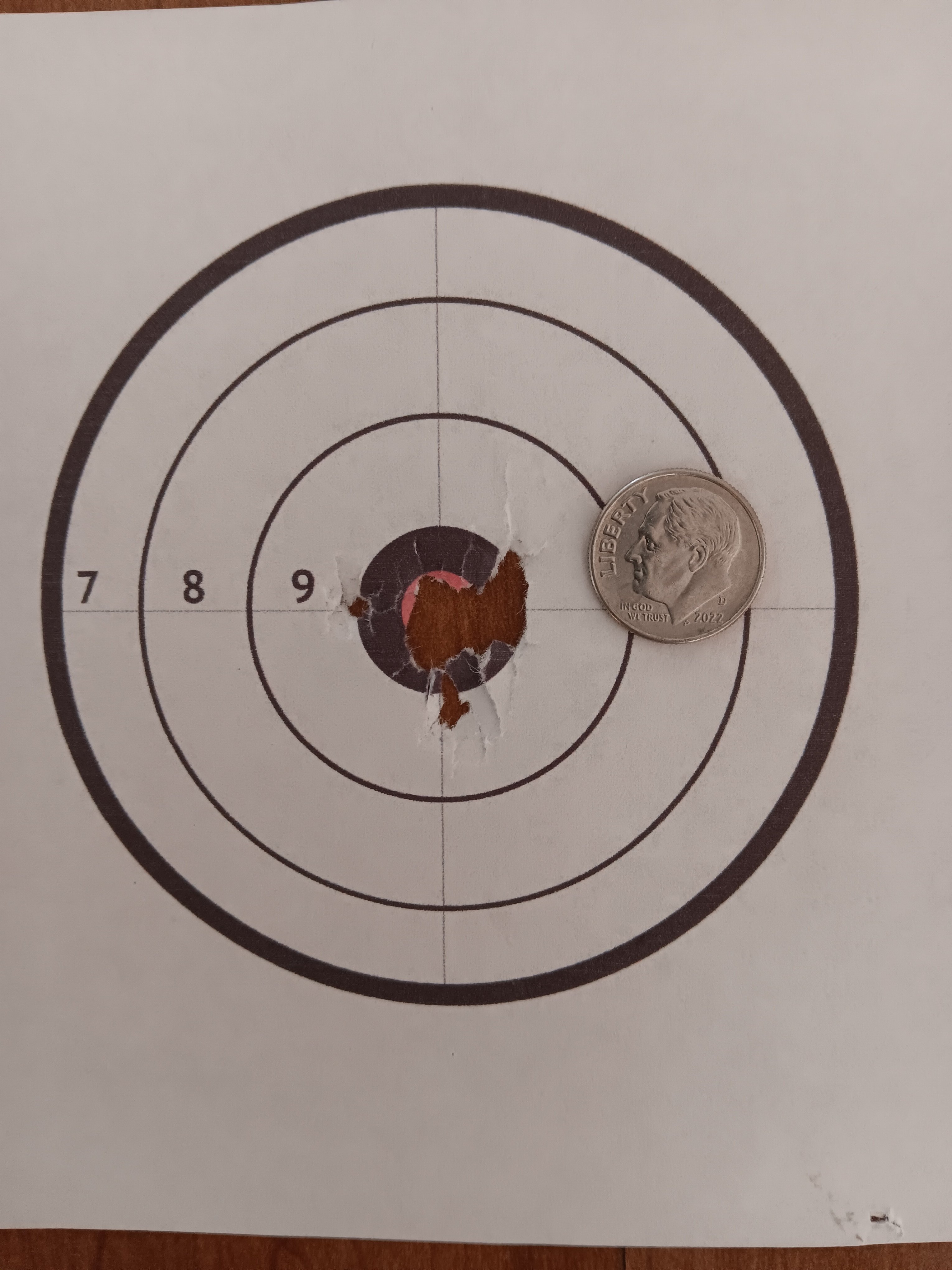

I was having trouble with my HW95 a few days ago. Couldn't hit a thing. I figured I'd scrambled another scope. I took it out and put it on paper. 30 shots 30 yards off a camera tripod. H&N FTT's.
I chronographed every shot. I am getting lots of variance in velocity. The low shot only 609 fps. The left shot was a rogue gust of wind. The rest were all over the map from 640-609. I think I'm having seal/spring issues again. Still the pellets fly pretty close together. And the scope seems to be holding zero....
....the pellets couldn't be too lopsided.
