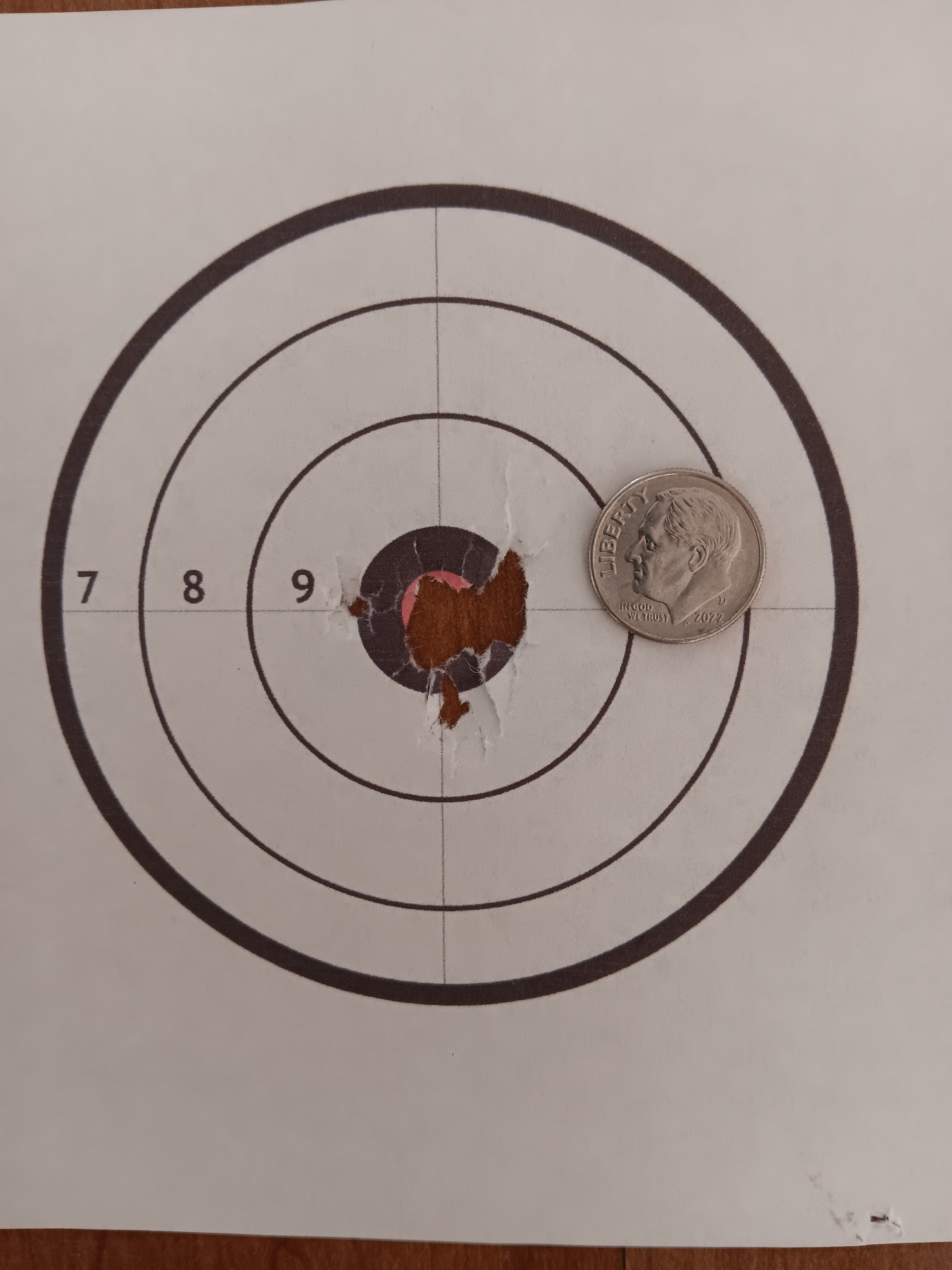

I was having trouble with my HW95 a few days ago. Couldn't hit a thing. I figured I'd scrambled another scope. I took it out and put it on paper. 30 shots 30 yards off a camera tripod. H&N FTT's.
I chronographed every shot. I am getting lots of variance in velocity. The low shot only 609 fps. The left shot was a rogue gust of wind. The rest were all over the map from 640-609. I think I'm having seal/spring issues again. Still the pellets fly pretty close together. And the scope seems to be holding zero....
....the pellets couldn't be too lopsided.

So the Apolo 16gr have been a pleasant surprise. At my standard pesting range of 15.5yd they stack a 1/4” bull at full TP and 2nd lowest TP.
It did take a lot to get them clean, they are the dirtiest pellet I ever encountered. They required a degrease wash, tumble, light soap wash, tumble. My first tumble is used a white microfiber and I got large flakes of lead, and a significant about of lead dust wipe on the towel.
With FX 15.9gr for 12 bucks at UAG it really isn’t worth all the extra labor to get them to a state I will shoot them from my rifles.
