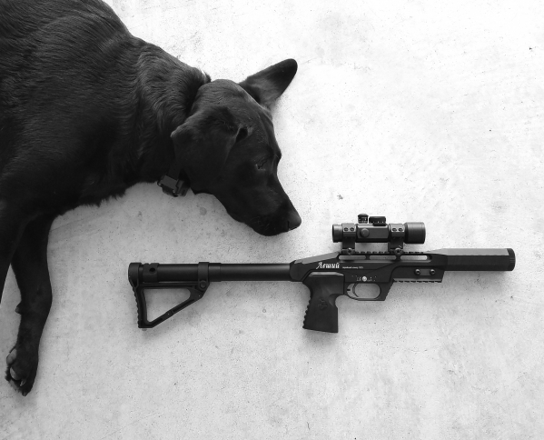

My votes for the EDgun Leshiy as well. Smallest, lightest Airgun i can think of. Folds in half for compact carry.
I've got mine set up to shoot the 18g JSB about 800 fps for 18 shots. If you wanted more shots you could tune it to shoot a lighter pellet at a lower velocity & double the shot count.

I think the Leishy along with a 480cc cf bottle would likely still be less weight (and shoot a whole lot better then a springer putting out over 25fpe. And then with the Leishy you will get at least double your 19 shots.

Hi Michael, what scope have you got on that leishy?

Its an Ultradot Matchdot 6. Only good for 30y or less. Waiting for the Dedal Stalkers to arrive at EDgun West.

I rarely take more than a few shots when stalking/hunting. After 18 shots mine drops off the reg. I feel like I've got it maxed out for power & efficiency. I read that others are shooting the 14.3 or 15.9 grain pellets at a lower velocity for almost double the shot count. But higher shot count is not what I was after.

The Leishy is a nice gun, I first saw it back when Ted did a review of it. Aside from price, my main hang up is it is a pcp that is single shot, when it comes to pcps I really feel a repeater magazine is almost a requirement (I would make the excepetion for the Evanix Rex P in .357 or .40. That power in a compact package seems worth the trade. Wouldn't even consider it in any other caliber though).
The Leishy has to do all the same motions and loading as you do with a springer, but you don't get the self sufficiency. Granted you don't have the kick and vibration of a springer, and it is compact and lighter than most springers. Additionally, to be really compact it has to be folded in half, this leaves the breech open and dirt and anything else can get in there, I suppose you could keep a pellet loaded, but its still open. Never the less, it is a great gun, not diminishing it and that it works awesome for others, just my own quirks.
To me (personally) the Ataman AP16 would be a better choice over it: repeater, still solid power, less than half the weight of the Leishy, and always compact. .22 cal (Leishy takes the lead here in being available in .25 as well)
From personal experience, what is the bark on the Leishy like? The only guns I have to compare to are the Marauder pistol .22 and Bulldog .357. From what I understand the AP16 is louder, as .22 air guns go.
