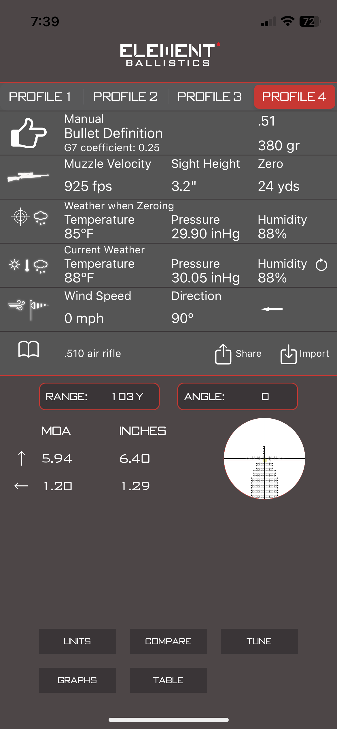

I use both Chairgun Elite and Element Ballistics. If you want just basic data, the Element is probably the easiest to use because it doesn’t require a bunch of data points you probably won’t want to input and at the end of the day, if used correctly the end results will be the same.
Chairgun has a bazillion reticles if you are a reticle nerd. In the Element app, I use a reticle very similar to the one in my Athlon scope.
The absolute most important data point you will need regardless of which app you use is the TRUE ballistic coefficient and this can only be determined with your gun and ammo and a free standing (non FX pocket) chrony.
The ballistic coefficient or BC is one of the most overlooked and poorly acquired data point when folks use a ballistic app. The BC for lack of a better term, is an efficiency value determined by not only the gun, but the ammo you are using, the speed at which you are shooting and even the twist rate of the barrel. You can get close (but not very) by researching the ammo on line. It just depends on how accurate you want to be.
