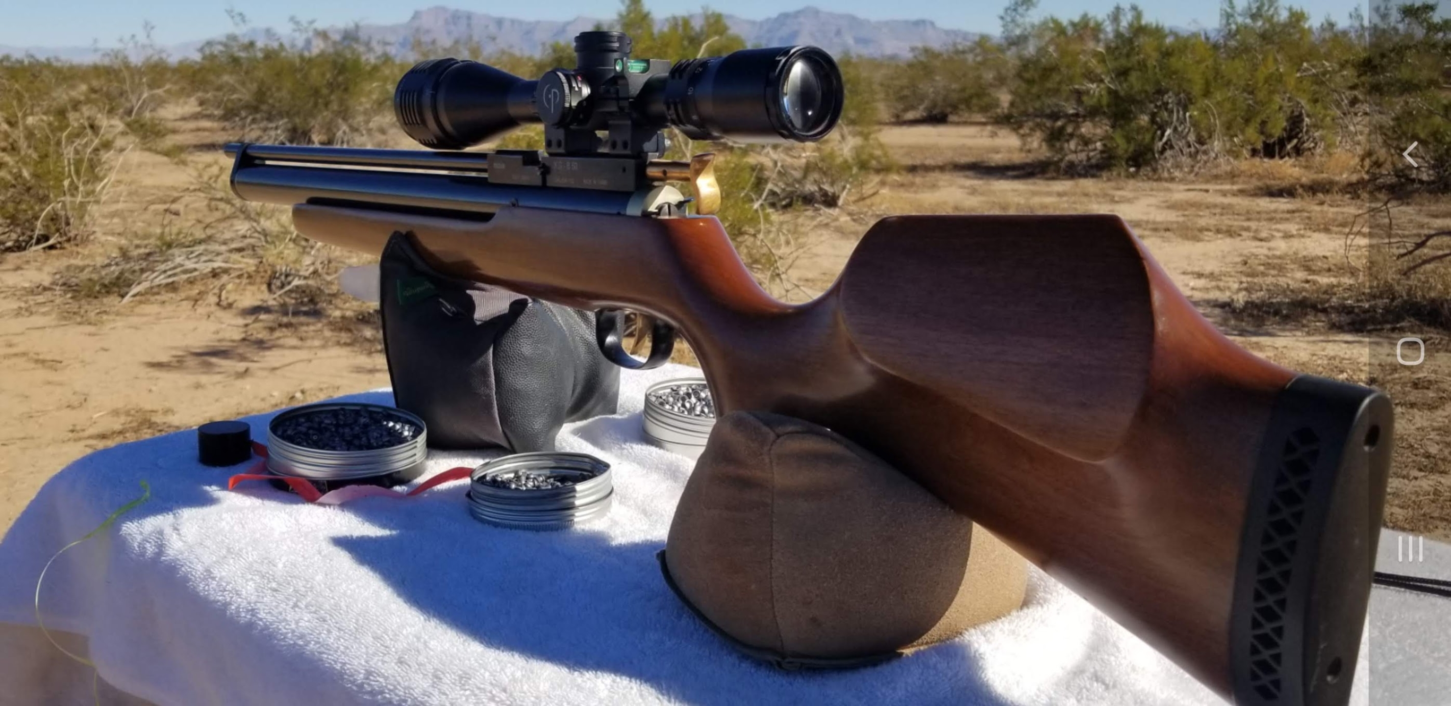

I like shooting my BSA R10 as much as any of my other rifles. First of all, it is a .177 so a perfect caliber for urban backyard pesting. Second, it is a beautiful rifle to hold and behold. Lots of pride in ownership. Third it is laser beam accurate. I kill loads of sparrows and starlings without a miss. I just expect to hit where the crosshairs land on my target. The Huma Air shroud and internal moderator has this gun shooting super stealth mode, which means very backyard friendly. It is not too finicky about pellets or slugs. It likes the pellets on the heavier side, 10.3 and on up.
