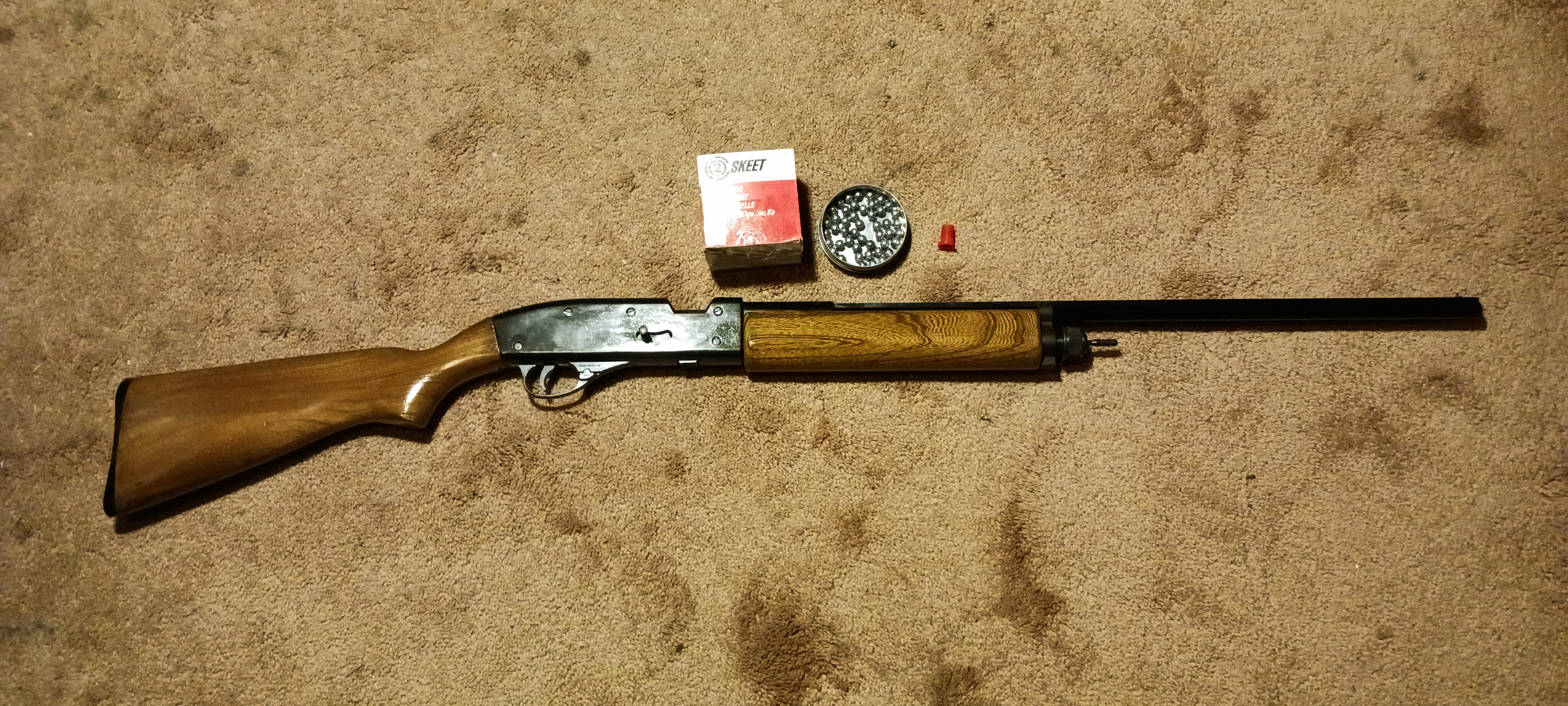

I'm currently making a low power 25 for close range and indoor pest work. Hoping for an accurate shooter at 550 fps with 25 grain pellets.I played with a fpe calculator and I think a ~20 fpe 25 caliber is pretty doable. You could push 25 grain up to about 600 fps and if your gun happened to like 20 grain FTTs you could go almost to 700 fps. Those are not high velocities but are in the same range as the stock tune on my old Prod. Inside 30 yards I think it would work great. Nice big pop on the pigeon but less chance of penetrating the roof. Getting an inexpensive 25 caliber to 50 fpe can be a challenge but tuning it down to 20 fpe should be easy. It would be quieter and use less air. Should be fun to shoot.
