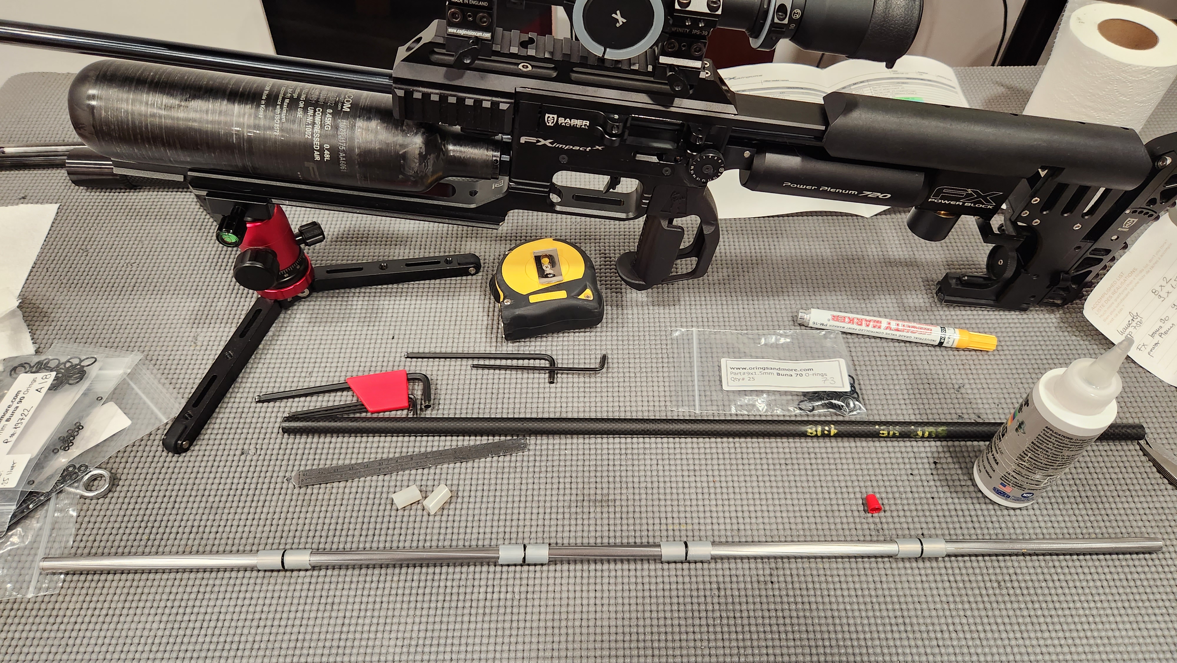

ER has a video for bonding the cf to the liner and 68 whiskey in an interview with AEAC said he bonded his.

I epoxied a carbon fiber sleeve to my Urban barrel. This was due to destroying the "pickle" inadvertently when I double fed a pellet early on. Surgery via propane torch removed the pickle cleanly but then I had to address the ugly end. I found a cf tube that was a snug but slip fit. I used a slow cure epoxy to allow a good bond. I also fitted a 1/2X20 adapter to the muzzle and butted it to the new carbon fiber sleeve. The rifle was accurate before but more accurate now.

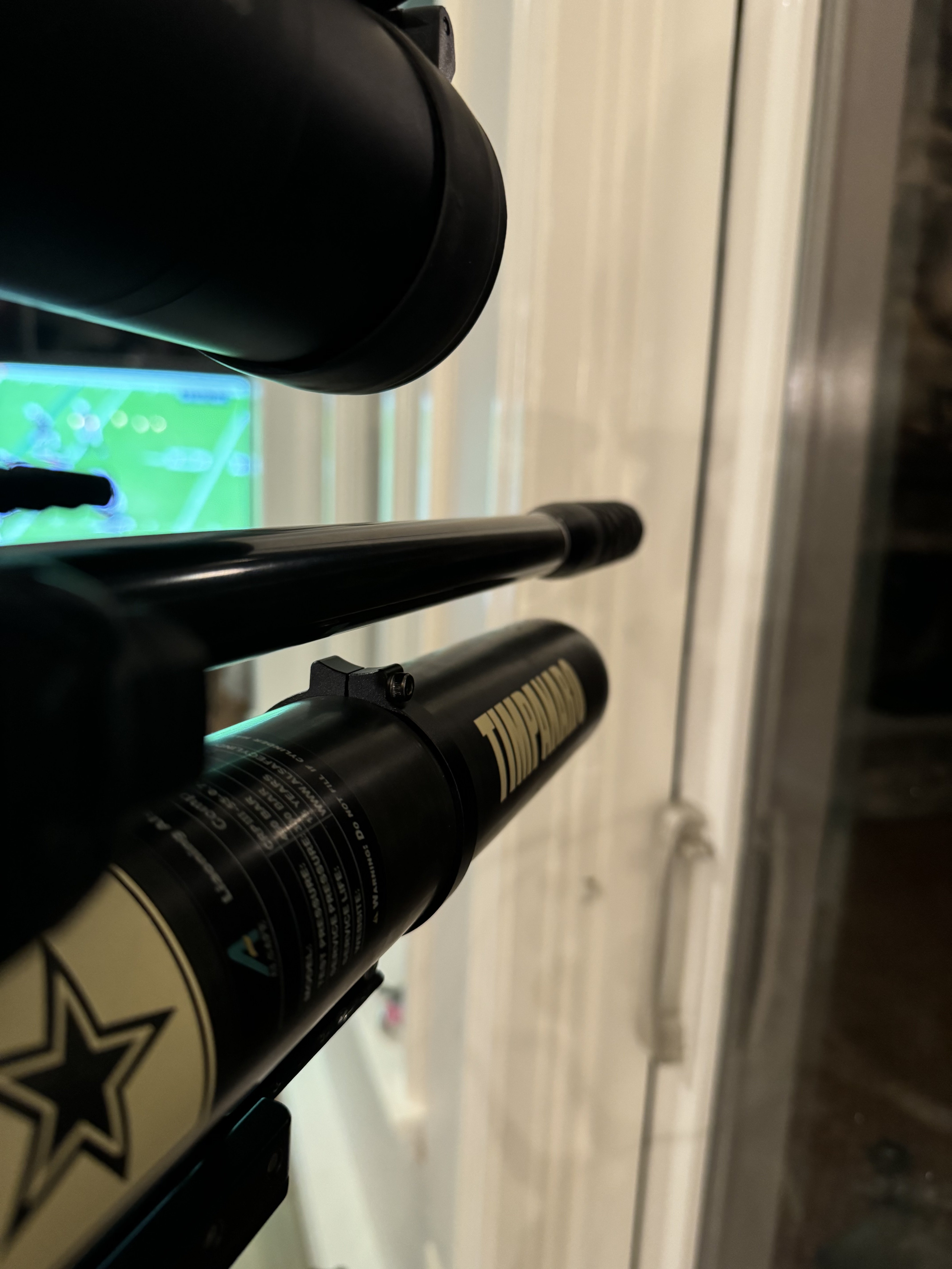

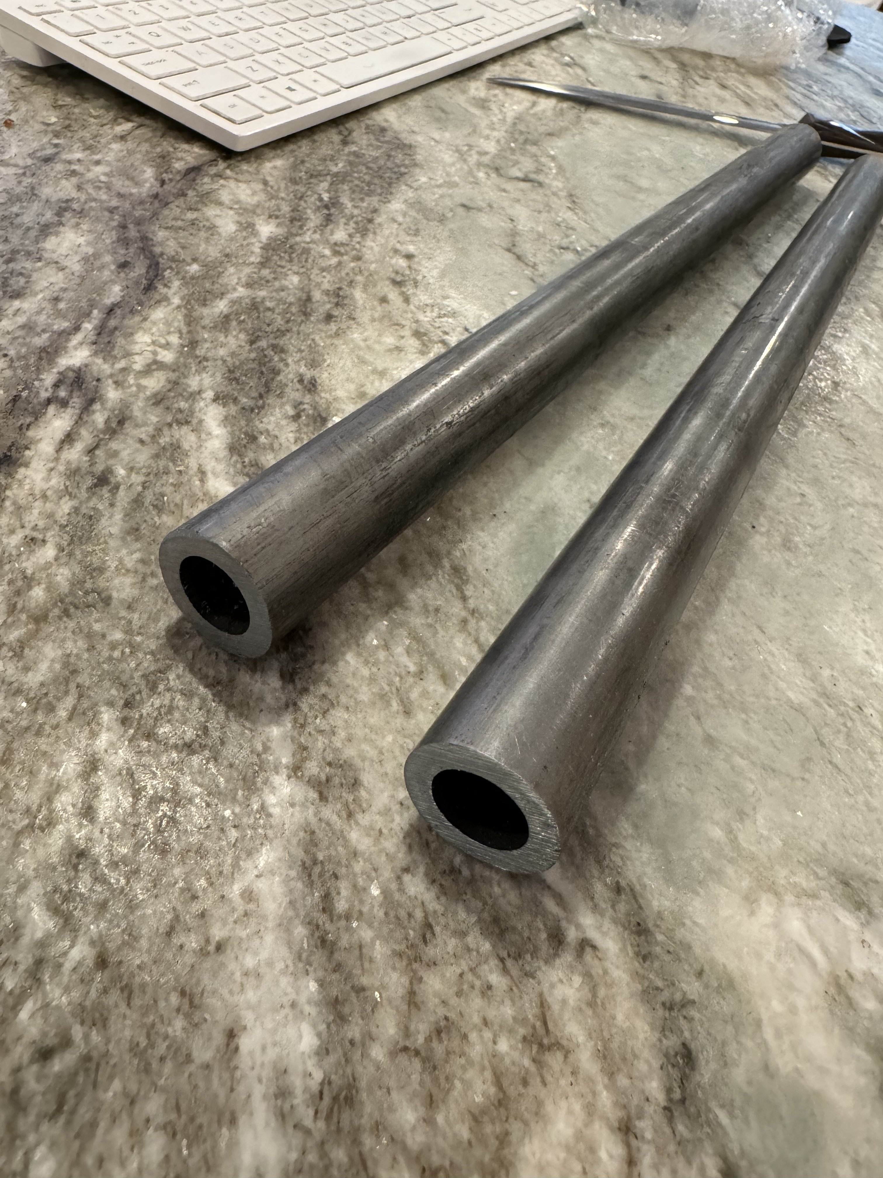

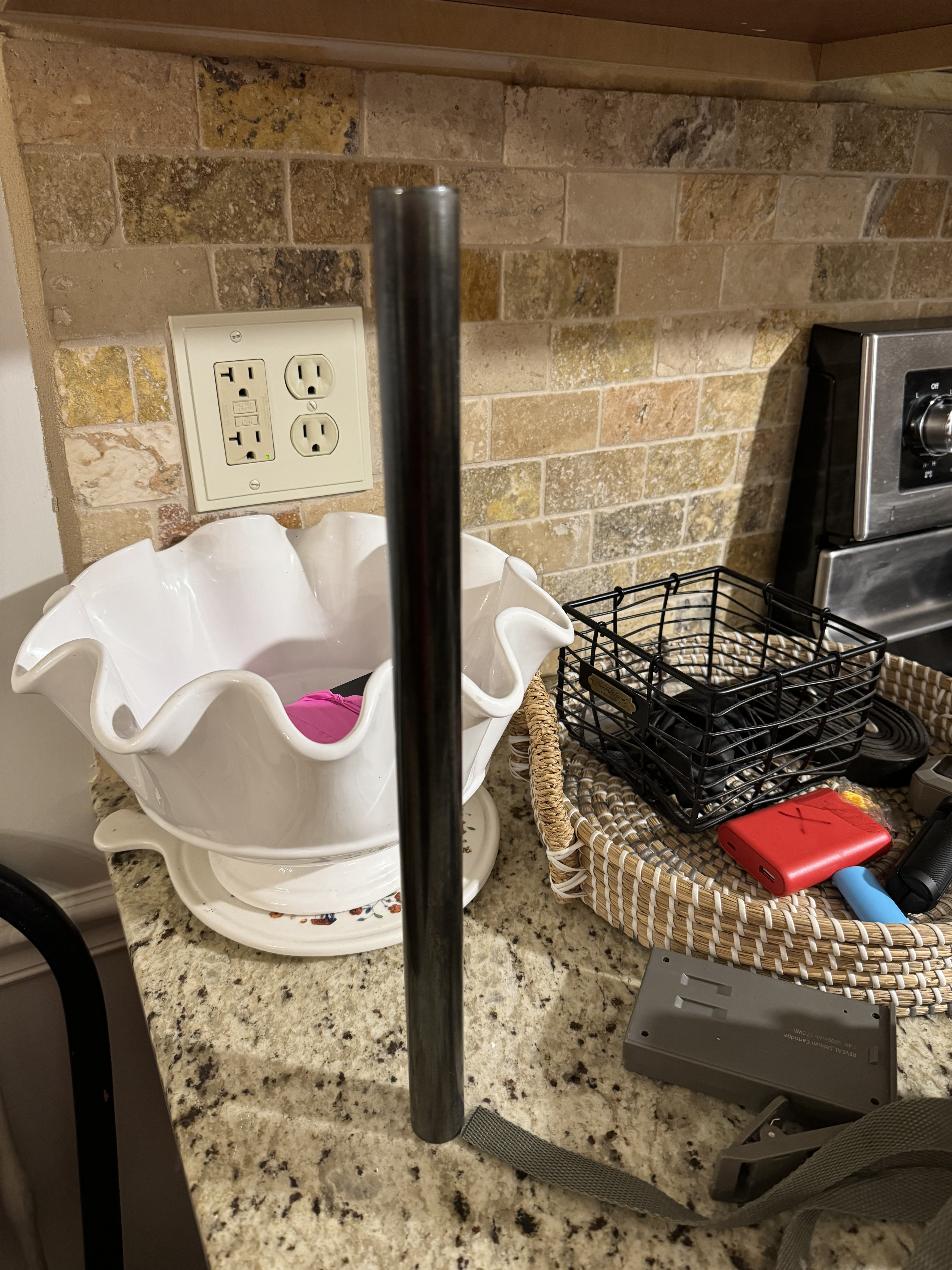

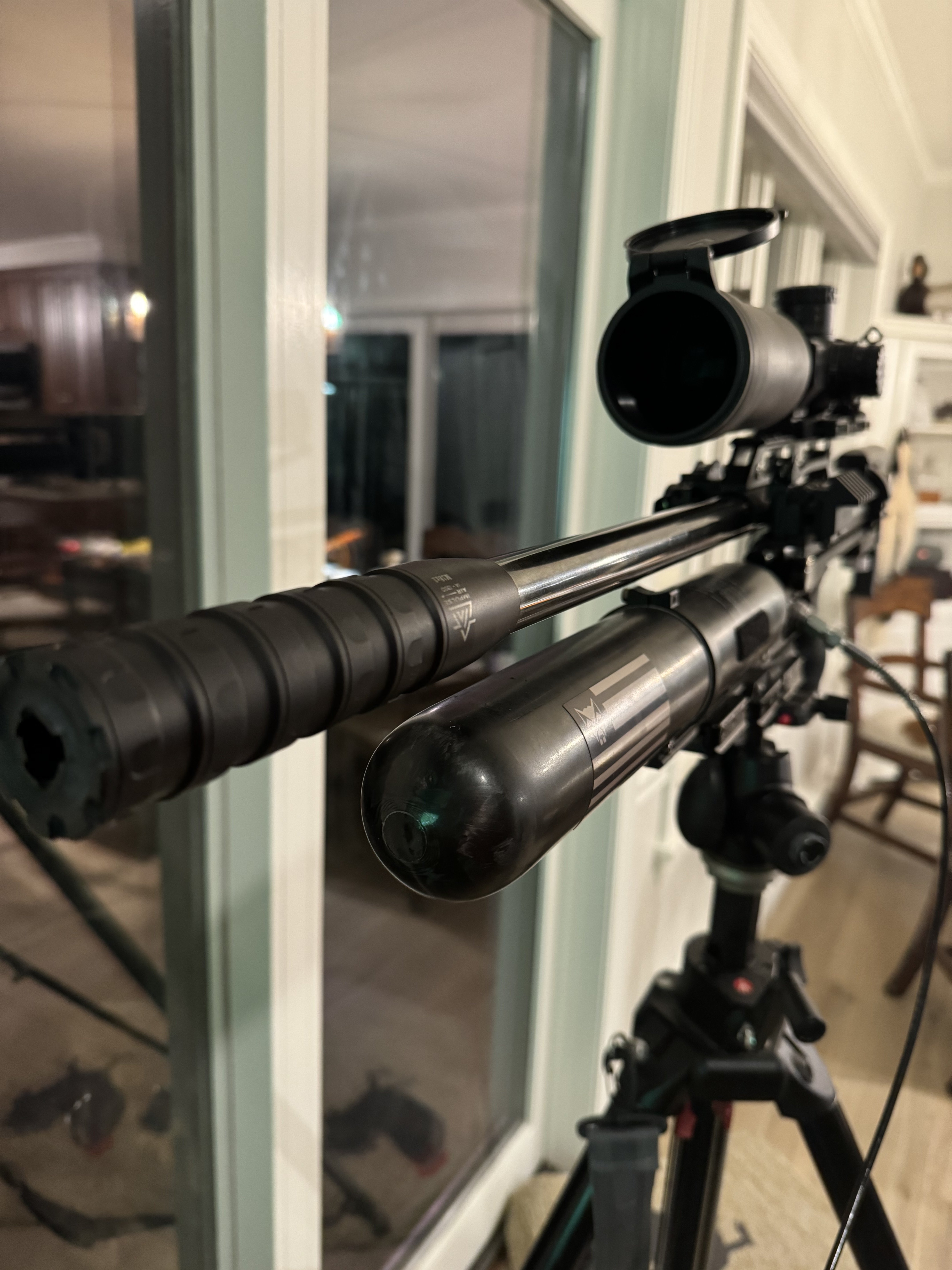

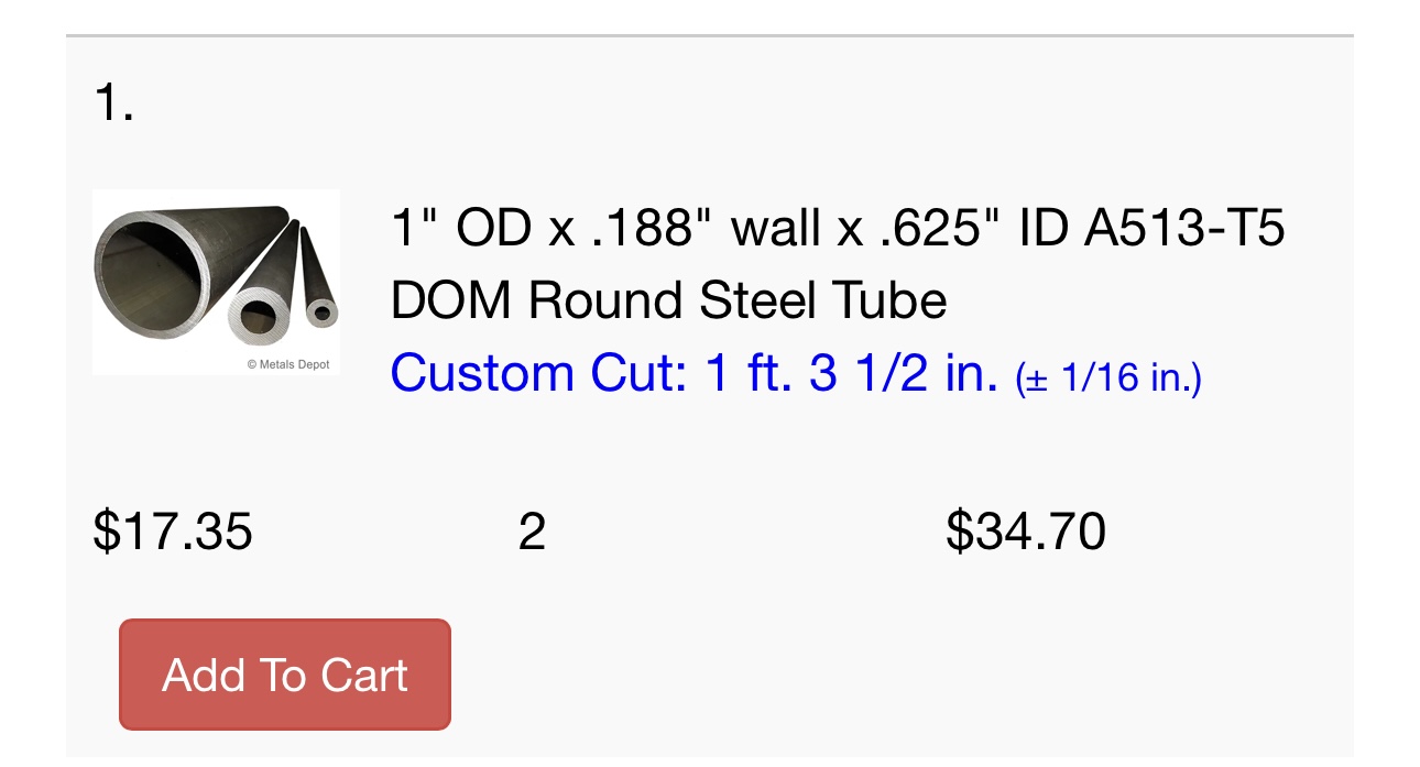

After considering carbon fiber sleeves to stiffen up my flimsy (15mm OD) TJ Max barrel, I ended up choosing a steel option instead. I chose steel because it’s heavier, not stiffer. My knowledge in centerfire pointed me in this direction because I learned that SLOWING down BARREL vibration YIELDS bigger load windows and makes more consistent exit timing. A slower vibration leads to better repeatability. Thanks Eric Cortina!
I ordered a piece of steel tubing from metal depot, cut to length. 1” OD, .188” wall thickness. My sleeve slipped over my barrel with ease because it’s .034” larger ( 1/32” or about 4 times the thickness of electrical tape ) than my 15mm barrel, so I slipped it over my TJ barrel and spaced it with double thickness electrical tape at two spots . The new sleeve slipped over my barrel snugly after spacing with electrical tape.
I took the gun outside and it stacked slugs at 100 yards from a tripod, high barricade standing position. No recoil issues, no muzzle rise nor did I need to shoulder the rifle to mitigat recoil. The gun went from 4” groups at 50 yards on a bench with sand bags to hitting a squirrel size plate 9 of 10 times at 100 standing from a high tripod.
Now when I shoot this rifle, it doesn’t kick like a mule.
I also blued the barrel to make it pretty and now it’s less likely to rust.
My recommendation , don’t use carbon, go with steel for extra weight. Slow the hormonics down and don’t overthink epoxy. I just did this in an hour and $25 no epoxy.
I ordered a piece of steel tubing from metal depot, cut to length. 1” OD, .188” wall thickness. My sleeve slipped over my barrel with ease because it’s .034” larger ( or about 4 times the thickness of electrical tape ) than my 15mm barrel, so I slipped it over my TJ barrel and spaced it with double thickness electrical tape at two spots . The new sleeve slipped over my barrel snugly after spacing with electrical tape.
