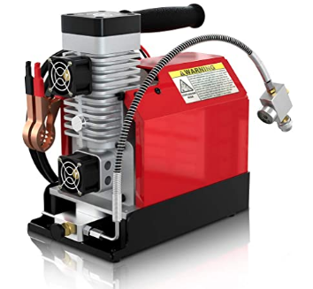

I went with this "GX compressor" off Amazon. It's about USD $380. It's air cooled.
What I've done is bought a big air tank. Rather than worrying about a compressor that can fill a tank rapidly, what I did is build a small Arduino circuit that turns the pump on and off, to give it enough cool-down cycles so that it never gets very warm. I leave the pump on for about 90 seconds, then have it off for about 5 minutes. After about 3-4 hours, my Air Venturi 74 cu.ft tank is full to 4500 psi. That's starting from empty.

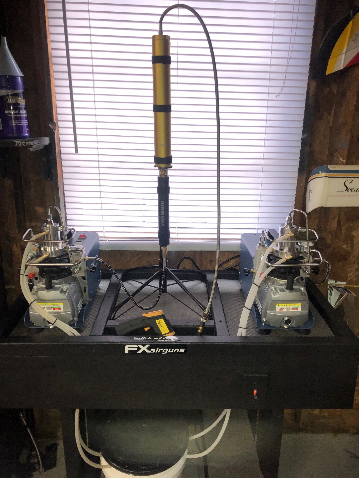

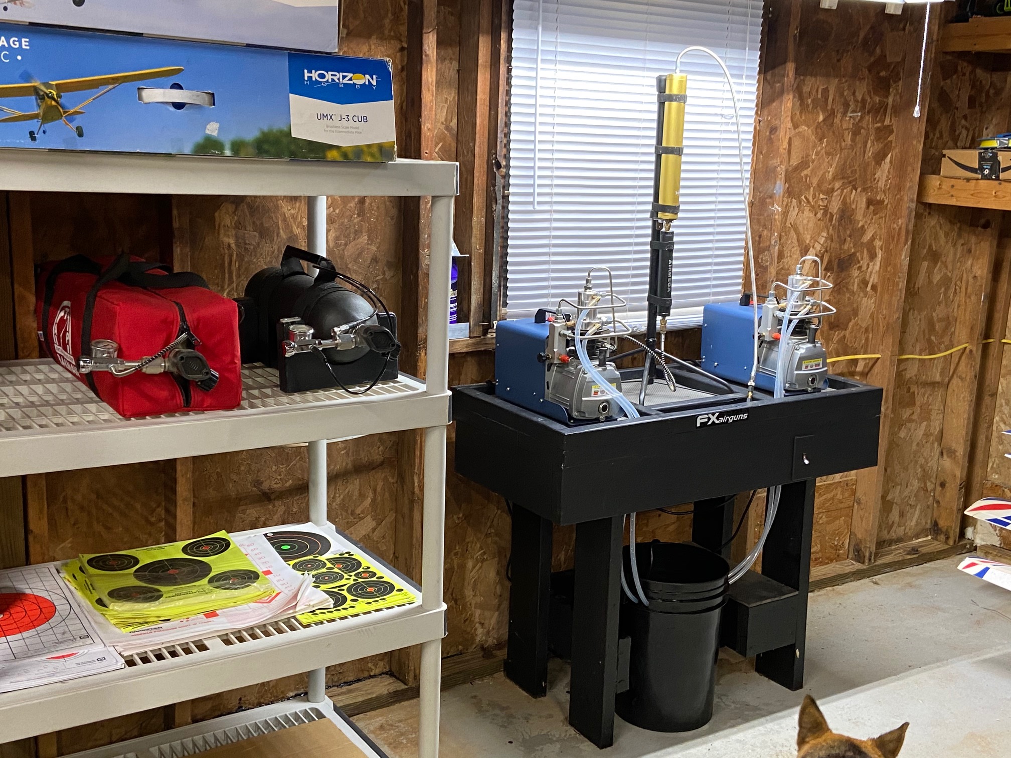

Here is my Yong Heng setup. I have been using this for 4+ years. It has worked great but you can't just cut it on and forget it. You have to watch temp and I don't run more than 7-8 mins at a time. I have filled a 30 min and 45 min SCBA tank from empty. Yes it took a while but now I just keep them topped off and that works great.
I've been using the GX-E compressor for a few months now. Before I picked it up, I jumped on YouTube and found a channel called target forge. He went in depth about this Compressor and showed hiw to maintenance it with better grease and certain areas to watch out for. It's been really good for me, but I don't fill large tanks with it. I think my next one might be a young hang, as I want to pickup a large tank for refilling in the field. Any good luck 👍
@dtacmed I like your table. That’s a really nice looking set up. Have you had any issues with moisture in your tanks or your guns?

Thanx!

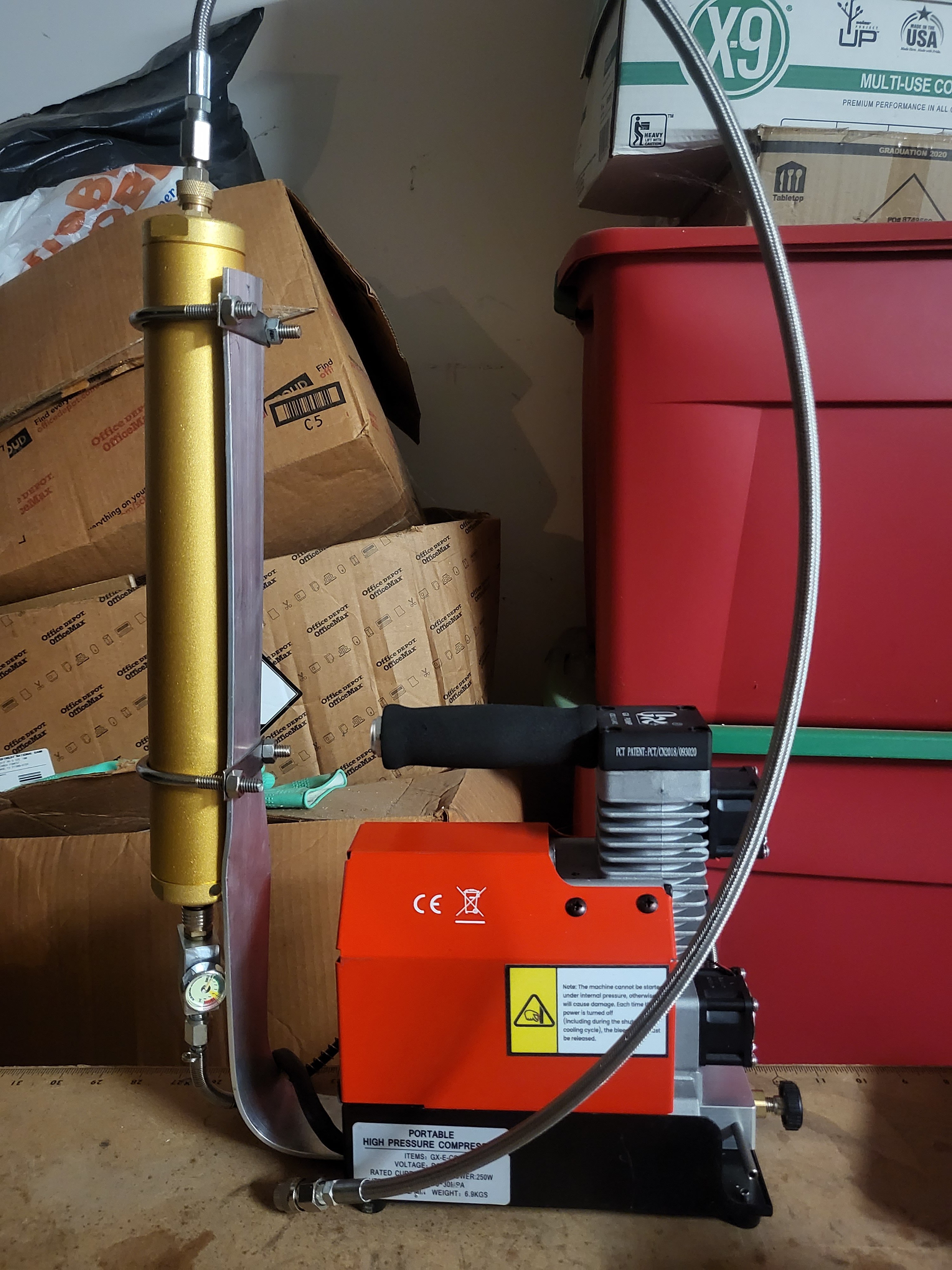

DrDv8
Which external filter, gauge and pressure line extension are you using there for moisture removal and do you find a difference/ improvement

DrDv8
BP-1
Hello bullpupone, my filter is a Tuxing Diving Seperator 4500psi. I picked this filter because my Gauntlet 2 can be charged up to 4500psi, I never go that high but I do go to 4000psi. My fill whip is a Maddog Paintball Airsoft fill whip hose extension 4500psi - 36 inch stainless steel charging system. That whip came with all the needed fittings, plug and play with my Gauntlet 2 fill port. Now as for what's in my filter, I use 13x Molecular Sieve, and Dry & Dry Orange indicating silica gel. I mainly use the indicating gel to indicate when I need to change my sieve. I made two chambers inside the filter plastic tube 75/25 (1st chamber 75% of tube and chamber 2 is 25% of tube), 1st top chamber the one next to the outlet is sieve, second chamber under that next to the intake is dry & dry. Like I said as soon as the dry and dry starts changing colors, I'll replace all of it with new. I live in southern Texas and we have so much Humidity here, I have to take steps in order to keep that water out of my guns and regulators. As of this writing, I have had no water in my guns. I have shot 22 cans of jsb monsters in my Gauntlet 2, and I have pulled it apart for cleaning and inspection. I too was curious if what I was doing was in fact working. Ater seeing the photos from hajimoto about the water he was getting in his guns, scared the hell out of me. As for the gauge on my pump, I picked up a psi gauge for the GX-E from target forge website everything else you can pick up on Amazon. I hope I covered everything, I don't know what's the best way but this is how I do it. Good luck
