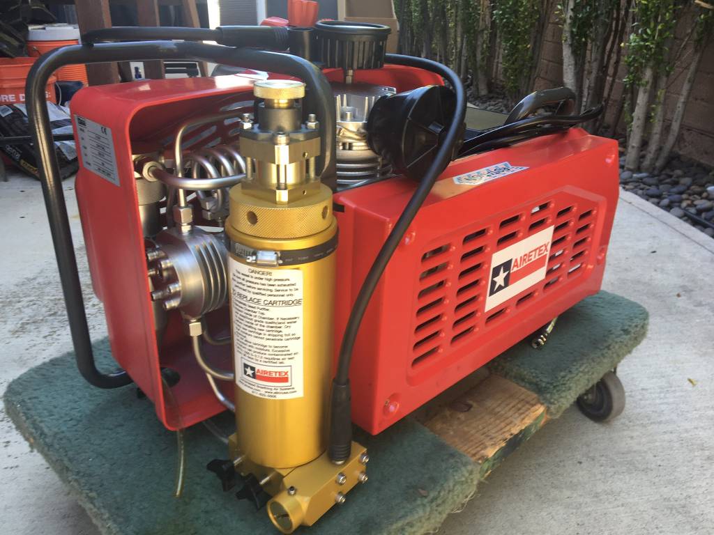

I’ve always been a big fan of the Bauer compressors. A few years back I found a “used” Bauer Utilus 10 that was 20 years old but never used. Apparently this guys Dad had gotten it, stored it then got sick and passed away. The seller found it years later in his Dads barn and wanted $1800. I waited a day to say I’d take it but too late, already sold.
Fast forward three years and I ended up getting a good deal on a new AireTex Mini Magnum that is an exact copy of a Bauer Junior II. Three stage, tops off a standard 45 min (66 cu ft) SCBA tank from 200 to 310 bar in about 7 minutes. I like that the cyclone moisture separator is between the 2nd and 3rd stages plus there are other vents valves at the bottom of the DQA filter at the outlet of the 3td stage.
To me it appears the only difference is mine is red and the Bauer is blue. I’ve got about 8 hours run time on it now and it’s run flawlessly. I paid $2495 which I considered to be a good deal. Two year warranty and Bruce Dodson has a good reputation.

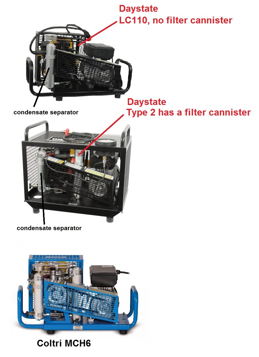

Coltri or Nuvair versions are different because theirs have the breathable air systems whereas the Daystates do not.
For the Coltri compressors, that might depend on where you buy it.
From what I have read and seen on the sales pages, only the Daystate LC110 does not have a filter canister, so no breathable air system. The Daystate Type 2 has the filter canister and is advertised as having "breathing quality air".
The Coltri compressors typically come with a filter canister but I have seen some MCH3 compressors available without it, so you can probably order it either way.
If ordered from Nuvair and you specify that it will be used to fill breathing/diving tanks, the Coltri compressors will be configured with a breathing air filter. For paintball or airgun use, Nuvair will configure it with an industrial filter (more desiccant and no charcoal filtering). You can use either, but the industrial cartridge will likely last longer.

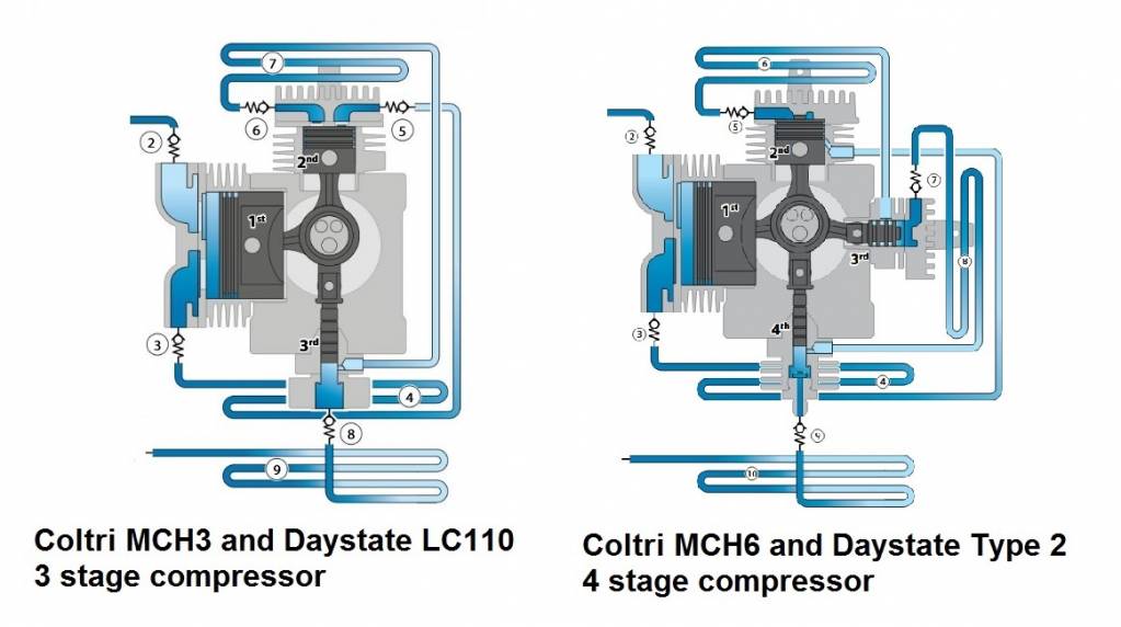

The Daystate LC110 is (or was) based on the Coltri MCH3. The Daystate Type 2 is based on the Coltri MCH6. Daystate has their own configurations so you get what you get. The MCH3 and MCH6 can be ordered with various options. The main difference between the MCH3 and MCH6 is the compressor:
The four stage compressor will likely run cooler and be more efficient.

All MCH3 compressors are 3 piston. The MCH6 has 4 pistons.
