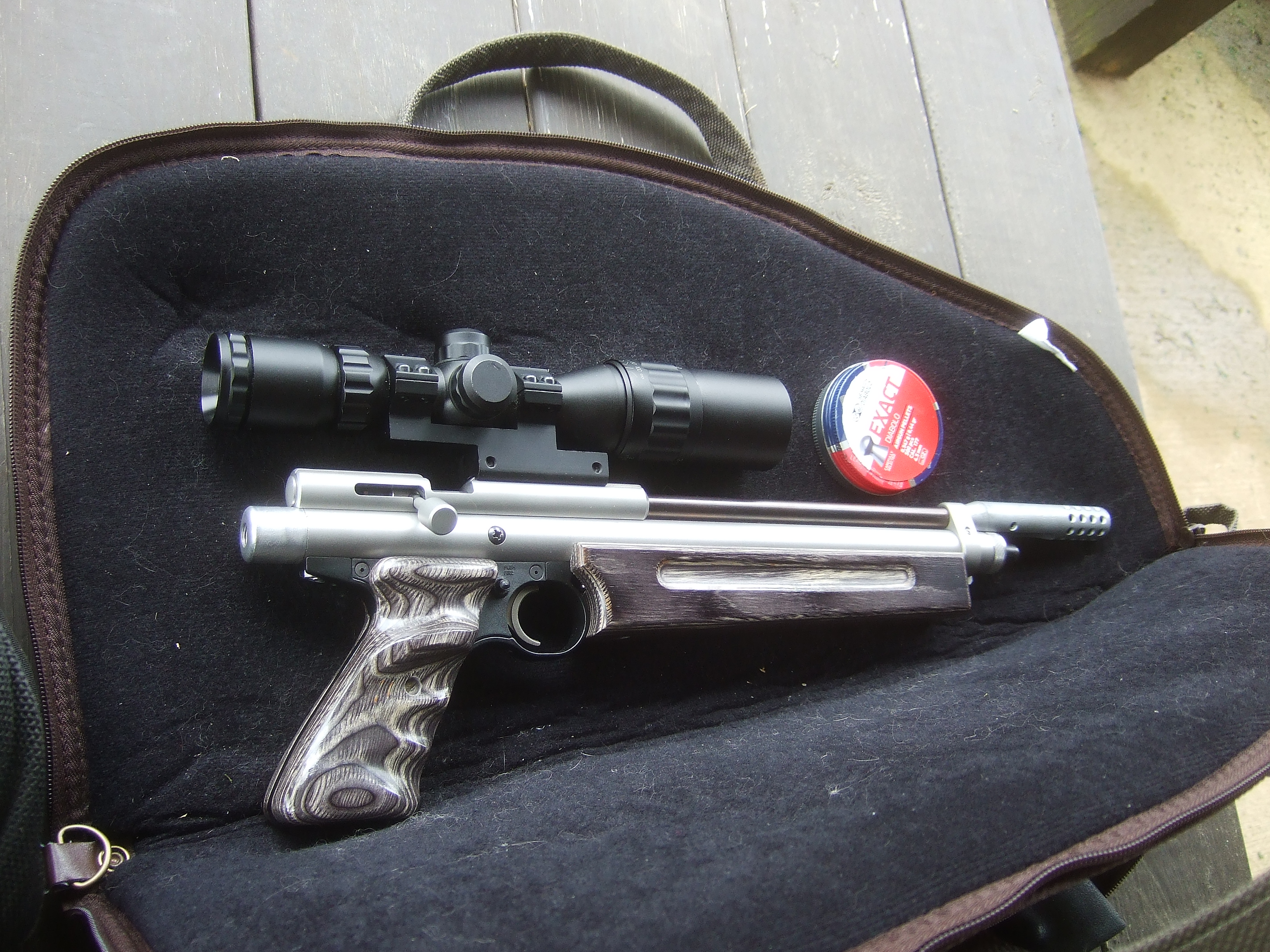

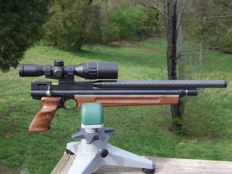

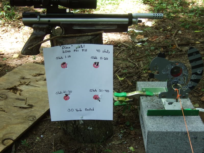

These two were fun builds, both pre-date the P-Rod & the 1720T

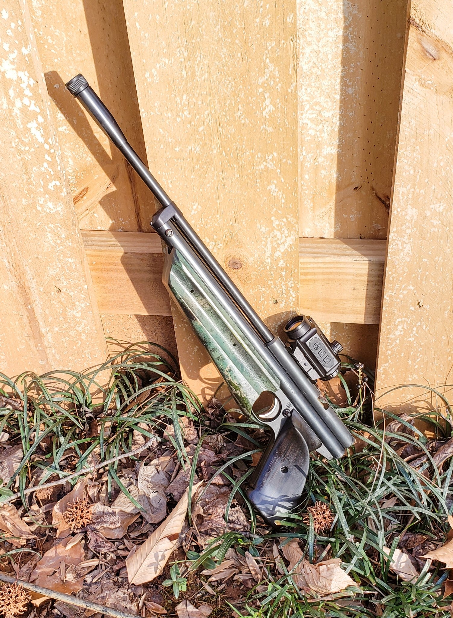

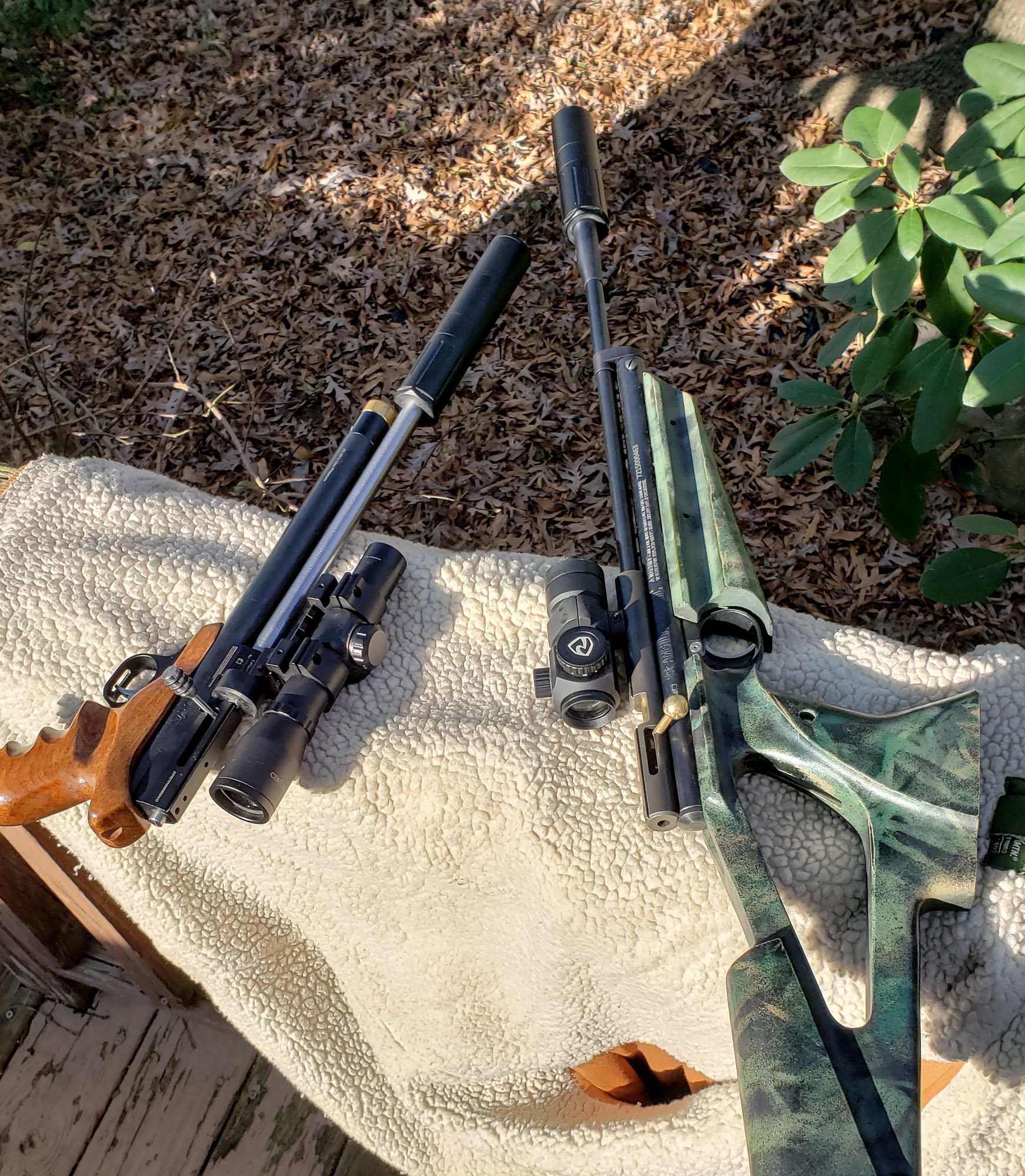

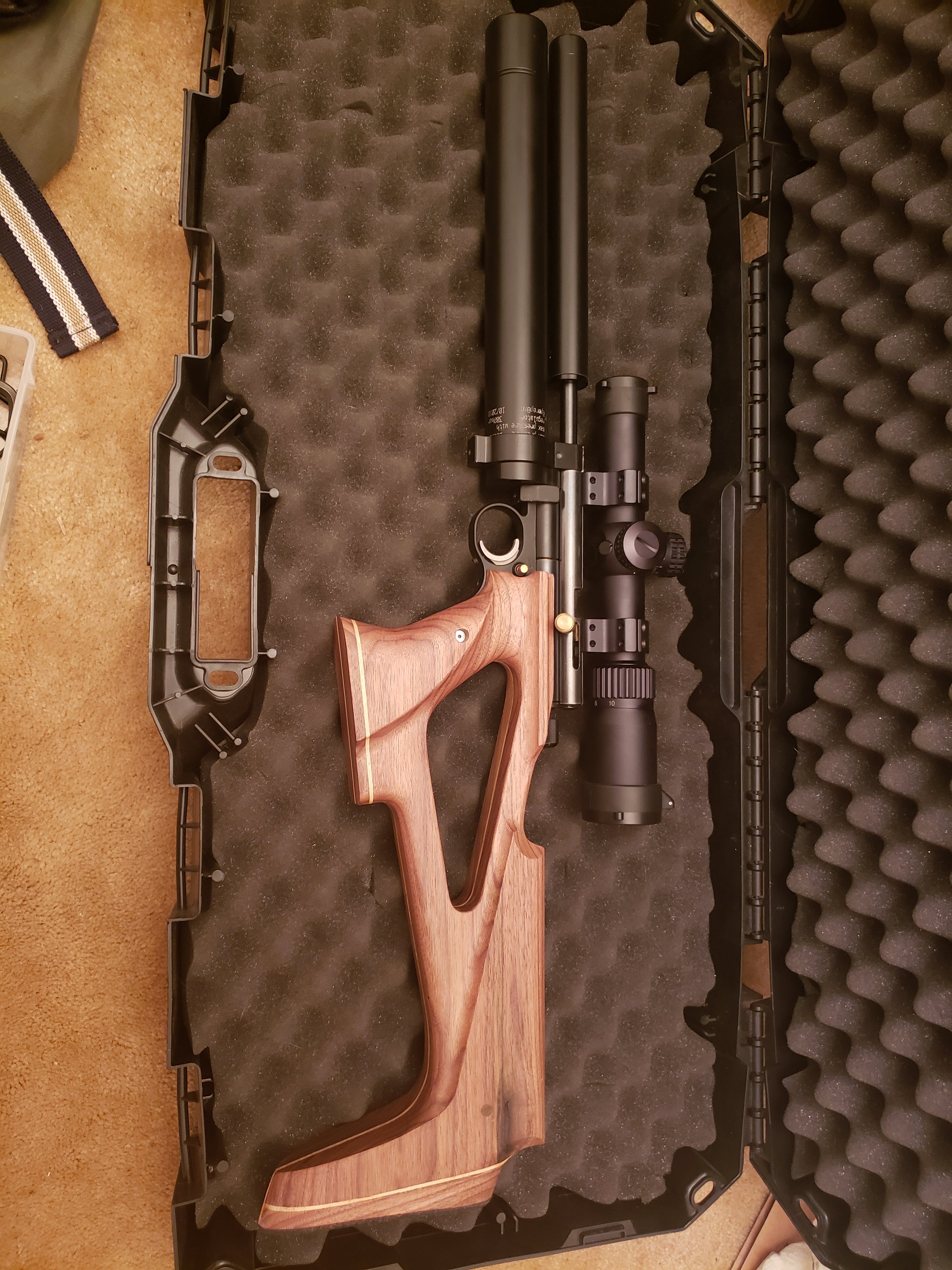

Here's my two crosmans. Both 1322s. Wouldn't go back and do anything any different on either, though they both wound up being quite expensive.

Can you tell us more about the pcp conversion for these? I've seen some on ebay from China but hesitant to order one... or another 13xx because of the money pit they become.
Everytime you post a pic of that one I friggin drool it's awesome. I even downloaded the image and look at it often. Before you say it, yes... yes I have a problem!

You can look around on the net and find a wide variety of them. Some just screw in, others replace the entire valve and require cutting the tube. They're pretty cheap, respectively. The thread in ones that use the factory valve, you need to do your homework on. Some of the tubes are safe to use, some are a bit sketchier. I've never done a 22xx, so I don't recall the specifics, but have certainly read plenty about it. If using the factory valve, you need to pin it to the tube. But for a factory gun, I know I could personally convert it to pcp for under $100. That's not to say it will be tuned well or will be accurate, though.

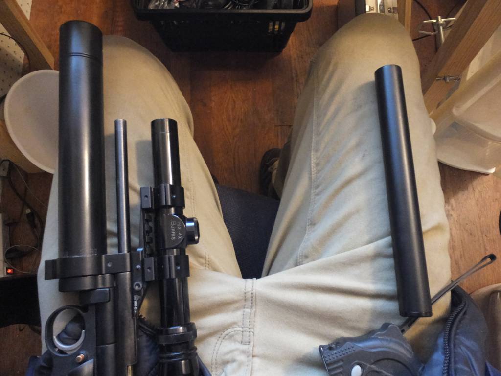

The 1322 conversion I have is a krugergun conversion kit from russia. I was sold it from the country of georgia, and they are still available on ebay or on airgunbuy website, but are not quite the same. Mine came with a very nice shroud, and precisely machined baffle stack that works extremely well. The baffles thread together inside the shroud. Actually has an airstipper that centers on the barrel and uses the rear of the shroud for sound dampening, too. I requested a shorter 200mm airtube at the time, and the seller was able to get me a 220mm tube, which now has a custom huma regulator, and I took the original 290mm tube that came with the kit at the time as well (at my expense). The barrel is a crosman LW barrel 14.5" chopped to 7.6" and re-chocked specifically for AA 16gr pellets by WHITEFANG (RIP). Like this, does nearly 100 shots at 15fpe.
Uses a marauder pistol trigger group, and some other custom bits.
Current one is 270mm, so 50mm longer than mine.
