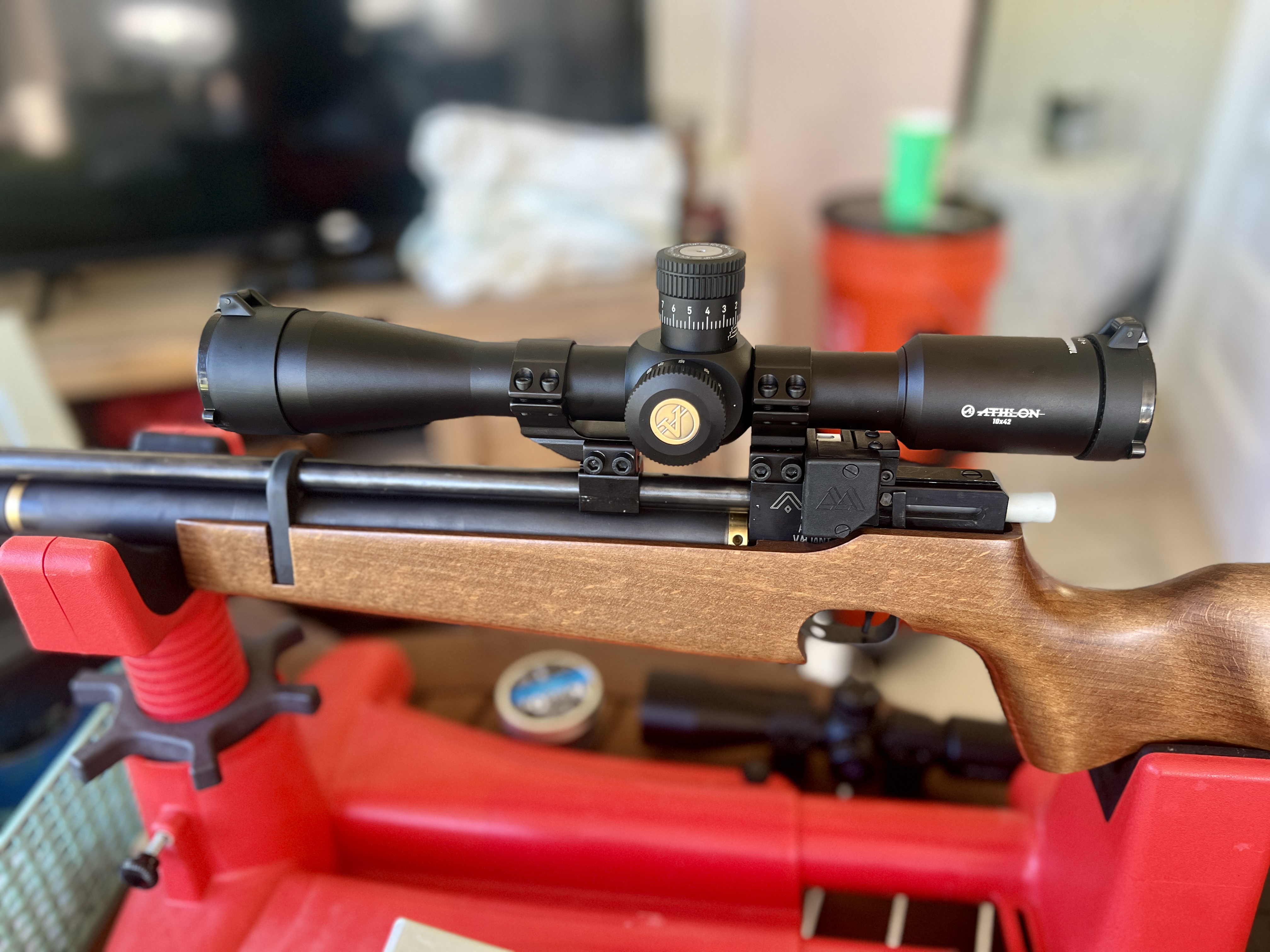

I received an Athlon Talos 10x the other day. I decided on that one because I really like the moa reticle. I was able to mount and zero it today. Very much an upgrade from the compact Veyron 10x that was on the rifle.
