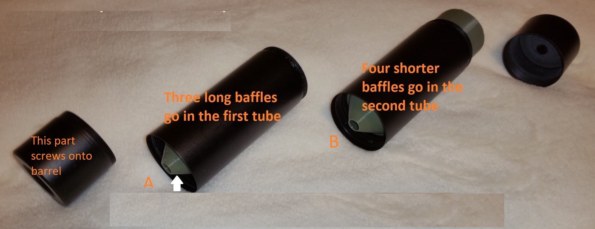

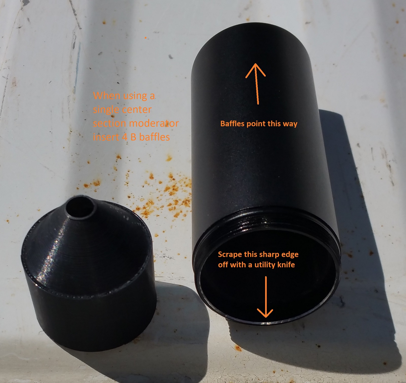

could i please ask how u reached up to 130 fpe? mk2 with 720 power plenum and heavy springs, coils, hammer etc here! oh and im a shortie compact as well!3d printed cones are best with nothing else. Here's a link to download my files for .25 caliber or less. They can be used for .30 by opening the hole with a step drill. Two 75mm long center sections work best for higher power guns. This double center setup made my 132fpe impact as quiet as a 30fpe .22 until the slug hit anyway.
https://www.thingiverse.com/thing:4914398 longer baffles
https://www.thingiverse.com/thing:4914370 shorter baffles. Follow instructions in the pictures.
View attachment 269957View attachment 269958

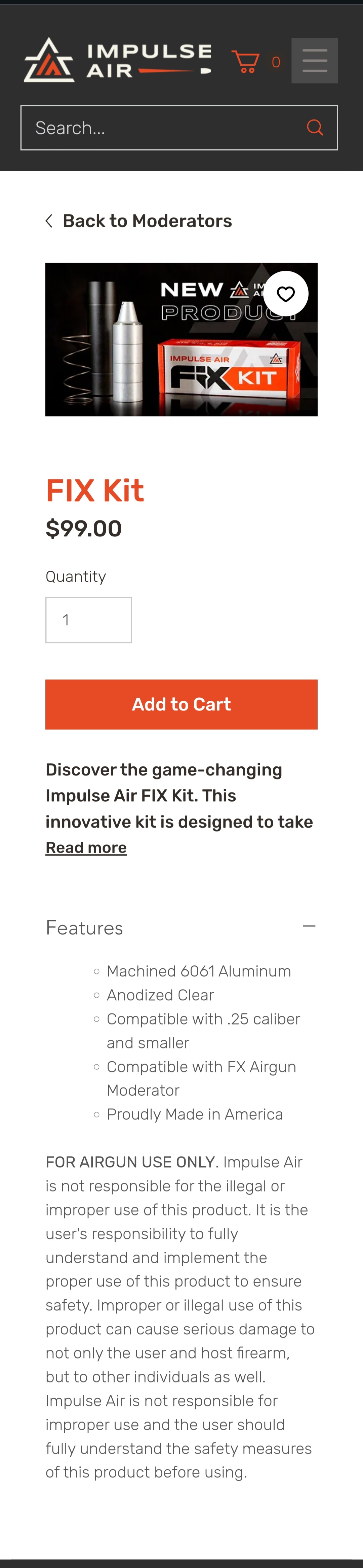

They are aluminum and anodized. But printing baffles is dirt cheap for just the cost of the filament used. I have a cone baffle design that each baffle screws together thats just over 2.0 OD and thats less than $1.00 per baffle to print for just the raw material. I dont know how much the electricity cost to print it but thats still pretty cheap even including the power.Just give the dimensions to one of the guys who print moderators and he can make you those baffles for about $5.00 each plus shipping.
Sheese $99 bucks?![]()
