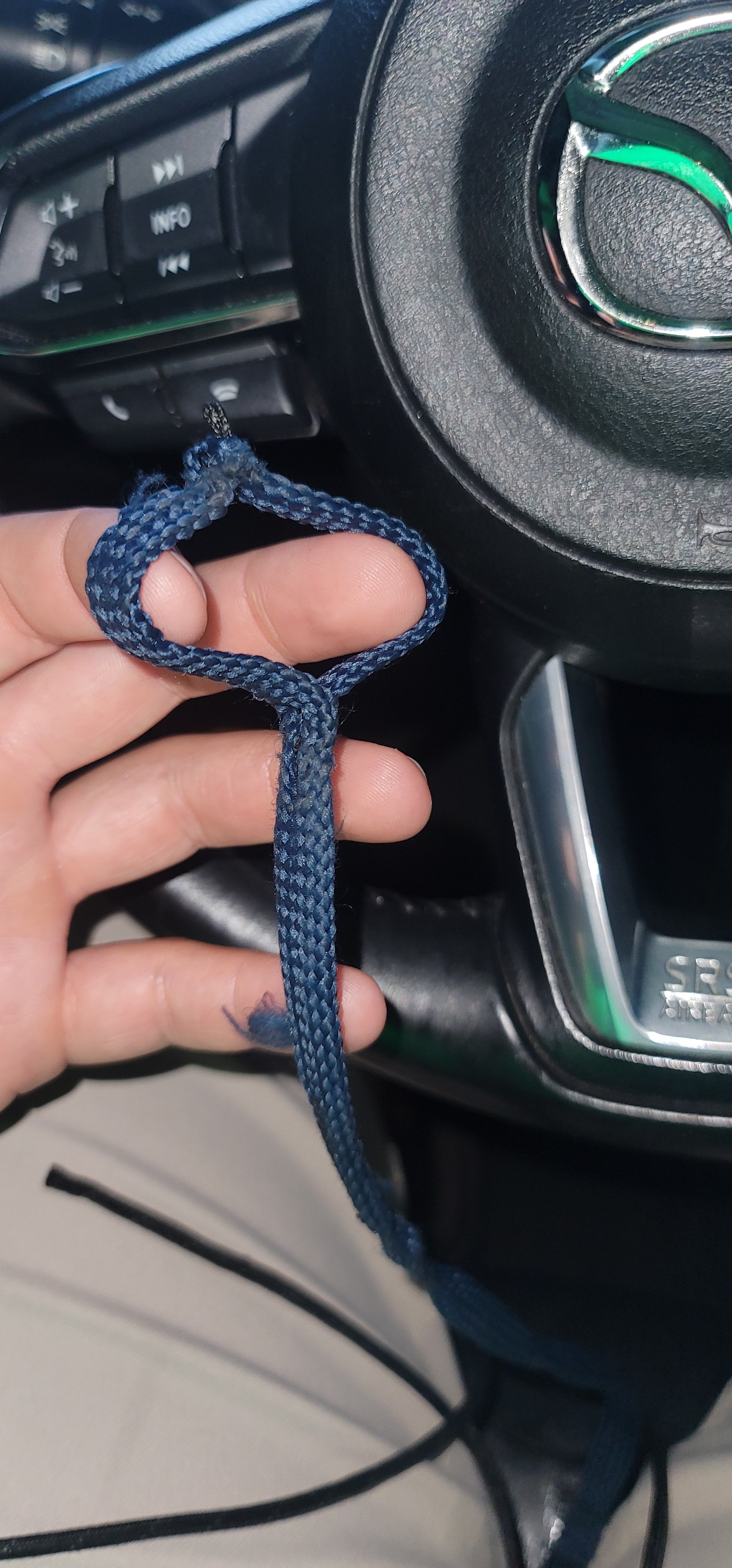

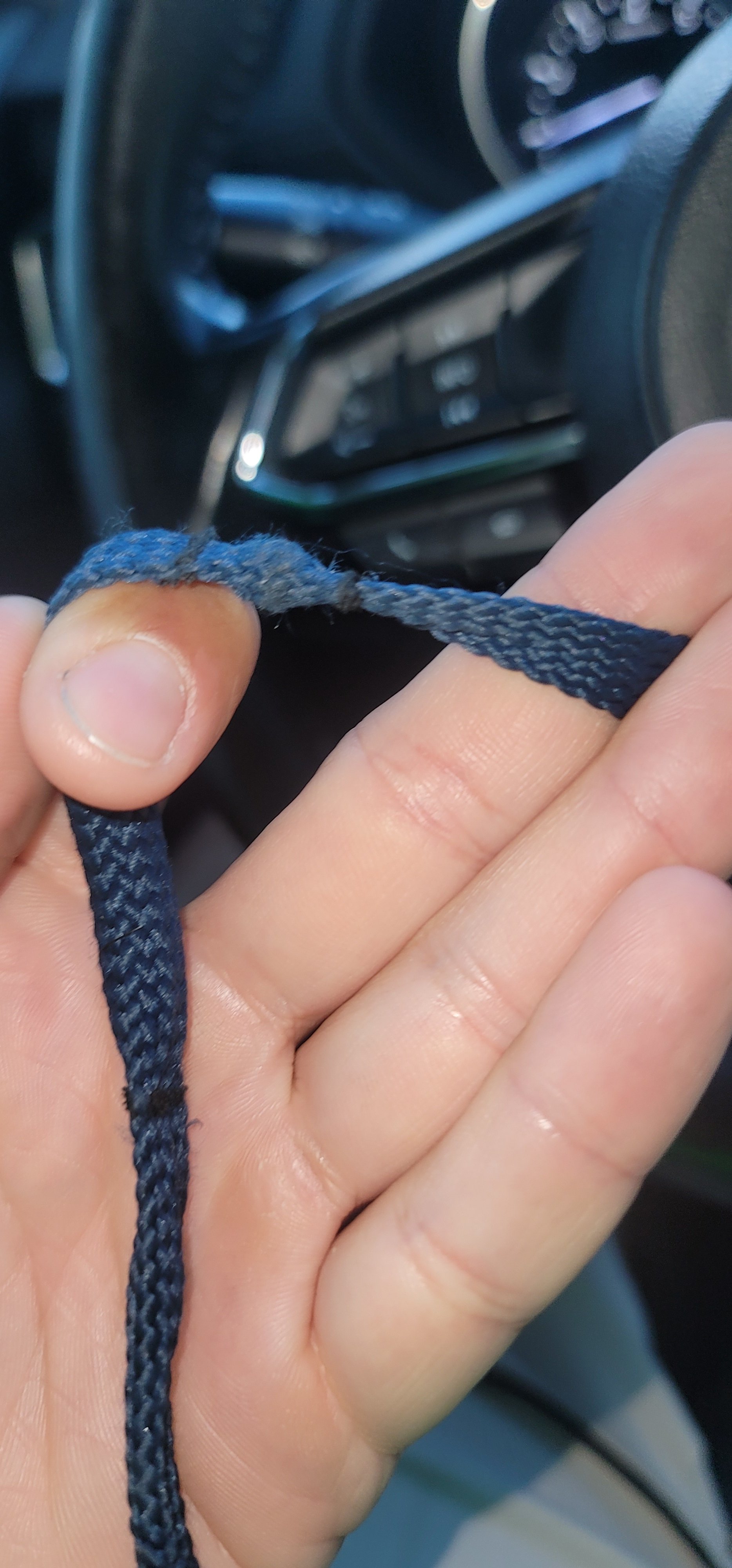

This is another item I use for a cleaning the barrels. It's made and sold by BALLISTOL not HOPPES. It's almost like the snake rope for powder burners, but there is no metal bristles on this.There are rubber balls inside of the cord and it does a fantastic job at cleaning whether it's dry or with a few drops of ballistol.
Also no patches needed.

Clever product, but, cleaning patches you can just throw away when dirty, how do you go about cleaning that rope without exposing yourself to a ton of tiny lead particles?

The first two and a half feet of this is just a paracord which falls loosely inside of the barrel.
You can grab it with a set of gloves and pull through although they barely make enough contact to really get lead on it.
The main points of contact will be the 3 balls spaced out about 7-8" apart and the last inch of it.
Whenever you're done with it you can wash it with lead soap. It also comes in a carry case to store it in.
