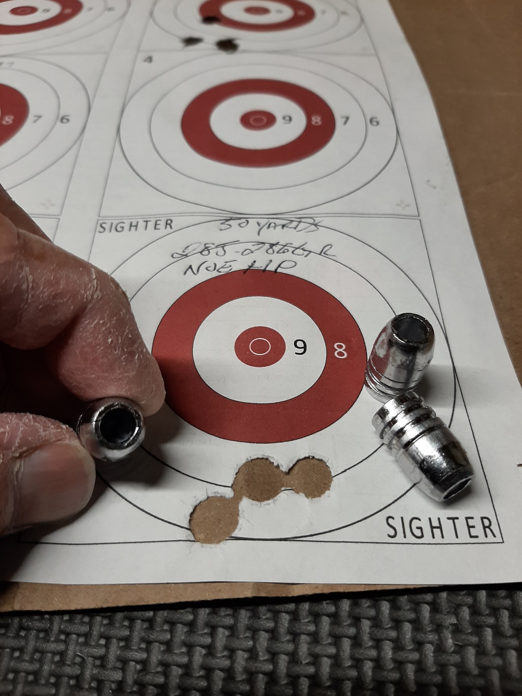

I use this mold in my .457 Texan and at least out to 50 yards, it competes well with premium slugs. Past that, they fall a little short, but for S&G's, and just to get trigger time cheap, slugs out of that mold are just fine.This is a great start, plus affordable:

Works amazing in my pbba .457 and another guys texan .457 I seen on YouTubeThis is a great start, plus affordable:
