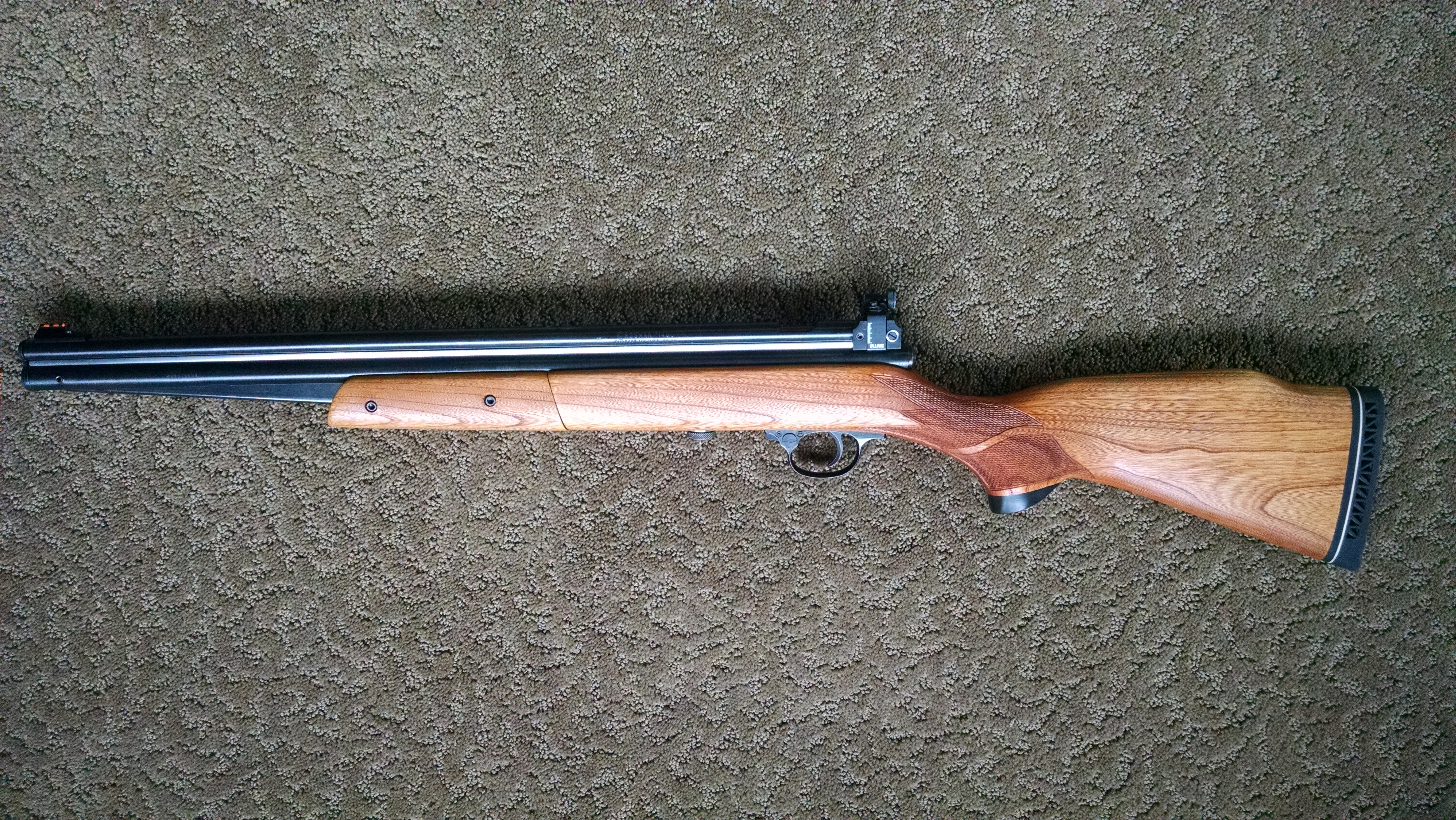

I couldn't resist posting a pic of my custom 1400. I drilled and tapped the action for the Williams peep sight.
These really are nice, solid, and efficient pumpers. Pretty easy pumping, for the power you get.

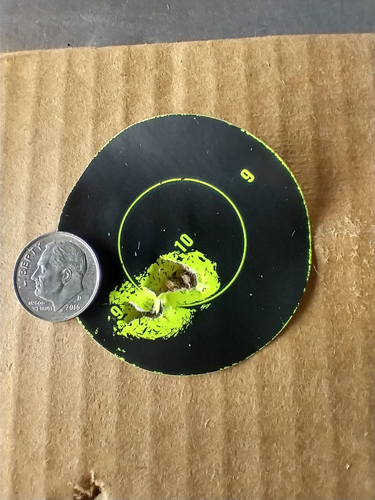

I bought a Crosman 362 on a whim and am glad I did. I purchased the steel breech and installed it myself. I am shocked at what a solid,tight little rifle this is. After a good barrel cleaning and 100+ shot break in,I'm getting dime size 5 shot groups at 25 yds. Internals are stock except for some trigger work. Ten shots at 8 pumps over the chrony with AA Falcon 13.43's are as follows. High-670,Low-666,Ave-668, Es-4,Sd-1 !!
I bought a Crosman 362 on a whim and am glad I did. I purchased the steel breech and installed it myself. I am shocked at what a solid,tight little rifle this is. After a good barrel cleaning and 100+ shot break in,I'm getting dime size 5 shot groups at 25 yds. Internals are stock except for some trigger work. Ten shots at 8 pumps over the chrony with AA Falcon 13.43's are as follows. High-670,Low-666,Ave-668, Es-4,Sd-1 !!View attachment 399052View attachment 399053
Thats impressive dime size groups at 25 yards.
