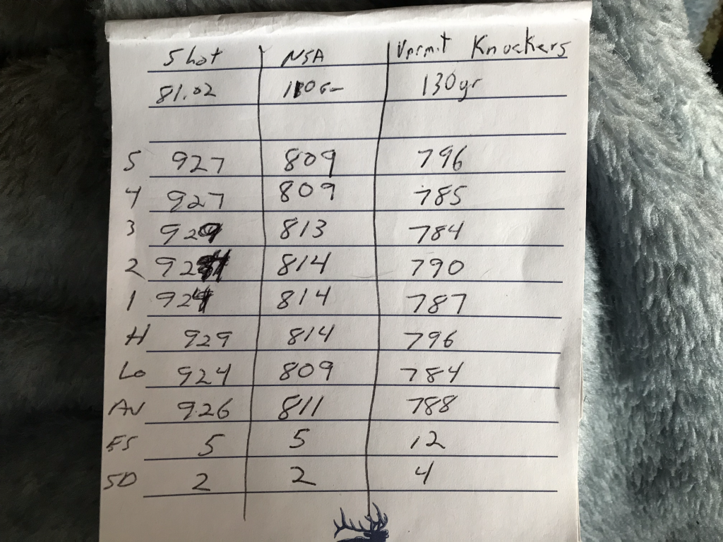

Here are my results with mine tethered, it only has the DePinger and Moderator added.
1562385796_20755094265d201d84a57721.60100036_F27A60E4-9597-4FBF-8650-5268DC5228F7.png
