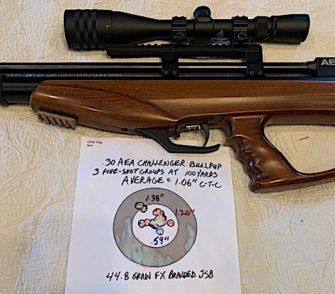

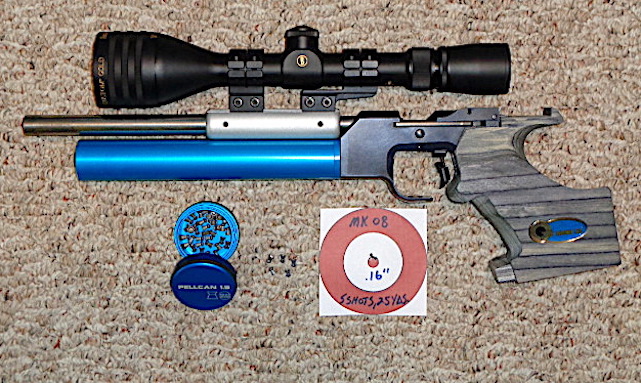

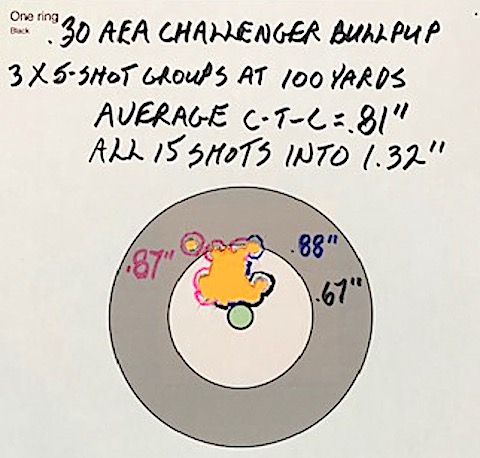

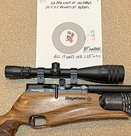

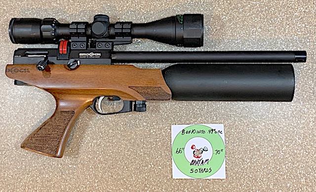

The best place to start in any accuracy quest with any caliber airgun is JSB pellets. More specifically, light-for caliber JSBs in modest-power guns, medium weight JSBs in mid-power guns, and heavy to super-heavy JSBs in powerful to extreme-power guns.
This is not conjecture. Rather, decades of experience testing hundreds of airguns.

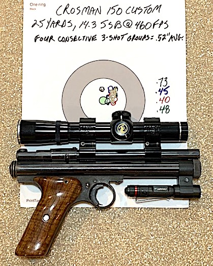

Simply stated, like JSB pellets, Huma is the best. By the way, FX, Air Arms, and Daystate Rangemaster pellets are JSBs. To quote The Voice Of Experience, "The best place to start in any accuracy quest with any caliber airgun is JSB pellets."

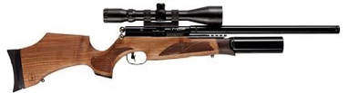

A buddy has a .22 BSA R10, and I found it one of the most accurate airguns at 50 yards I've shot... with 18.1 grain JSBs. Here are my testing notes-
.22 BSA RN10 PCP bolt-action repeater, courtesy of Dave W.
18.1gr JSB Exact, 3400 PSI, 43 shot powerband- Low= 827, High= 850, ES= 23, SD= 6, Average= 835 FPS/28.0 FP.
This rifle was tested brand-new (no adjustments or tuning). It was incredibly accurate!
