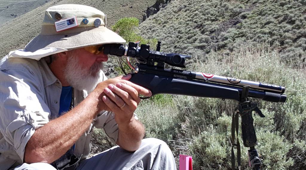

Have used quite a few different scopes in PFT in recent years. Personally have found that an older HAWKE panorama 4-12x50 AO with 1/2 dot 10x reticle is simply the cats meow !
The AO parallax focus is very well defined in the 10-35 yardage, image bright and clear, reticle tight and well defined w/o being too busy.
Scope mounted as far forward as you can ( offset rings ) reduces the eye relief relative to your grip / hold on pistol.
After years of shooting PFT and fortunate to have won 4 state PFT titles it is of my opinion HOW YOU HOLD, SIT & ESTABLISH A STABLE POSITION to shoot from is more important than the optics used.
