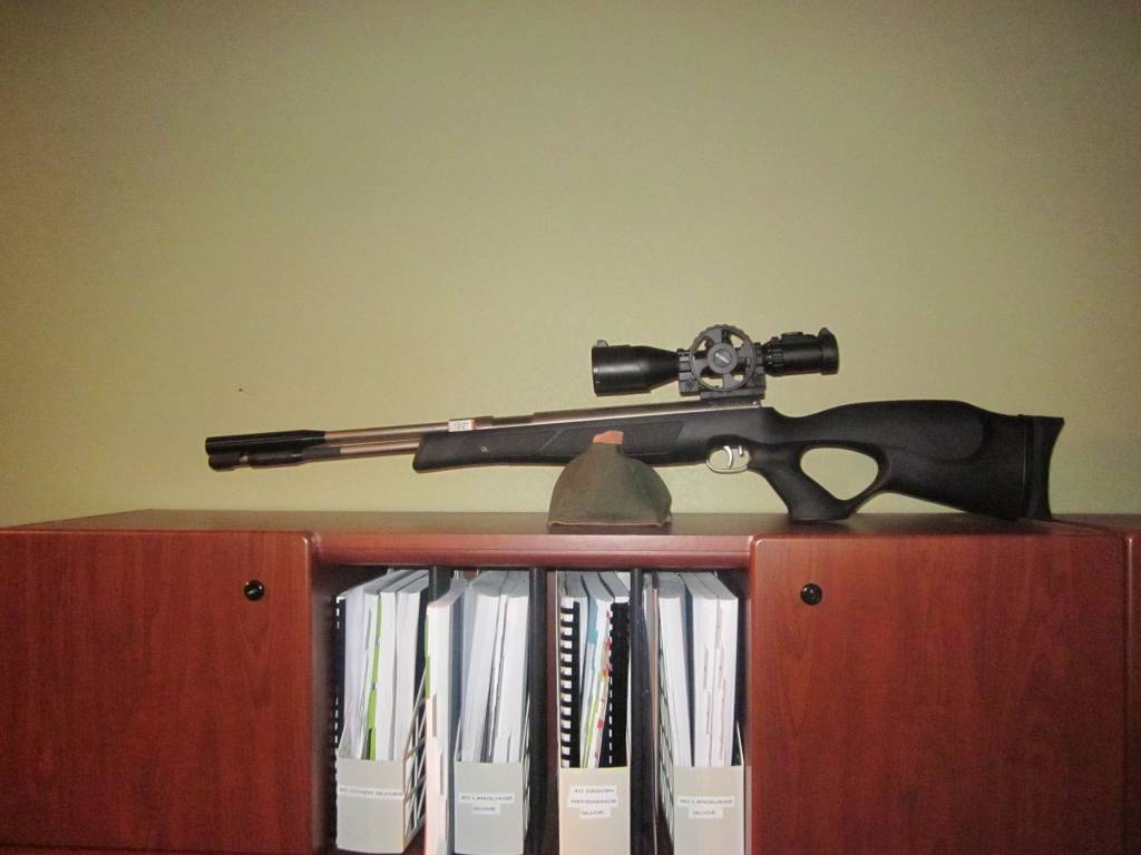

I had a blackline great gun but for HFT unless you want to add an adjustable butt plate yourself which isn't a huge deal I would get the wood one that has it already. I wouldn't shoot HFT without an adjustable butt plate first thing I did with my 97 is replace the plate it came with. I would also get a cocking aid from Rowan Engineering in the UK as well and probably one of their set back triggers as well both will really help. If you REALLY want to kick up notch they get a customFT stock from the UK you'll see a bunch at the match no doubt.

Did you see this pic from another post? Nicely set up 98 for HFT!
