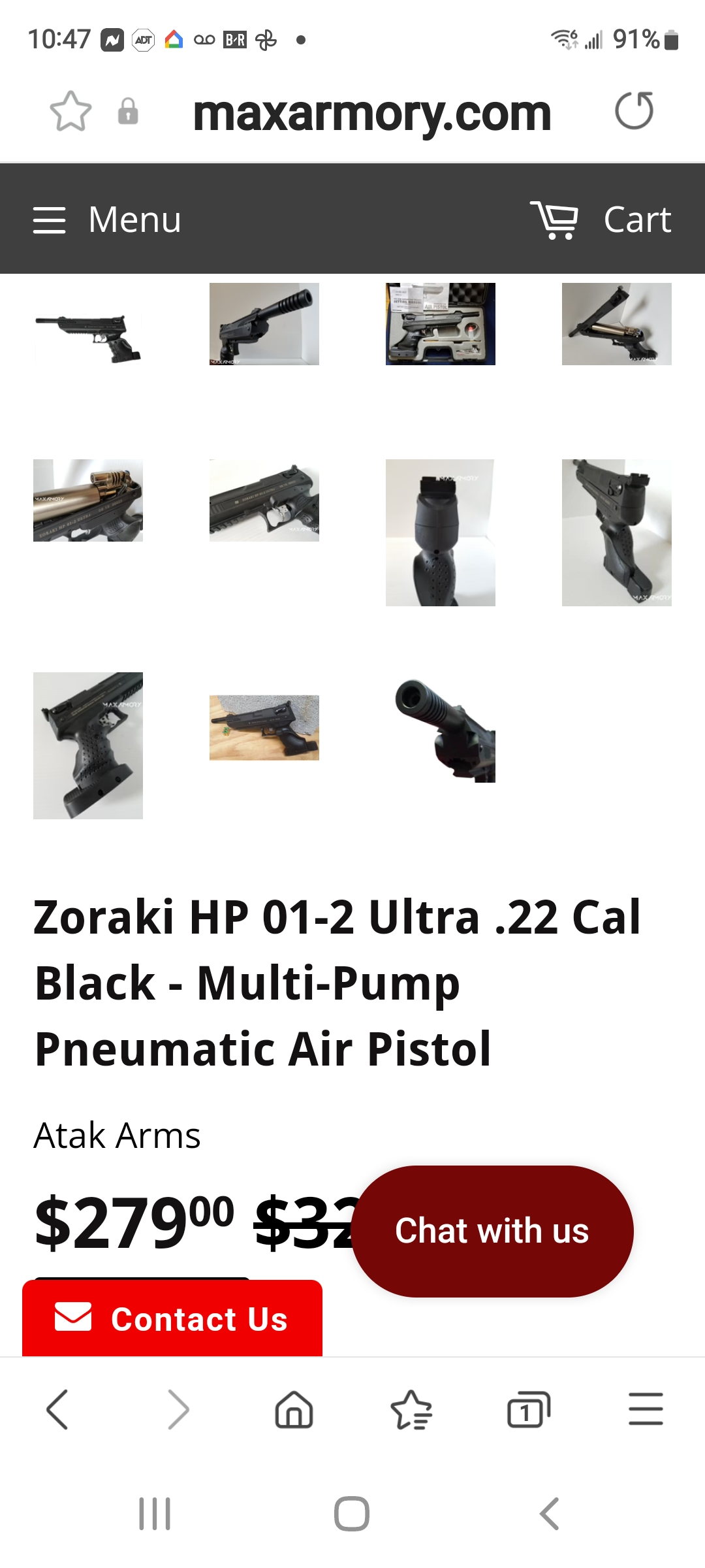

Take a look at the Zoraki ultra or the short one. 1, 2 or 3 pumps depending on you power need. Custom grips and lefty available. Hard to fine a more accurate hand gun for your stated needs. I pest sparrows @ 35 yds on 3 pumps in .177 with jsb 8 4s. Your choice .177 or .22

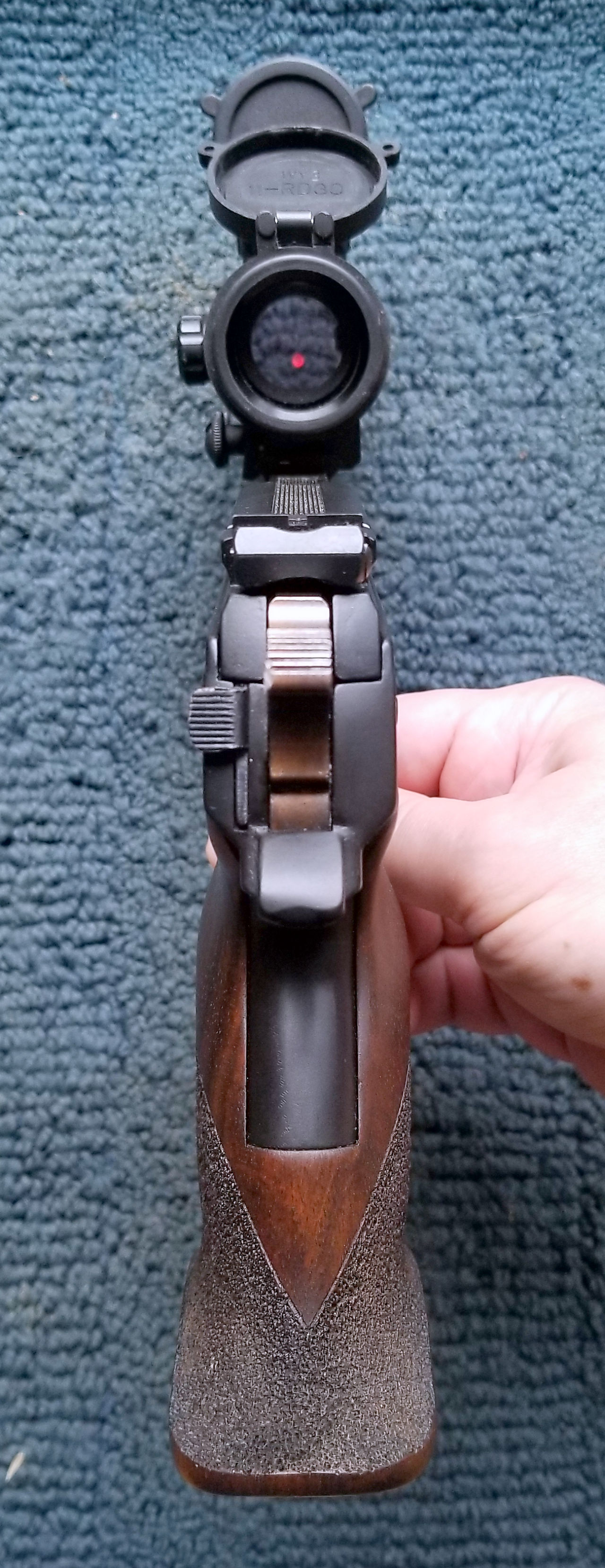

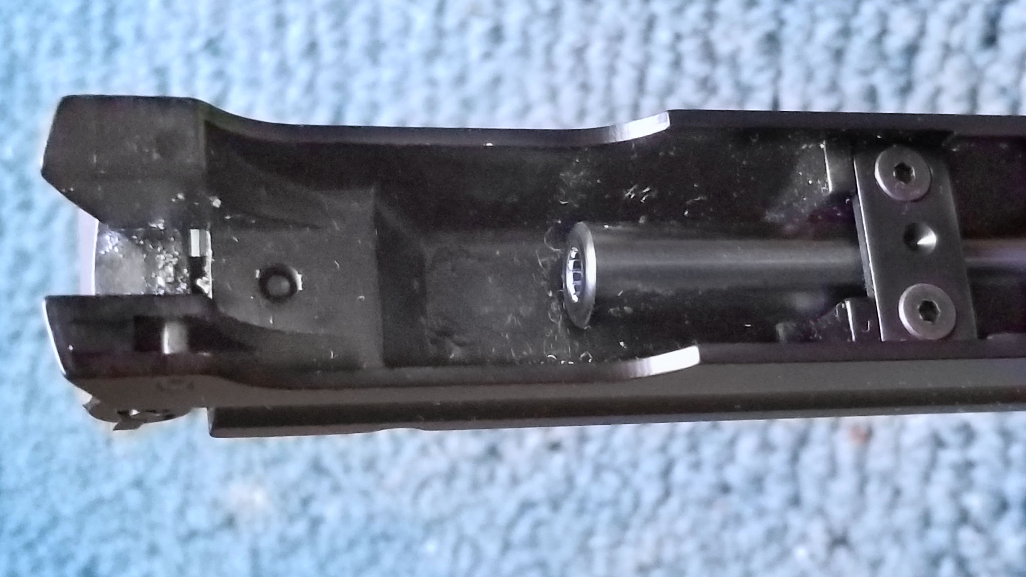

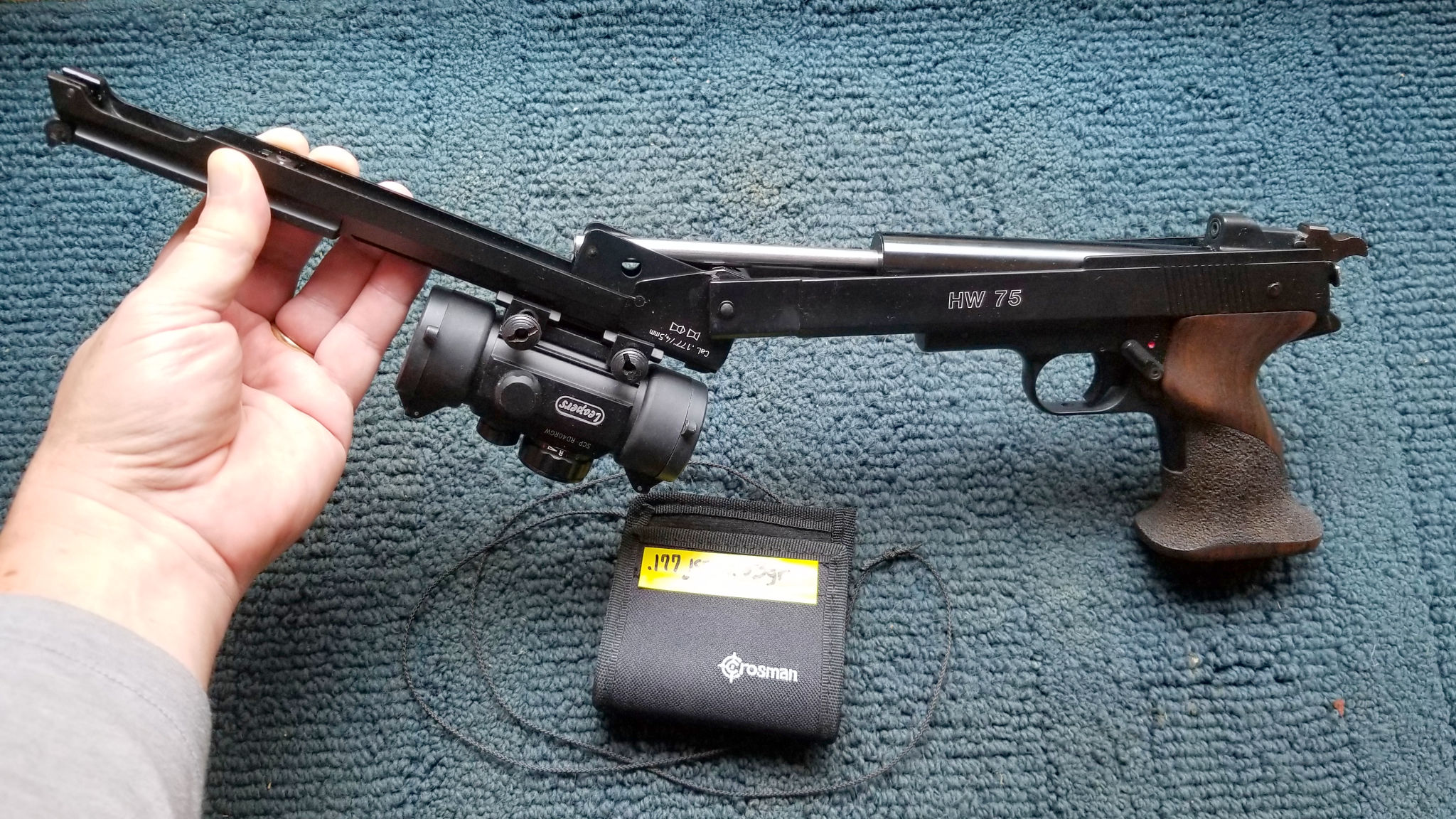

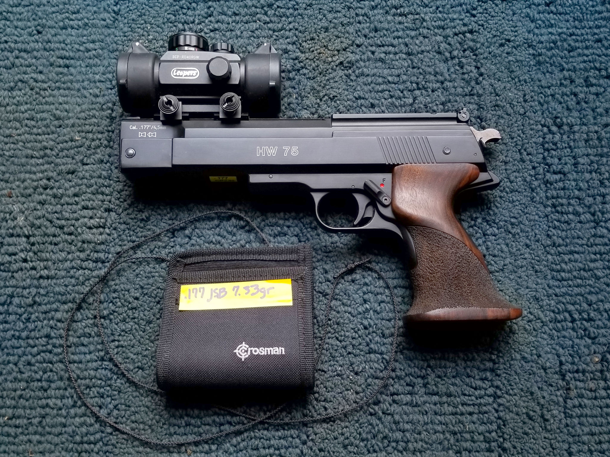

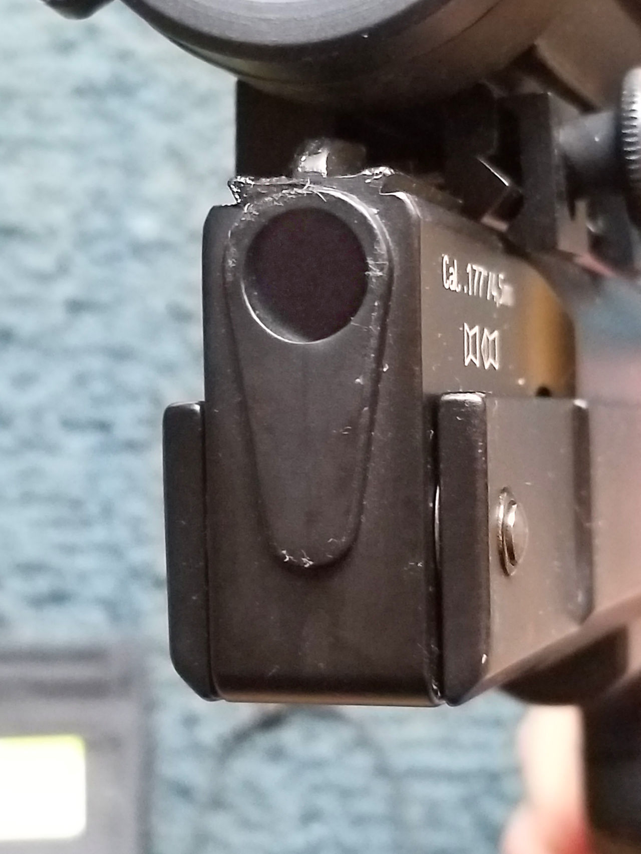

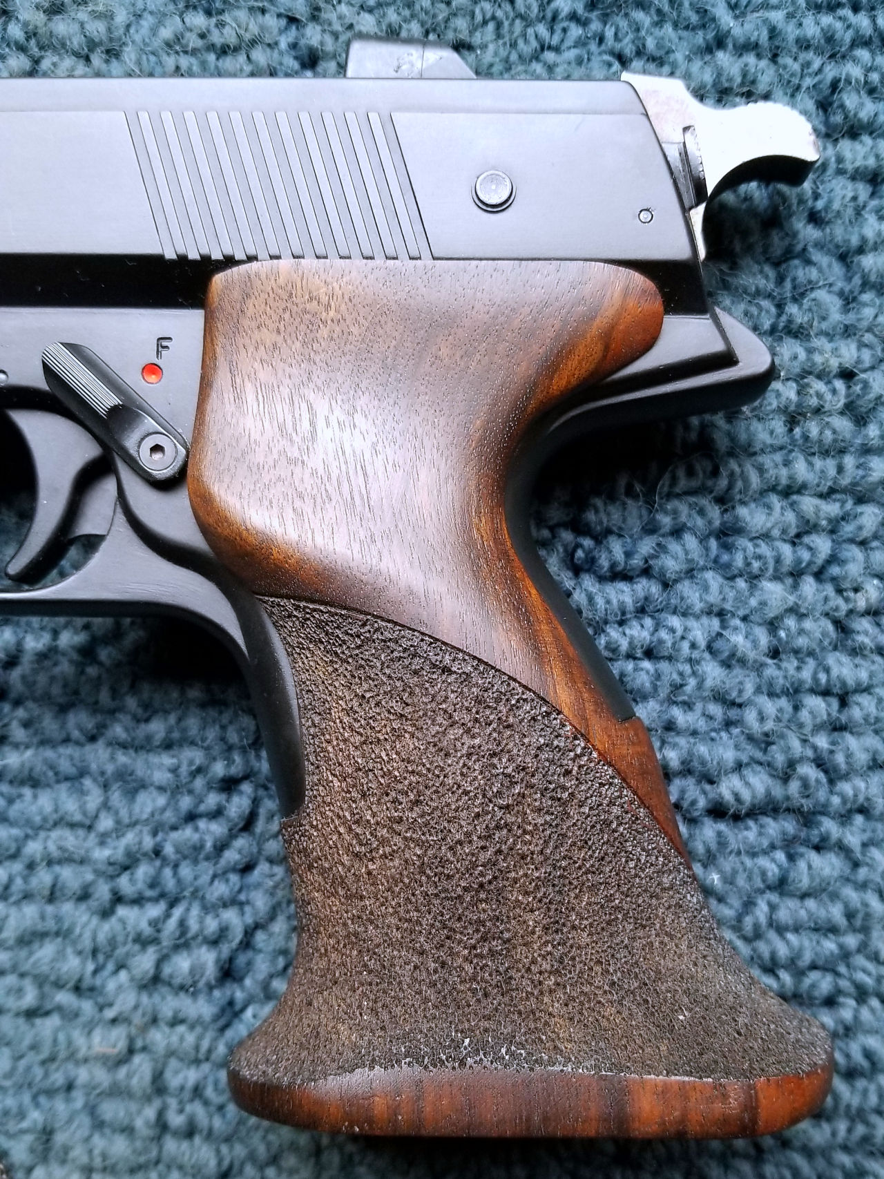

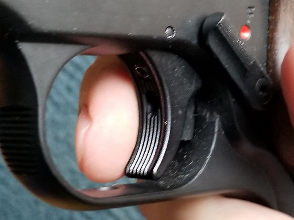

If you fancy a nice pistol, the Weihrauch HW75 has a superb 2 stage trigger with a short and light 1st stage takeup, followed by a crisp 2nd stage with no detectable creep. The trigger blade itself is nice and wide and grooved, feels like it has a shoe on it. The muzzle is recessed in the top strap frame and has a relatively low muzzle report. It is a single stroke pneumatic. After charging and closing the top, you cock the hammer manually. The stippled grip is very comfortable for ambidextrous shooting. You can cock the hammer and dry fire it without opening the top strap and pumping it. This feature makes it ideal for dry fire practice.
The breech area is roomy for loading and notice that the rear of the top strap has a generous notch, allowing you to easily inspect or clean the bore when opened. If you look closely, you can see where I chamfered the breech lead in slightly to ease loading.
It makes a little over 400 fps with JSB 7.33 gr pellets. I zeroed mine at 15 yards. You can use it for practice with the iron sights but for more precision, I like a dot sight. I used the UTG dovetail-to-picatinny adapter inserts for this dual color red / green dot sight. A newer type , lighter reflex sight might be more appropriate.
You can punch paper or cans at 15yd with it, or take down english sparrows from your bird feeder but there's not enough power for much else. I liked it so much I gave away my p17s to my nephew and his two boys.

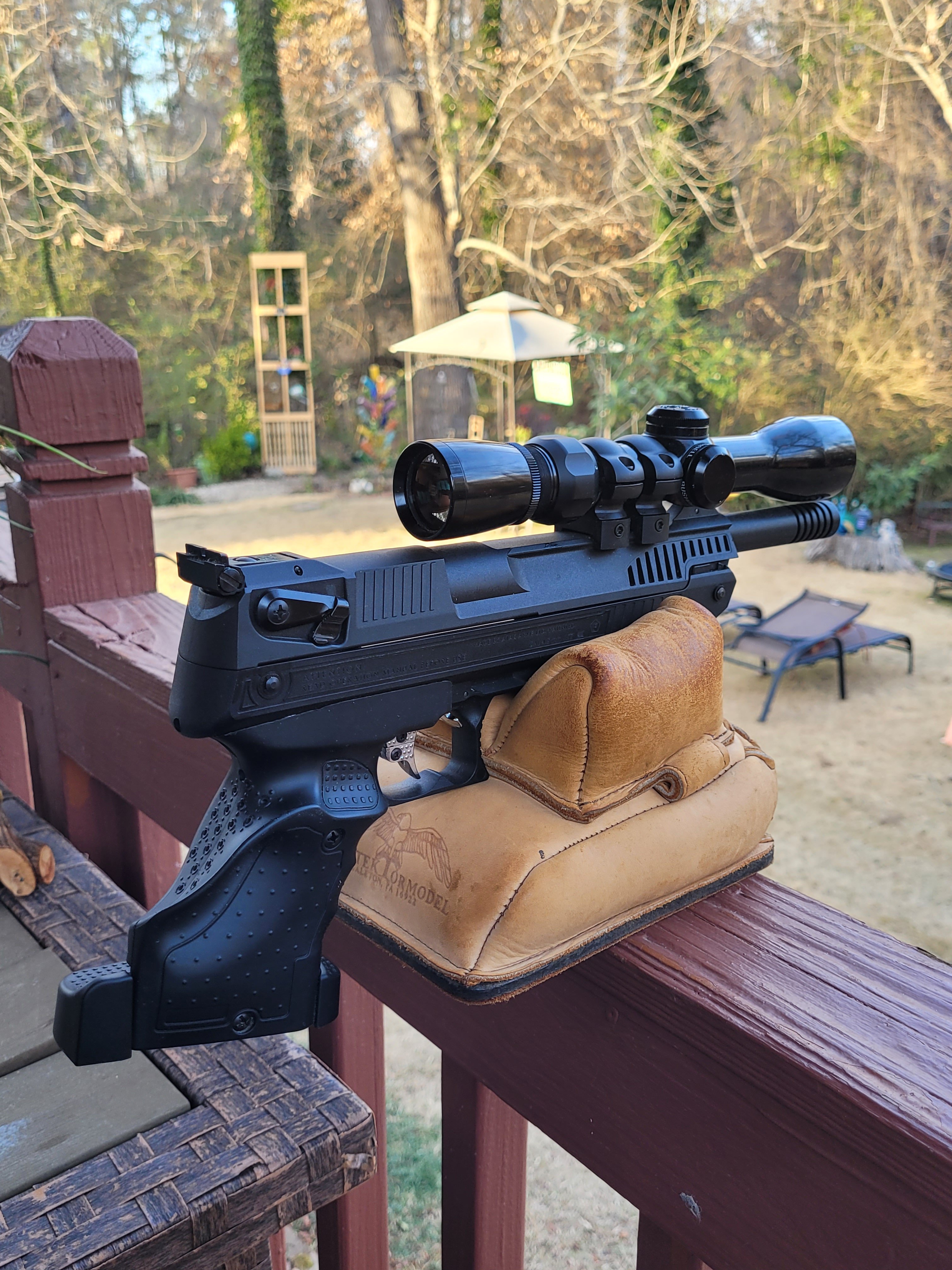

I have a Zoraki 177 ultra with the extended barrel. It has a sharper muzzle report but is a good plinker on low power (one pump). Its plastic frame doesn't feel as sturdy as the HW75 and its rear sight screw frequently tries to back out when you push down in that area while closing the top strap. You can pump It three or four times to generate some good hunting power but then it gets *very* loud. The trigger pull is long and is nowhere near that of the refined unit on the hw75! On the plus side, you can order a shoulder stock for it from the importer. Donny FL used to sell a slip-on adapter for the barrel. You remove the plastic cover that has the grooves on it in the picture that someone else posted above, and you can slide on a threaded adapter, secured with a set screw. My adapter was just a few thousands too small and I had to do some light machining to get it to fit though.
Pics below.
Feinwerk

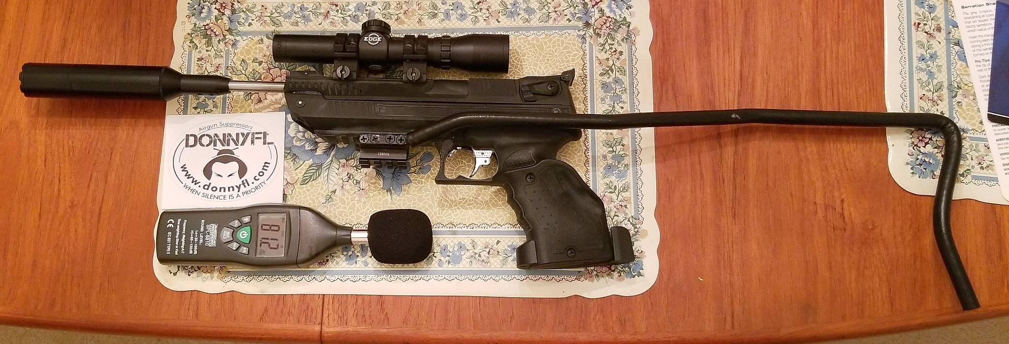

My Zoraki 177 (originally sold as a Webley Alecto Ultra) with homemade wire stock (not that great) and Donny FL Tanto:
