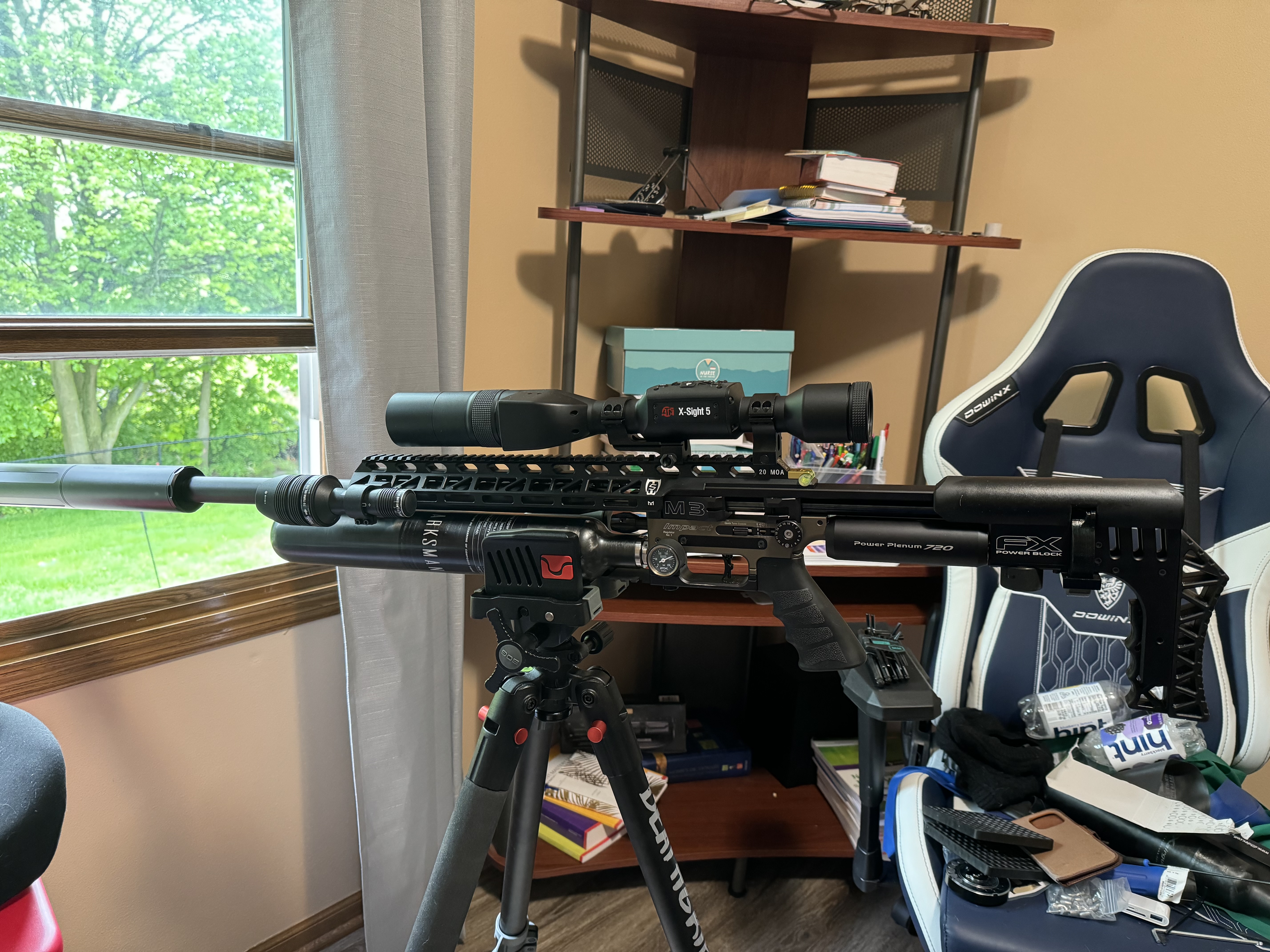

Looking for a moderator for a new .22.
I bought a cheap buck rail for $50 delivered and it has a distinct ping at every shot.
So... give me your advice please.
I know bigger is quieter but, how big do I need to go?
Shooting 34-40 gr slugs at max setting on a stock gun.

HUMA moderators have worked the best in most of the airguns I use,.otherwise go for an STO moderator. The website name is Silent Thunder Ordinance
So, it depends what you’re looking to get out of it. If you are looking to use this more as a fixed position sniper rifle and want max silence then the impact shroud works great, combined with the extension (which is a 6” long expansion chamber and a ronin at the end of it. I have a custom made STO, tried the emporer v3 with and without extension, I had the stock fx moderator, and I’ve got a Yokozuna. That’s all I can think of at the moment. Anyway with my impact nothing works better than the ronin with extension. It’s about a foot long. That would be allot if I were running and gunning. But I wanted the absolute quietest setup possible bar none. I shoot my m3 .357 all hours of the night hunting with my wife asleep in the master bedroom down the hall from my office of death ;). She never hears a thing. Says sometimes if she listens for the shot all she can hear is the “click” from the gun being cocked. From my point of view as the shooter it makes that big .35 cal an absolute joy to shoot. The impacts are considerably louder than the shot, so I try and watch my backdrops but my NSA slugs are pretty hard, and will go through any animals skull and hit the tree behind it. Anyway, hopefully my compulsion in spending on silence has helped you in some way. I in the future won’t buy another moderator without a large expansion chamber. Makes a huge difference… someone already recommended Huma Air. I would very much like to try one of their mods.

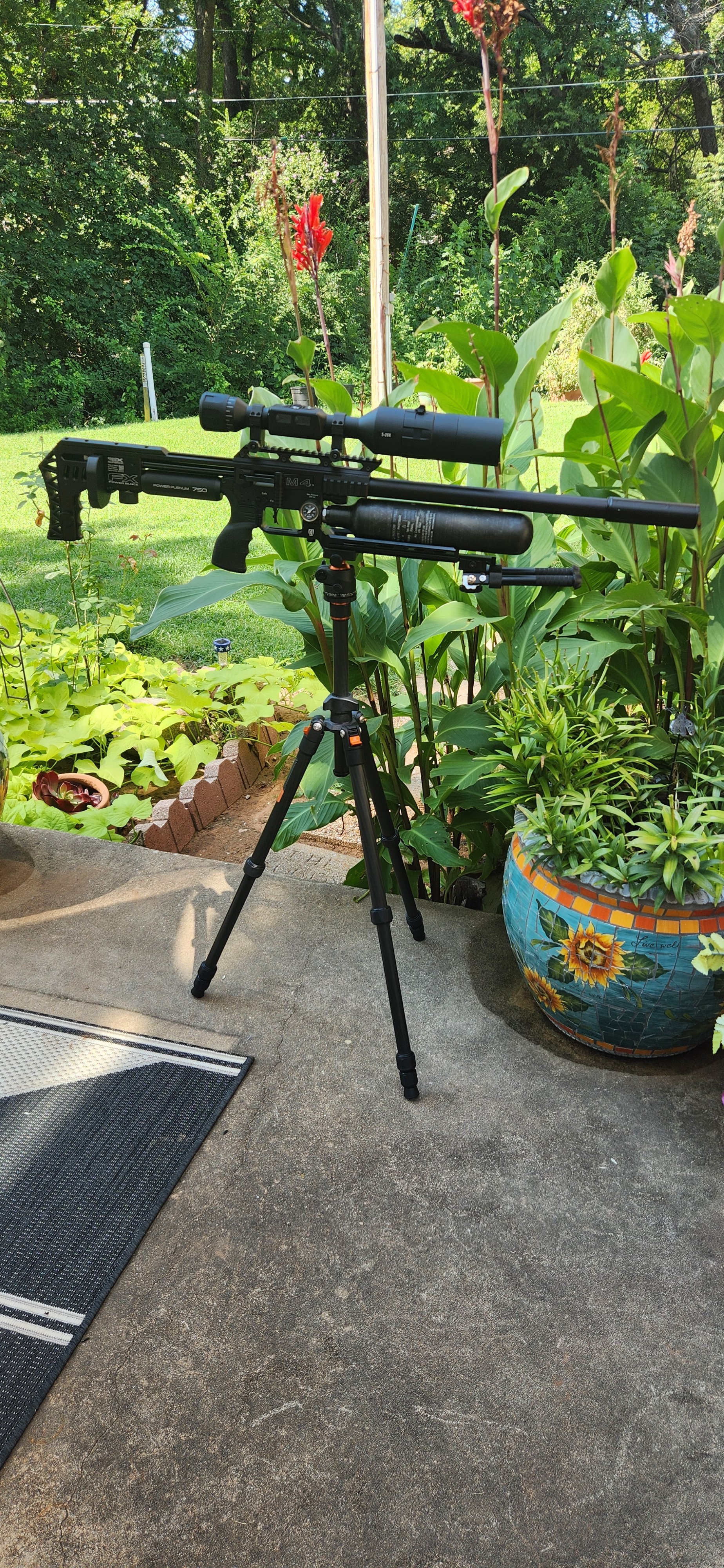

Also, I see you are using the KNF is it? The Tripod? It keeps coming up on my Amazon feed for a new tripod. They look super cool, definitely adds to the flavor of your gun I’d say. How is it? Do you get any flex in the legs? Stability? I use a death grip. Works pretty well as it’s heavy, and my gun or at least that gun is stationary.
