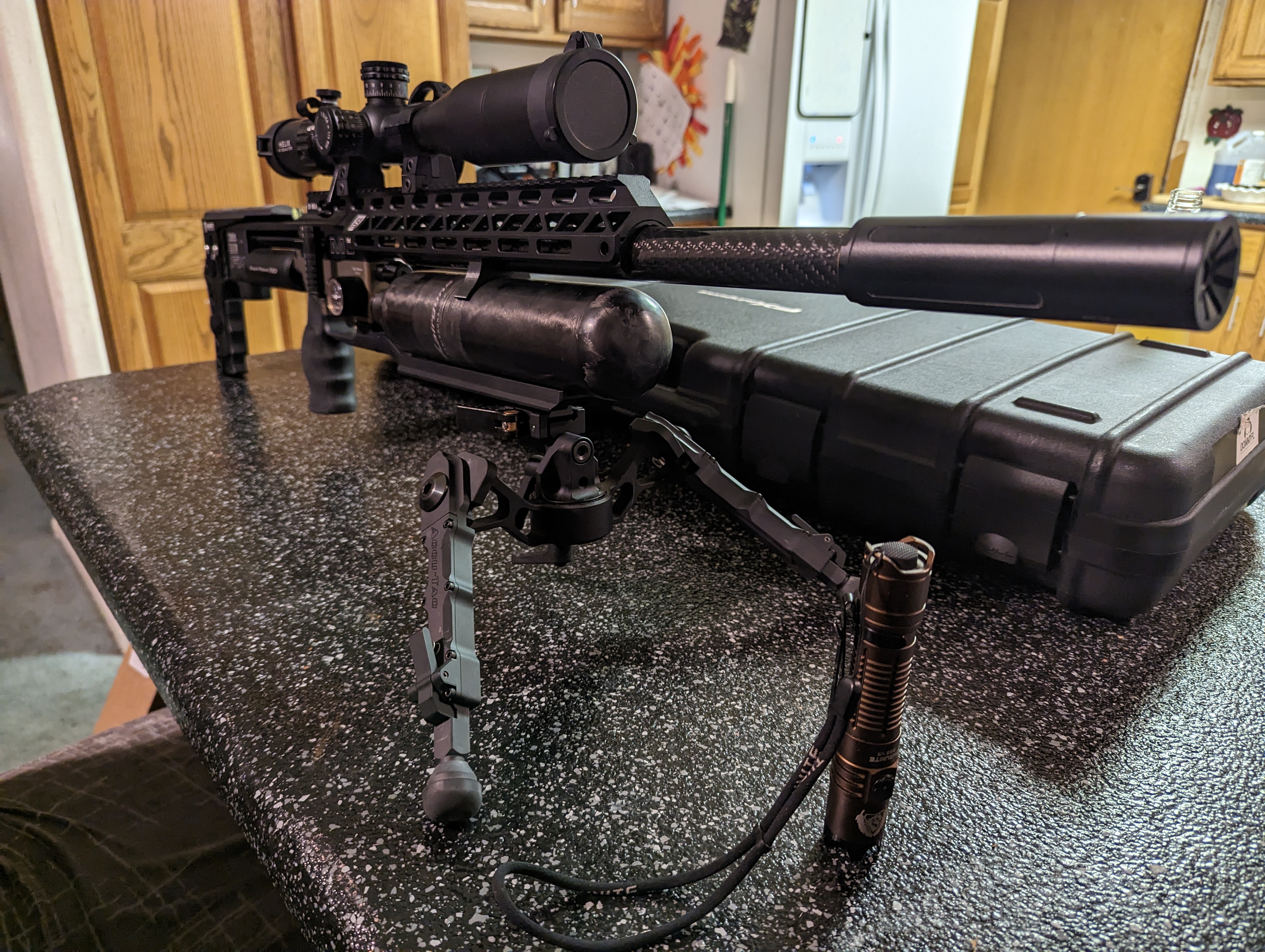

The Taipan Veteran is known to be a solid platform, howbeit not very popular, especially for slugs. I feel like I hit the jackpot, though, because the 700mm CZ barrel that I installed on mine liked the second slug variety that I tried in it....2165" NSA 24.8 grainers.
They are doing sub 1/2" groups at 50 meters. From what I've read it's pretty uncommon to achieve that performance so quickly and so I'm going to settle with these and leave it alone. No more tweaking something that's this good...feed it air and lead and have some fun!
