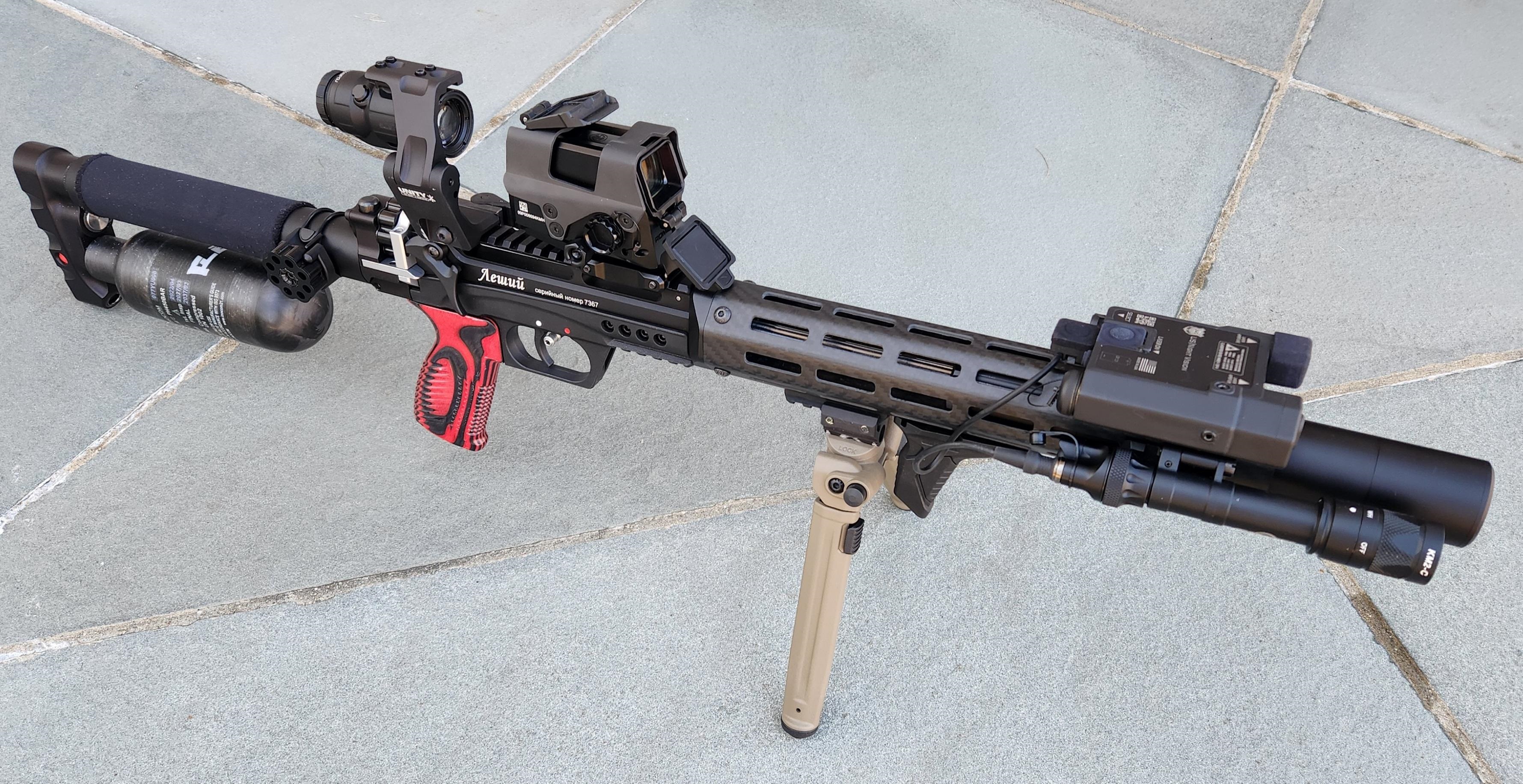

Best Slug for Leshiy 2 .25 Cal
I recently acquired a Leshiy 2 .25 and tried multiple slugs (not pellets) and two seem to stand out, ZAN .253 Cal 38gr and the JSB Knock Out 33.5gr, which is a .251 Cal. The problem with the latter is that they fall out of the mag, and the former is a bit too tight but still shoots well. Does anyone know if there is a great .252 Cal slug? That would be the perfect cal for the Leshiy 2.

NSA makes 2 slugs in .254 specifically sized for the Leshiy 2 bore and newer style mags (will not fit the original red aluminum mags). Your mags look like the newer style so the .254 size should work.
Also, I understand there are 2 styles of 33.5gr JSB KO in .25, the originals and the MKII. The MKII has a pronounced skirt that I suspect may fit the L2 mags better than the originals (I have not personally tried it yet).

In my backyard, I have installed targets at 25, 40, 60, and 92 yards, and I practice with different guns. I just bought a used Leshiy 2 with 350mm barrel and as I always do with my other guns I go for hollow point slugs rather than pellets, because I also happen to shoot up to 200 yards with my guns, that is why I don't wanna bother with a pellet. Surprisingly, at 92 yards, the grouping I get from the Leshiy 2 with a 350mm barrel with Zan .254 cal 38gr slugs is really good. That said, you are right, the L2 is a close-quarter gun, that's why I have a red dot and a 5x magnifier on my gun.
Just tested NSA .254 38.5gr, AVS .254 42gr, ZAN .253 38gr, three slugs and JSB HADES .25 26.54gr out of my Leshiy 2 350mm barrel (thoroughly cleaned for this test) at 56 yards resting on bipods and the Zan slug has the best grouping with all the shots within 1 inch followed by the NSA with 1.5 inch spread and the HADES with 2 inch spread and the AVS with 2.5 inch spread. Here is the velocity of each ammo: AVS 693 FPS, ZAN 736 FPS, HADES 856 FPS. The chrono went out of battery so I could not measure the NSA but it should be the same as the ZAN.
