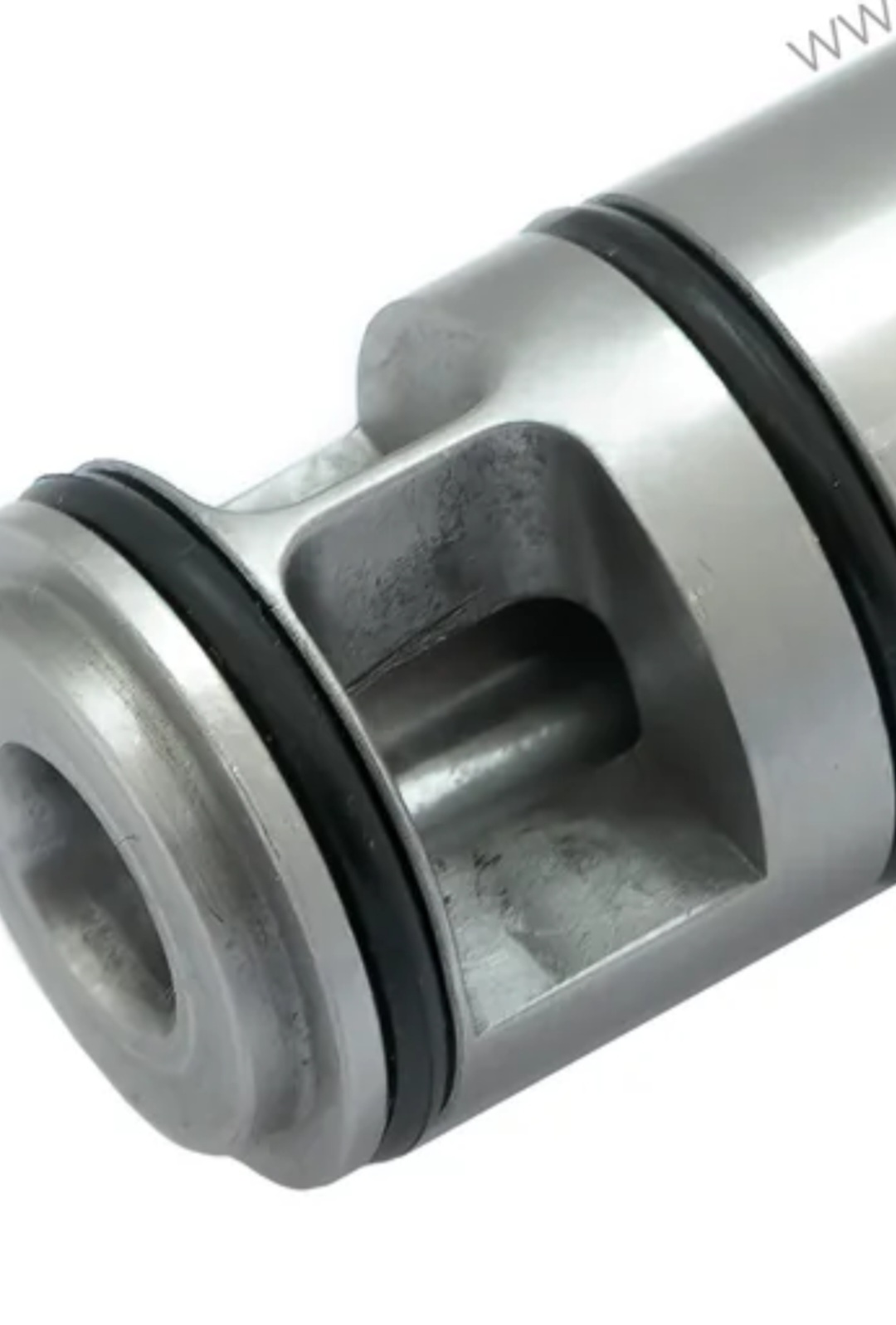

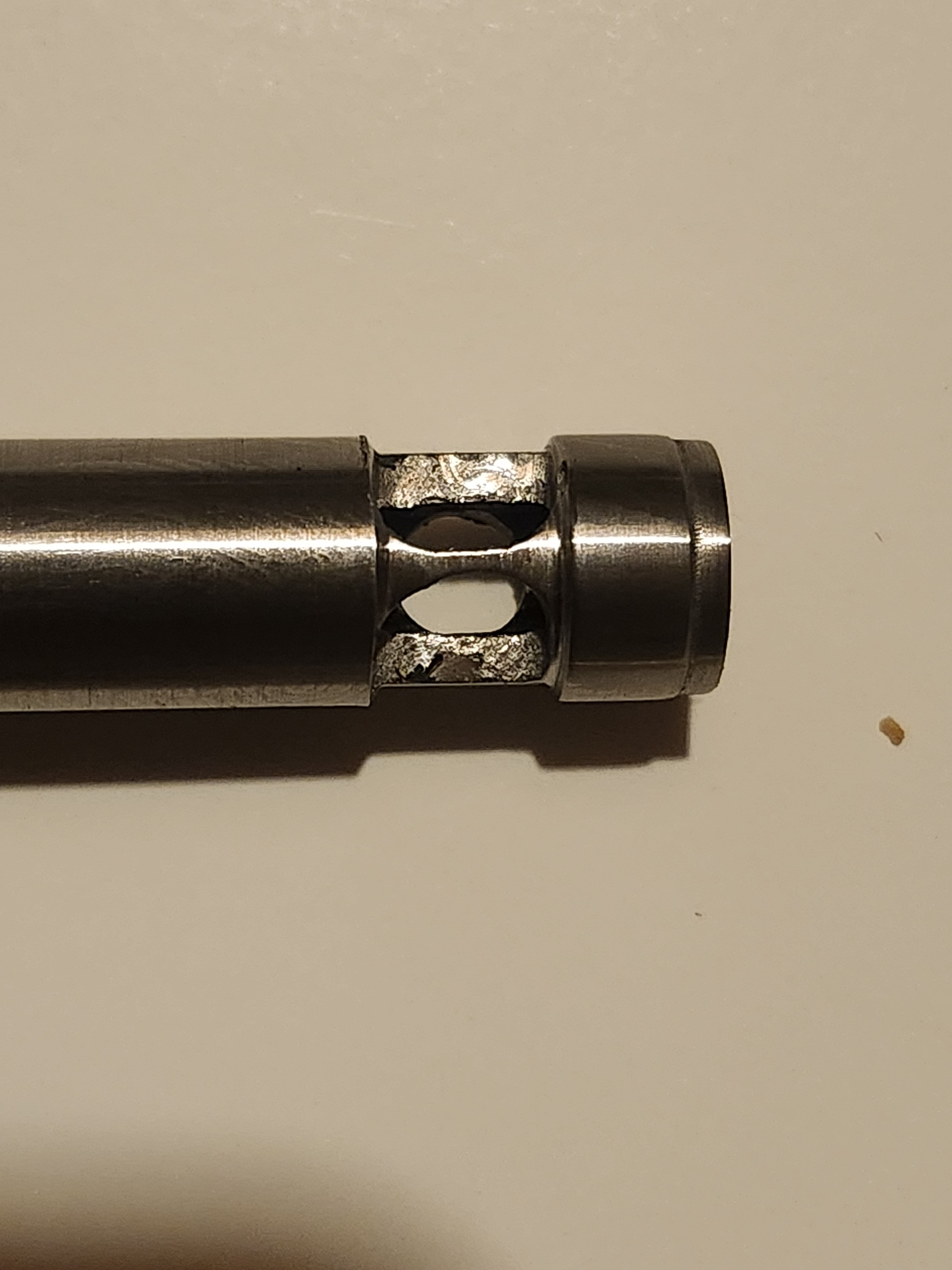

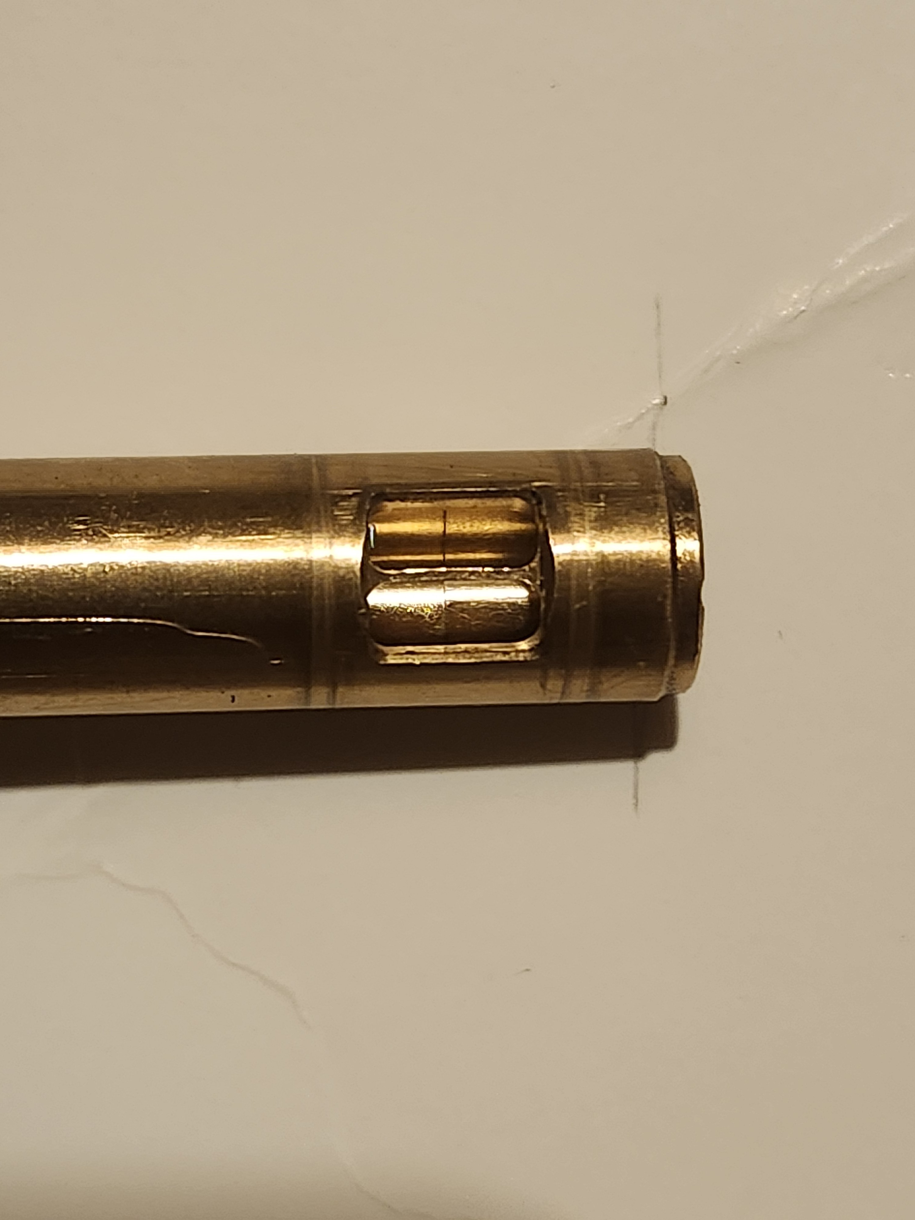

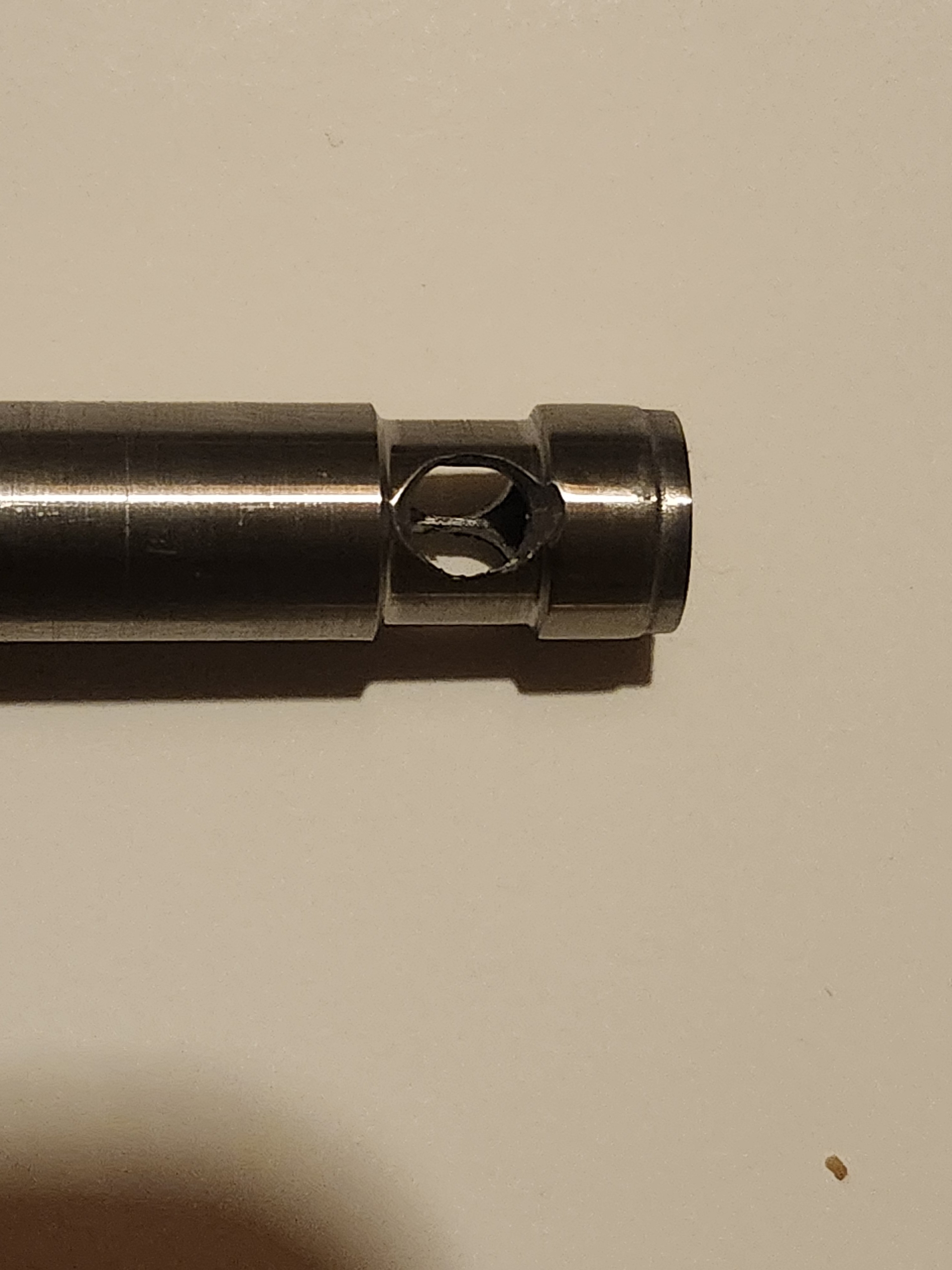

To those who fit their own barrels, what's your preferred way of doing the transfer port. I've drilled many but seems as I play more with slugs this is what I want to try. It seems the easiest for me with a very small manual milling machine. It will take a little longer for me to clean the lead-in to prevent shaving of the slug during loading but it seems to maximize the airflow regardless of the valve to barrel port size. I'm always open to better ways and this way may even help someone else so hopefully it's a win-win. Definitely need to give the credit to RTI which is where I got the idea from.
That is the style I mostly use. Fwiw, you can cut the thin web piece in a triangle shape so that the chamber side is wide and the valve/tp side is sharp. This takes a little extra on the machine setup (x2) or you can just cut the web wide and dremel the presenting edge. Not really necessary unless you are wanting to get every little bit possible.

I do like the design of the one bigHUN posted..
this allows more air to come in around all sides and less areas where pellets can be shaved off.. I have read about guys enlarging the round transfer port to a oval and as large as possible without the pellet dropping down into the transfer port.. while it makes for better air flow you have more chance of damage to the pellets..

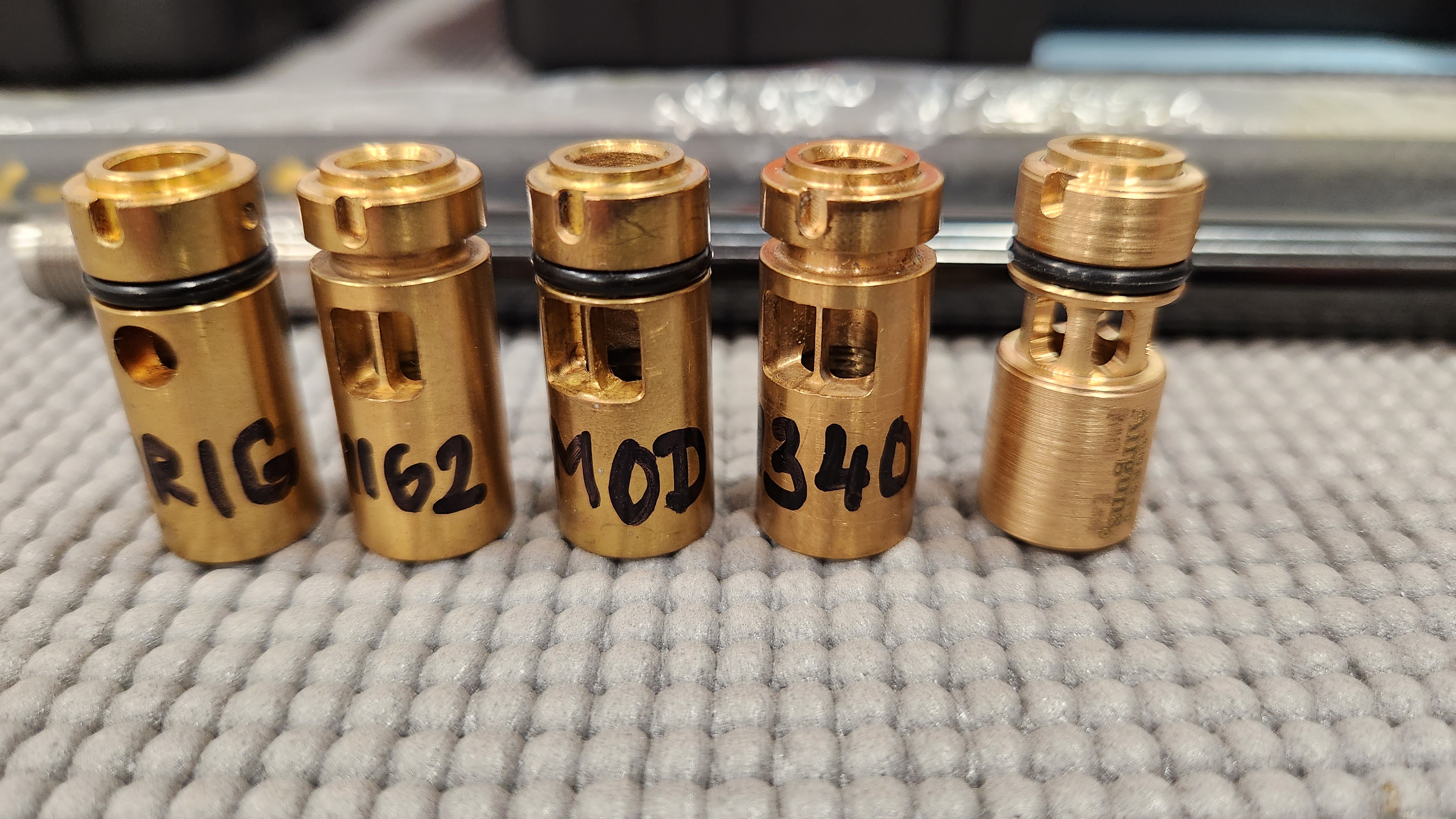

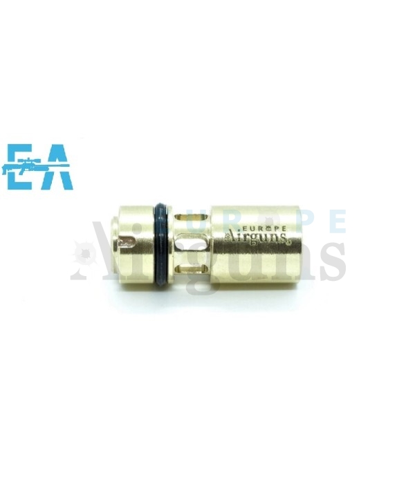

I really like the looks of the FX one with multiple ports and the turned down area for the air to get around, but I don't have any experience with it to know if it is better.

I felt that port was a contributing factor to the numbers my RTI puts out. I wish a had the round port CZ from my last RTI to slide in my gun to see just how much the port on the RPB is responsible for. Would also have to take the the lighter choke into consideration.
sounds like the port was a separate part from the barrel, that would make it easier to have different ports, plus easy to try different barrels.

No, it’s part of the barrel. If you choose to duplicate when building a blank, it’s a commitment. No FX screw on stuff here.

bigHUNS gadget is definitely a screw on FX item. The port thammer and I are discussing is a machined into the barrel port.
