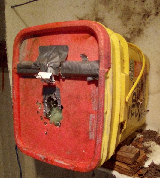

Well nothing fancy but a bucket trap i got in the shop barn at 10m for pistol work. The bottom i got folded old jeans as last thick pellet stopping and the rest is filled with fiber like pillow stuffing . Layed on its side and duct taped a clip to hold a card target. I could of used screws but ...lol duct tape gives everything i touch of class, right?

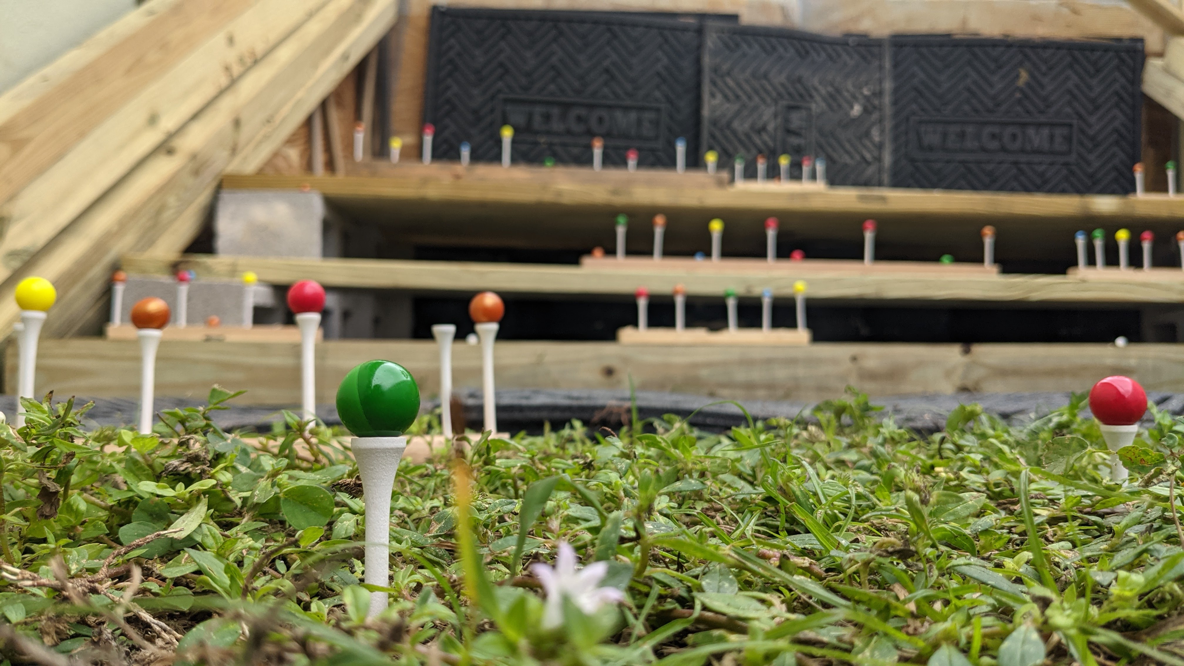

I built one that will stop a bulldozer damn near, so that there's zero question of it stopping anything I'll shoot at it (because there's a public road right behind it, I've got lots of layers between me and that road in all spots.
I also have decked it out with toys, like paintballs, golf tees and sand to put stuff in to shoot, as well as target hangers. All padded up with rubber, either sand filled kart tires, or rubber welcome mats, just to keep things hushed down.
