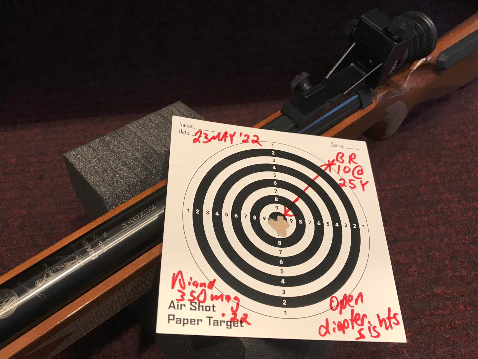

works fine letting the tripod handle the "artillery hold" for me.

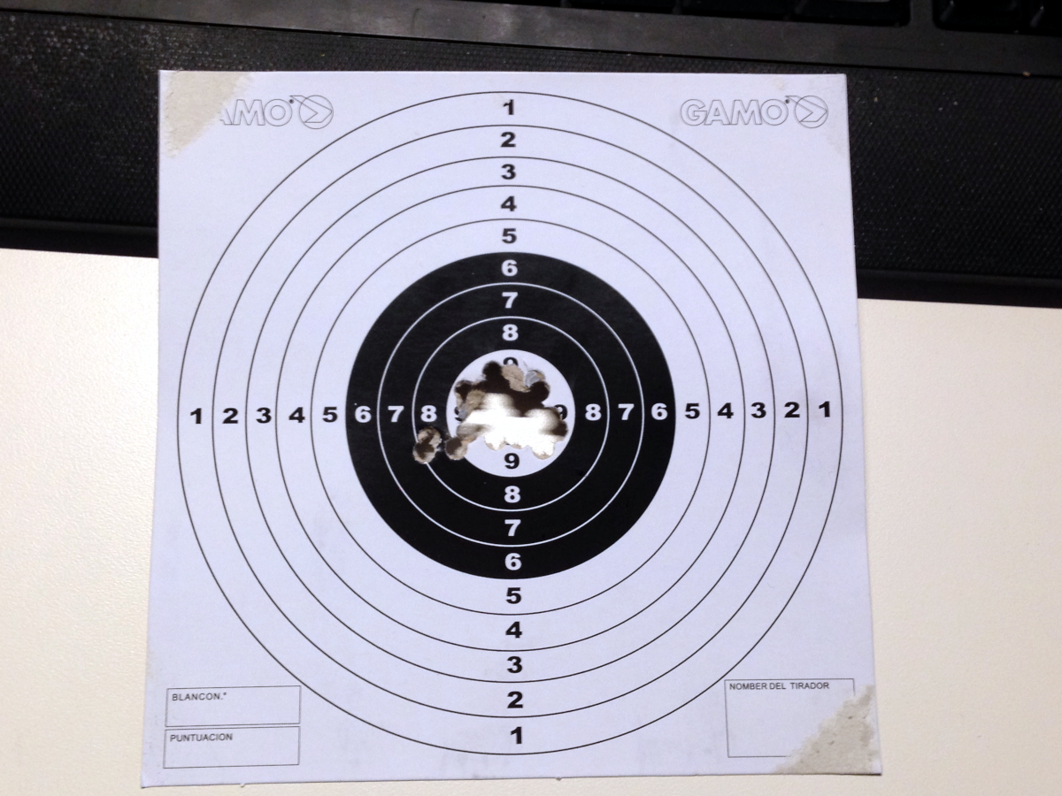

on a synth stock, i'll even add a bipod on occasion.
either are a lot easier than carrying sandbags around. and seems just as accurate.

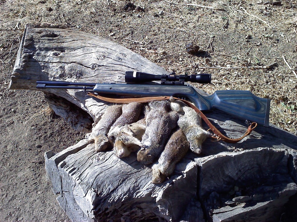

just my 3-cents worth. your results may vary. :)
