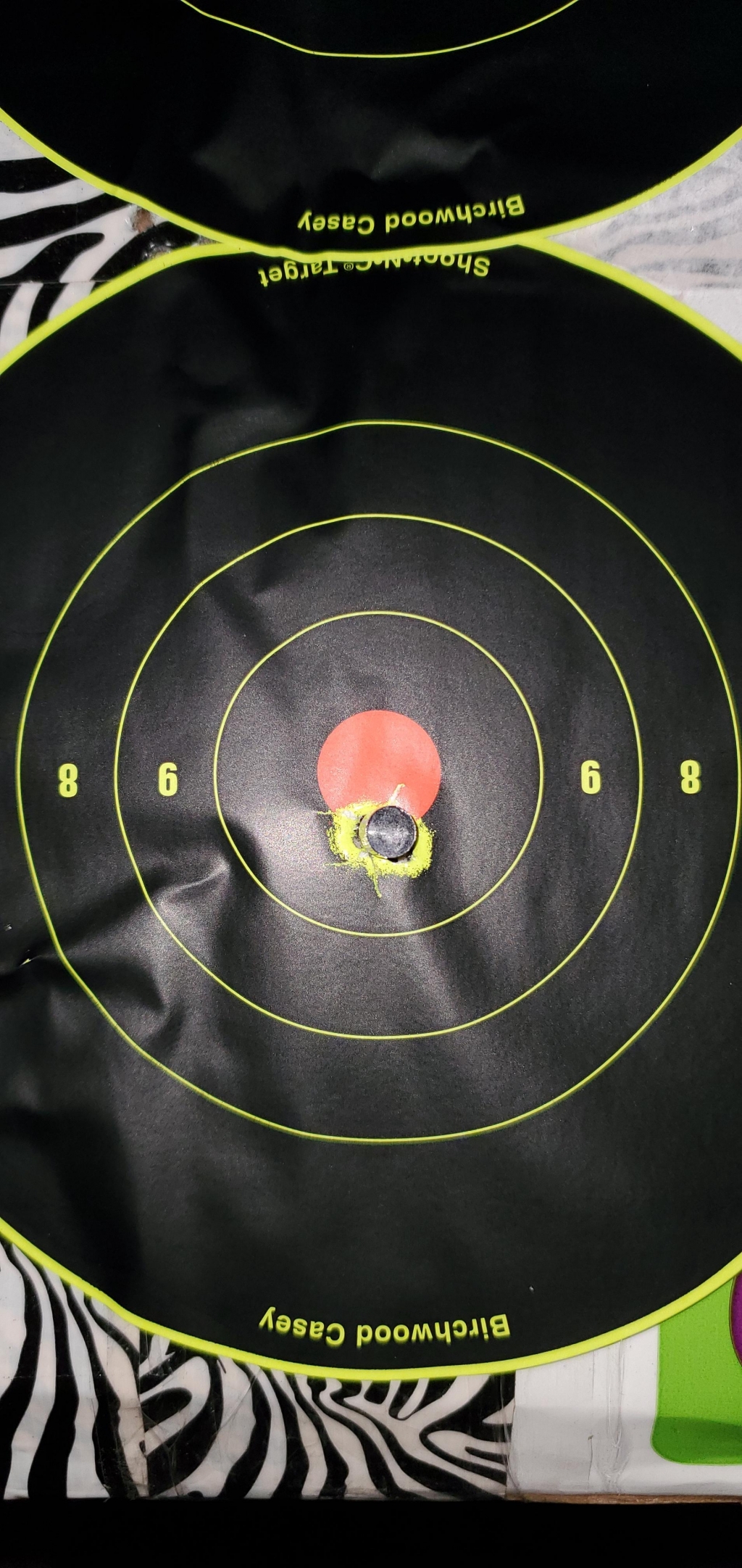

I'm shooting @D-Rigs 34g Varmit knockers slugs out of my .25 Taipan veteran long at 872 fps and got a 10 shot hole & hole at 50 yards....unfortunately I have gotten the chance to shoot them at 100 plus yards but I'm sure they would group very well...
