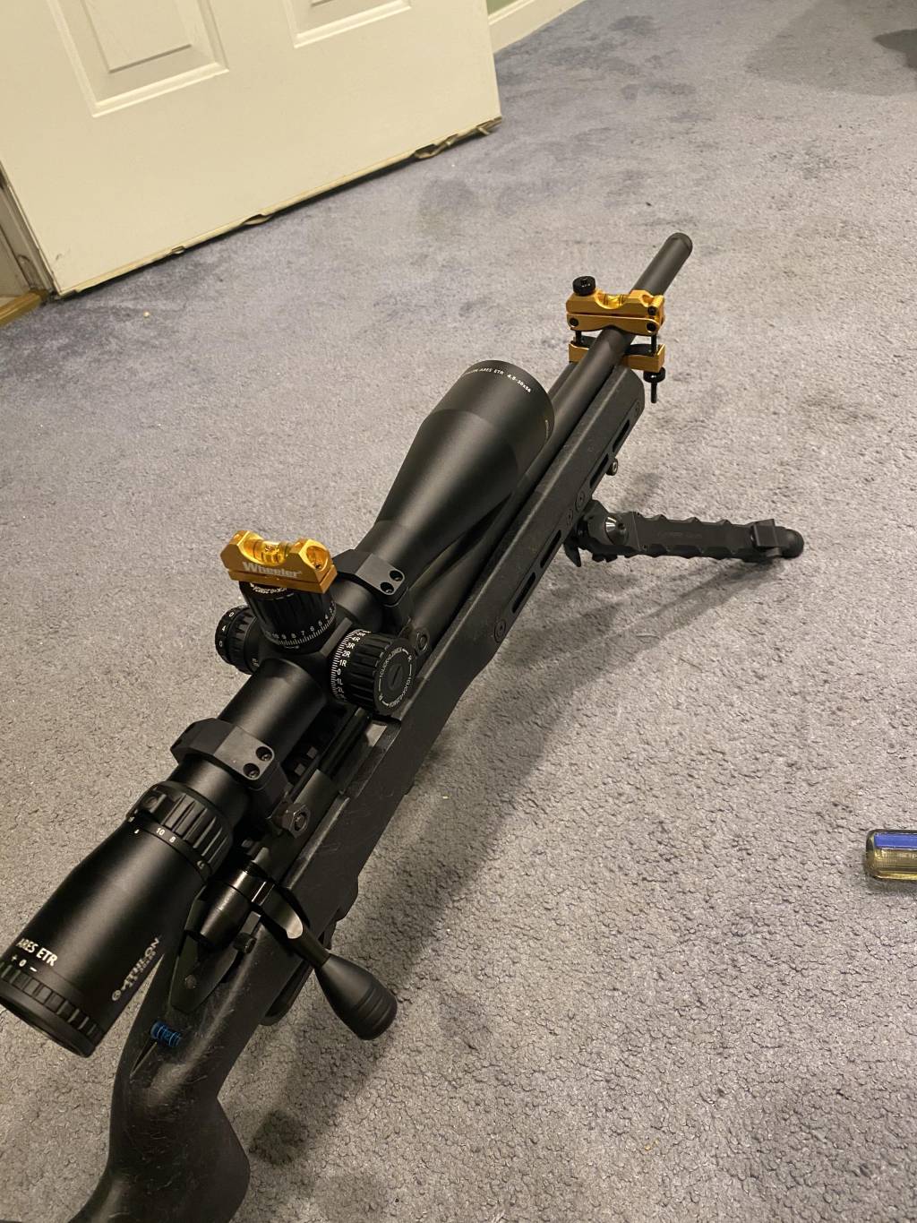

The best I could confirm my method of leveling the scope and then setting my can’t via a plumb Bob afterwards, is I drew up a grid on a piece of cardboard, with exact measurements that would match the MOA distance marks on my SFP delta Stryker at 40 power.
I shot up and down the vertical lines at 50 yards, and if I didn’t start to stray outwards at an angle Everytime I clicked up, or downwards and at an angle when I clicked down, then I knew I was good.
I also make it a habit at whatever distance I’m shooting at, to hang a 1/4” thick black string with a heavy fishing torpedo weight so at anytime I can check yo make sure my cant is good-

An easier? way to setup the mirror is to use a 6"x8" mirror hooked to a flexible goose neck on a table level with the gun 10-30 ft away. Now take your laser pointer and mount it to the barrel, a bit of foam and rubber bands makes it easy. It needs to be parallel to the barrel.
Turn it on and point the gun at the mirror being very careful not get the reflection in your or helpers eyes! Without looking at the laser walk to the back of the mirror and adjust to get the reflected beem aligned with the scope. Lens cap on so you don't get another reflection back at you. If you want to get fancy hang a string in front of the mirror and move it left or right into the laser beam.
Back at the gun Turn off the pointer remove the scope cap and you should find that you can see the scope and barrel through the scope. You may need to make SMALL adjustments to the gun position to get the setup correct. Usually you will need to move the entire gun and not just pivot. The string should cross the center of the barrel and scope. Put a flashlight on the gun table and point it at the muzzle to make it easier to see. Now twist the scope so the vertical matches the string bisecting the muzzle and scope.
