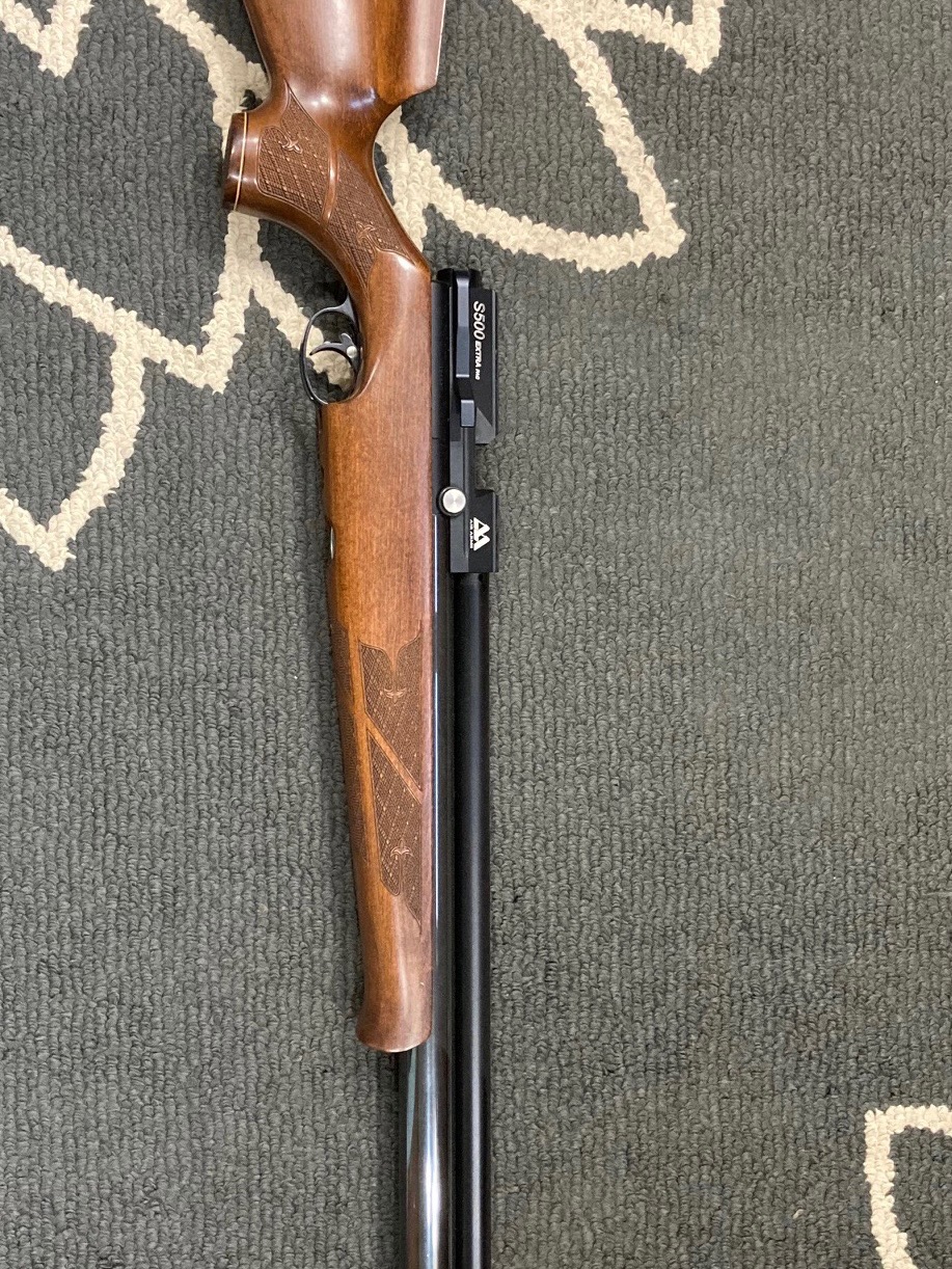

I just took possession of an Air Arms s500 Extra FAC as my first pcp, literally an hour ago.
A hand pump arrived yesterday.
I chose a 22 as this will be used for target and pest sniping. It’s a single shot, but that’s fine with me and consistent with all my other air guns.
I wanted to avoid the price point guns and found this used for $500.
