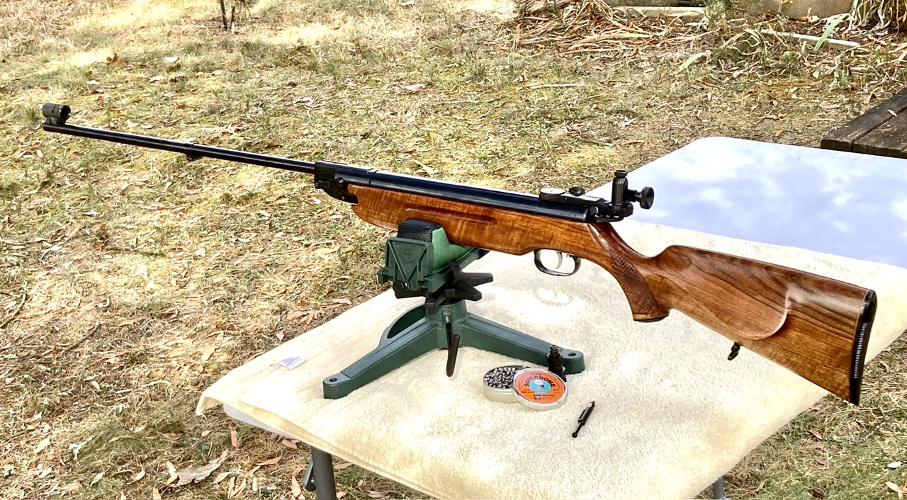

In all seriousness, if you are seriously considering the HW 35, read this post. It's the most thoughtful description of this iconic air rifle's pluses and minuses I've ever seen.
The darn 35 is eternal (this one is from 1966)...and has always been pretty, to my eye anyhow.
