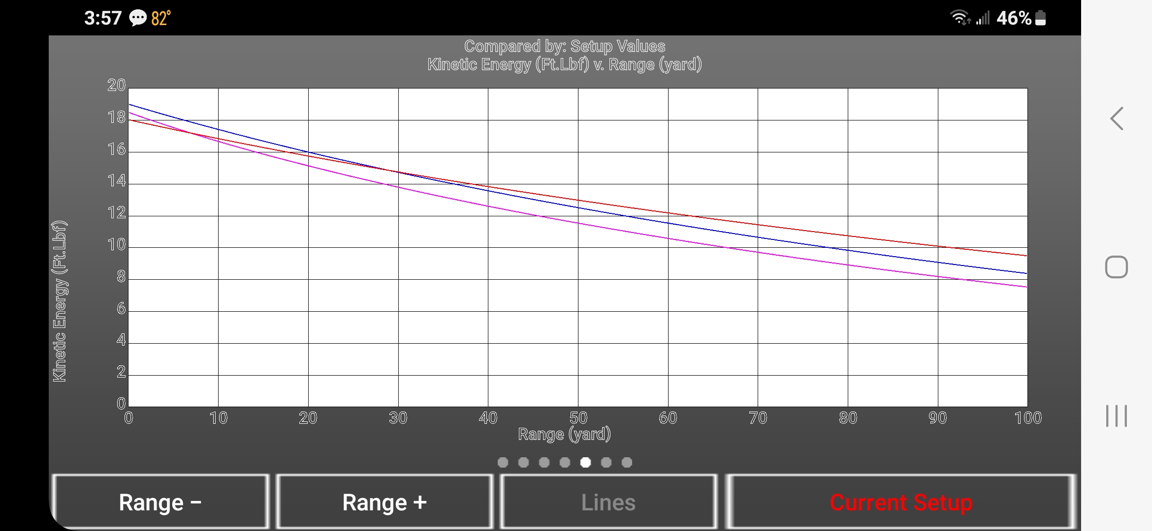

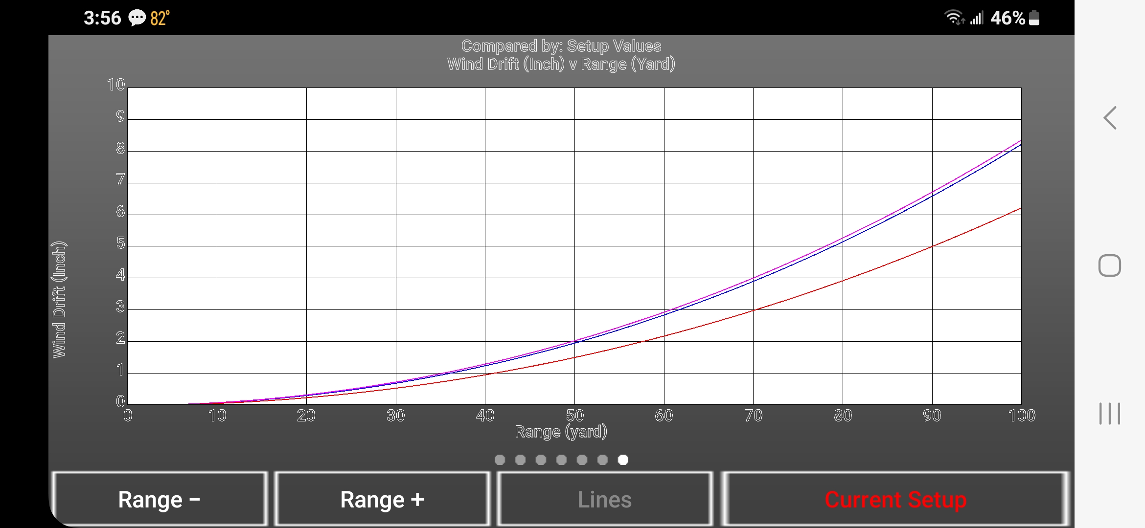

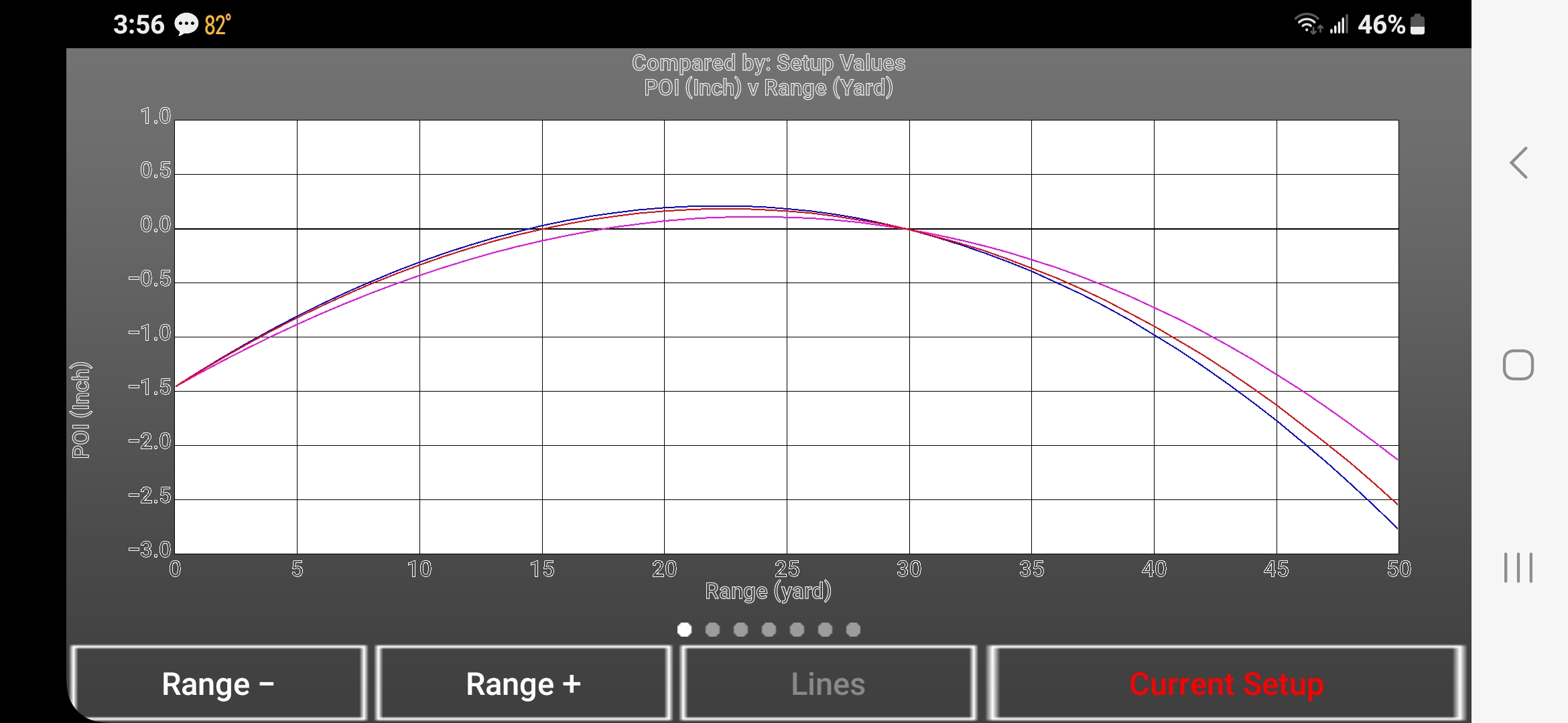

With double chronograph testing at 47 yards with my 20 cal R1.
20 JSB 13.73 = 0.0373
20 H&N 11.42= 0.0274
I haven't verified chair guns numbers
But
22 FTTs 14.66 = 0.029
At least my R1 makes about a pound more energy in 22 than 20 with the JSBs with a better BC. The R1 makes a half pound more energy with 22 FTTs than the 20 cal FTTs but has a better BC.
Honestly the difference between 20 and 22 is splitting hairs. At least with springers where 22 is typically more efficient than 20 cal.
Purple 20 caliber 11.42 FTTs
Red 20 caliber 13.73 JSB Exacts
Blue 22 caliber 14.66 FTTs
The better BC of the JSB comes back at longer ranges. It retains more energy and has less wind drift.

With all due respect. No pellet I know has a BC of 0.050. Unless I don't understand your post applying the same BC to all calibers skews the results.
But
This is a complicated subject

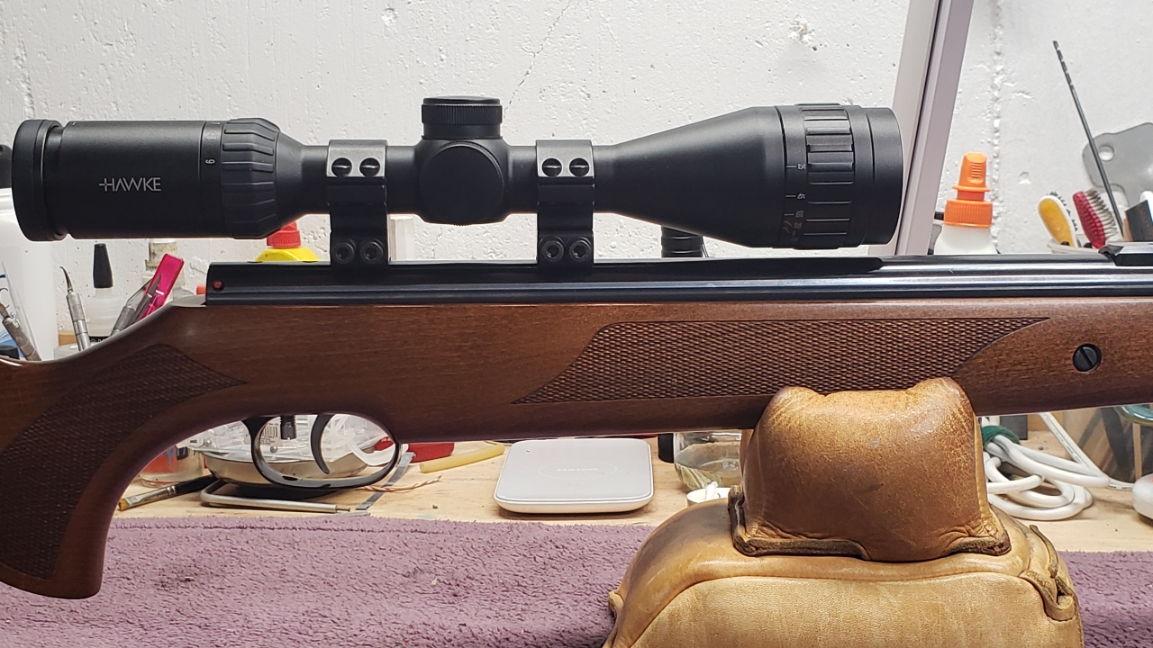

Here's a better view of another Airmax mounted in T04C rings
Ditto, Hawke Airmax 3-9 x 40 mm AO with Sportsmatch T04C medium rings.
Hawke Airmax 4-16 x 44 mm SF, IR compact with Hawke Tactical 2 piece medium rings on my HW95L.

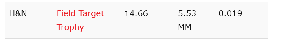

H&N FTT 14.66 gr 5.53 mm BC number.
https://hardairmagazine.com/ballistic-coefficients/
