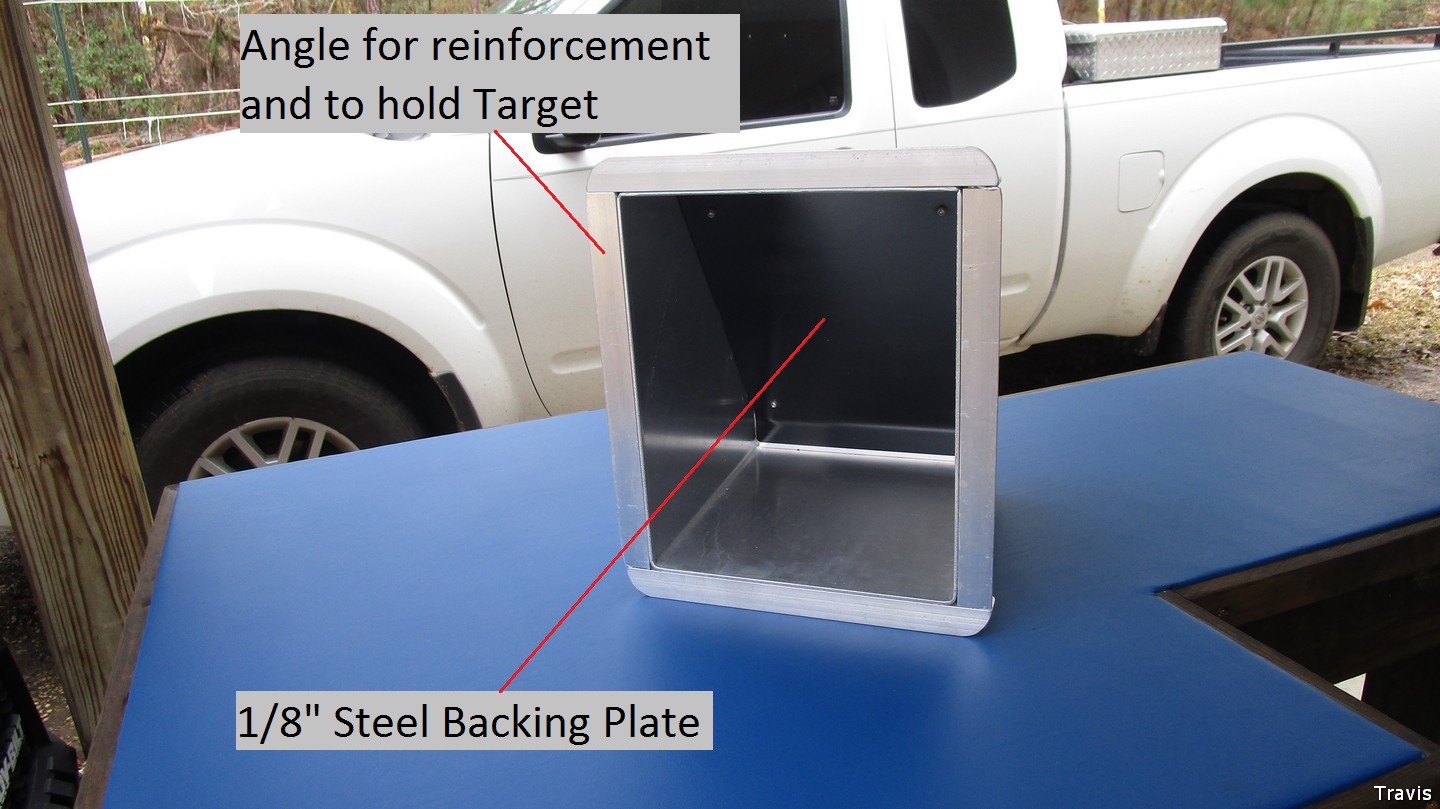

I wanted a really good Pellet Trap that I could use both indoors and outdoors and one that would last for a long time. I could not find anything that I liked so I designed one from scratch, what I call the Big Bang Pellet Trap.
I designed it to be made out of aluminum ( except for the interior backing plate ) for two main reasons: 1) It would last forever in any weather conditions and, 2) It cuts the overall weight down for easy handling. The Target Face Opening is framed with aluminum angle for added reinforcement strength and a place to clamp on the cardboard backing material for your paper targets. An additional aluminum angel is added on the bottom at the back to act as a footing so that the Trap can be placed on a level surface. The front and rear angle can also have some holes drilled, for some screws to hold a “block” of wood to mount on a post or pipe.
The “back plate” of the Trap is set at an angle to reduce the impact of the pellet and deflect it downward and creating a “trap” for the spent pellets. The angle also eliminates any splatter from the pellet that would cause damage the backside of the paper target.
I added a 11-gauge ( 1/8" ) thick mild steel interior “backing plate” to enhance the strength so as to eliminate damage caused by a pellet. I have spent many weeks testing this Pellet Trap from 10-meters out to 50-yards and as a result I have determined that it can be safely shot with no damage under the following conditions:

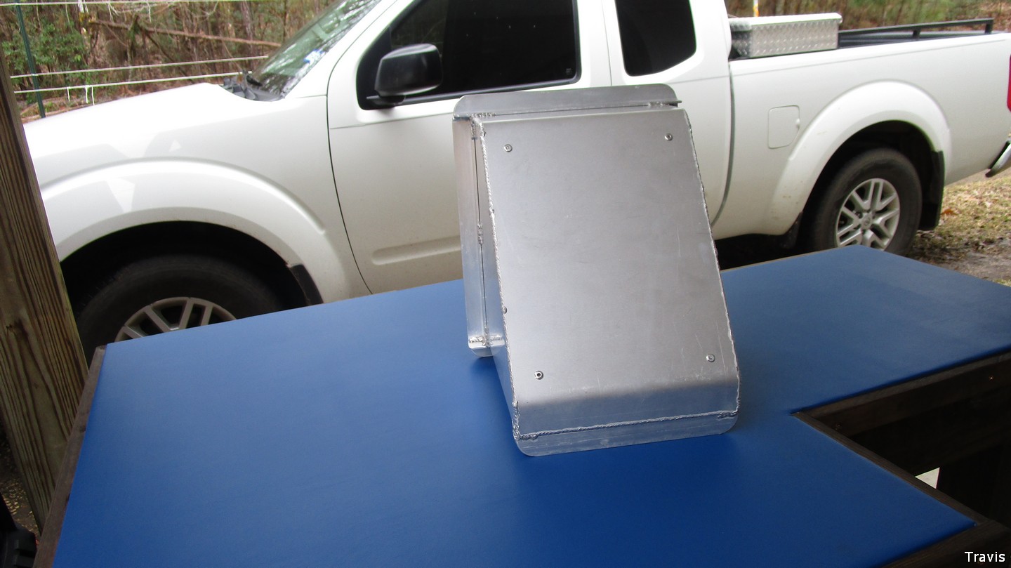

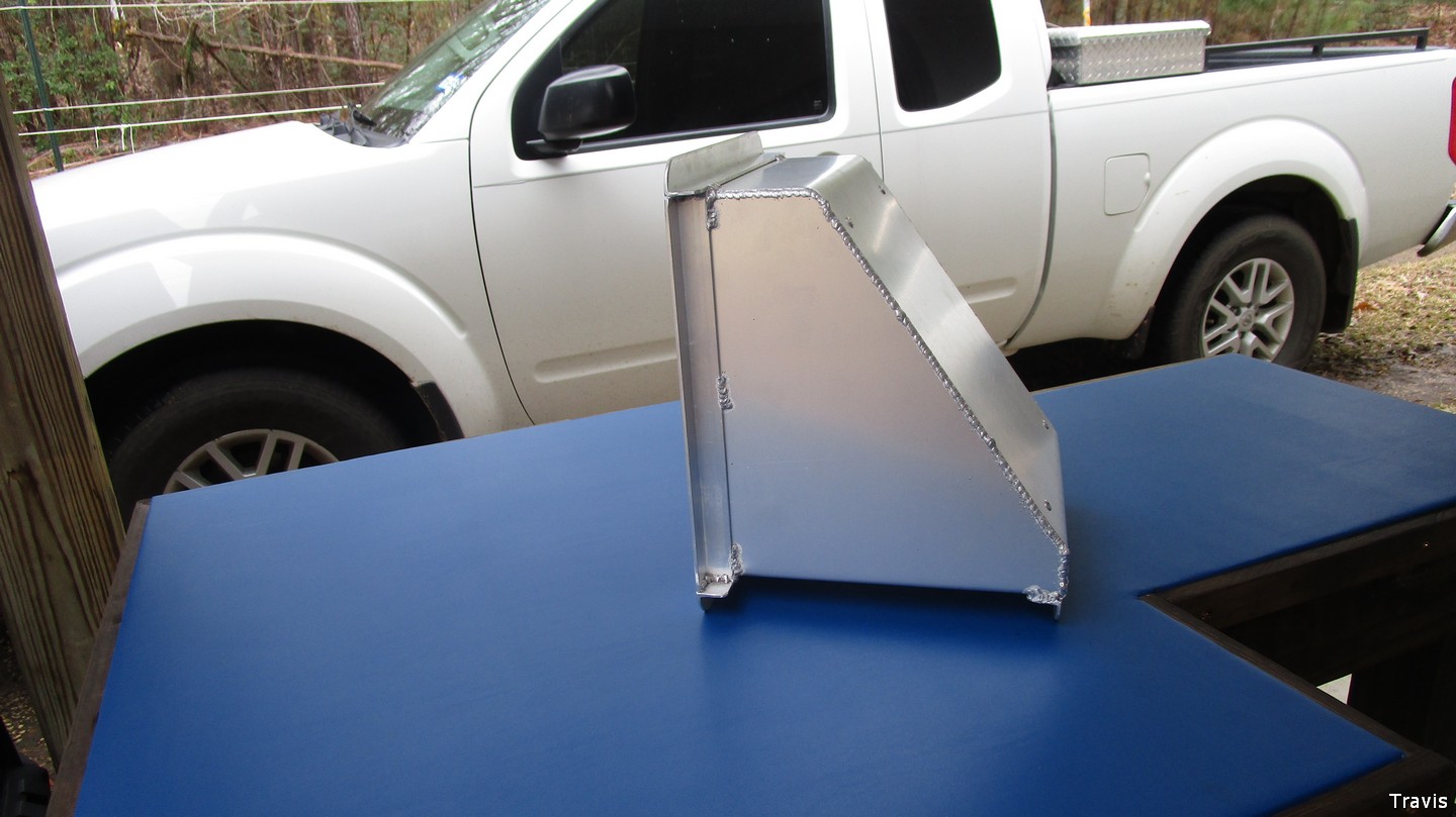

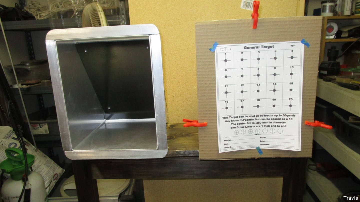

I have a good friend who owns a welding fabrication shop and asked him to build two of these Traps for me and here are a couple of photos. They work great and are so easy to set up, change targets, change target backing material, move to different locations and easy to store. All of the spent pellets and target paper and cardboard backing material that has been shot winds up inside for a no mess and easy clean up.

Hello @rc4fun
You cannot hear the pellet hit the backing plate. As soon as the gun goes off you hear that report and the pellet hits the Trap at the same time. The sound of the pellet makes so much less noise that the gun report cancels out the pellet sound. Look at where I am shooting indoors at my small shop and I do not hear the pellet. As I had stated earlier, the aluminum absorbs most of the sound and I am shooting at 15-feet.

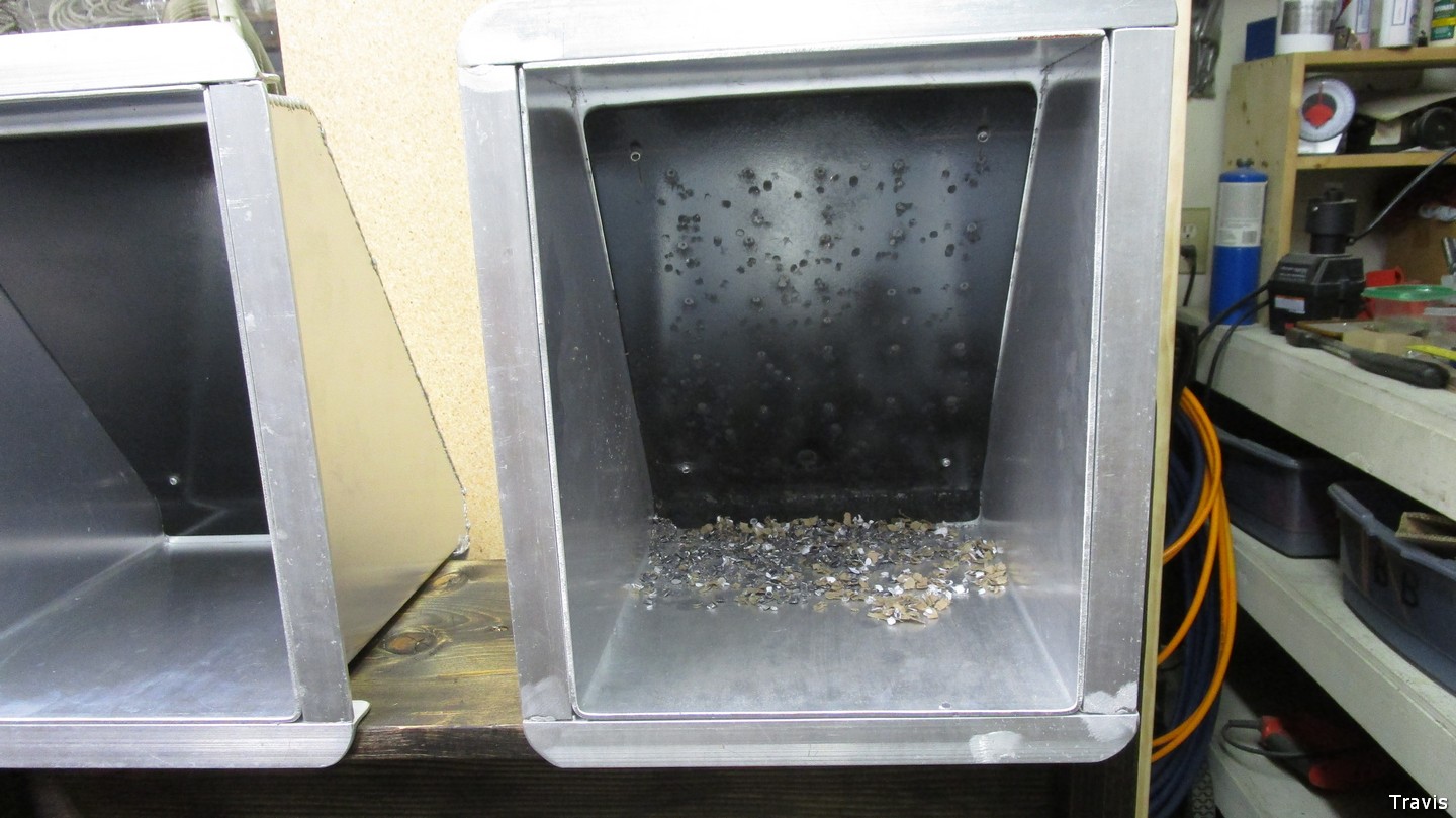

Do you put anything in the bottom of the trap?
Hello @Martin3528
No sir just the aluminum bottom. Look at my first post and you will see one photo taken of the inside with a whole bunch of spent pellets and the small bit of trash ( cardboard backing and target paper bits ) that have collected. If you save the lead this makes it so easy to collect the pellets and discard the trash, or you can simply dump everything. Here is that photo.
ThomasT

Hello @Martin3528
ThomasT
I did see that, was just surprised they did not fly back out.
Reactions: ThomasT

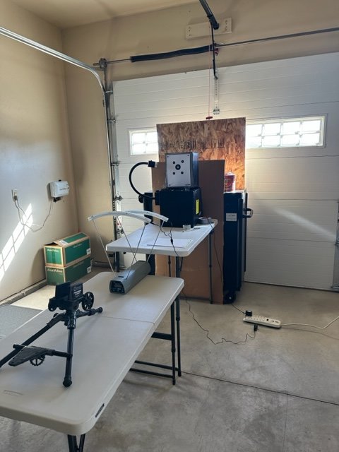

I have an insanely heavy duty trap that will even stop a .223 powder burner round (the black box with the yellow sticker in the pic), but it is very heavy (like 60 pounds). I am old and weak. I've been using a box stuffed with old blue jeans (the box with the target on it in the pic), but it is hard to clean. I will PM my phone number to you, because I don't do Facebook.
I've got one that stops most anything, weights a ton, well 2 tons. Packed it full of rubber mulch and some carpet. Wish I'd know about these 6 months ago..
Hello @Martin3528
The angle on the back reduces the impact of the pellet so much that last bit of motion is diverted straight down. I have now shot way over 600 pellets and not one has hit or damaged any of my Targets.
